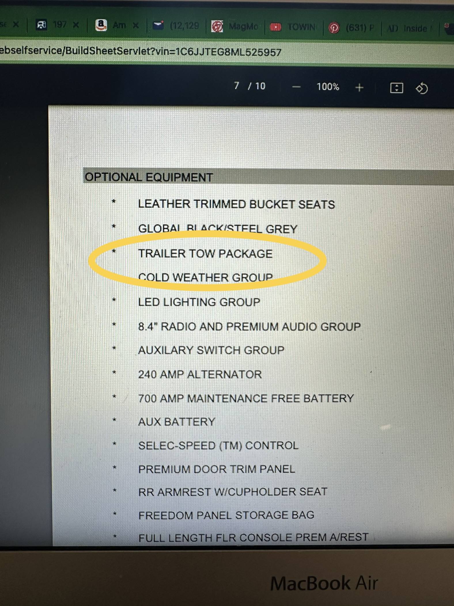

Having a factory hitch receiver probably indicates it has the tow package. Did you buy it used? If so then maybe the previous owner installed one after purchasing it?
Here is a jeep link that can pull up your Gladiator's optional equipment listing to confirm that you have the entire tow package or not: https://www.jeep.com/webselfservice/BuildSheetServlet?vin=
Just add your VIN after the "=" sign. It worked for my Jeep.
Also, get a weight distribution hitch. The owners manual says you should use one for trailers over ~1500lbs, if I remember correctly. You will not regret it. I have a Curt brake controller too and they work great.
Great call on the VIN lookup! The camper comes with anti sway bars. Is that different than a weight distribution hitch?
