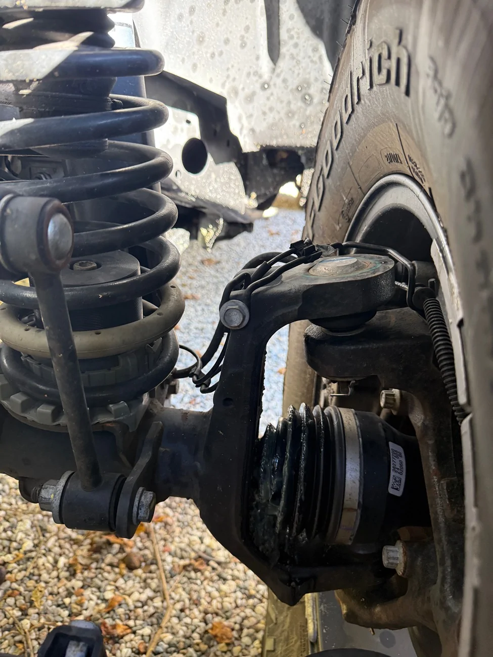

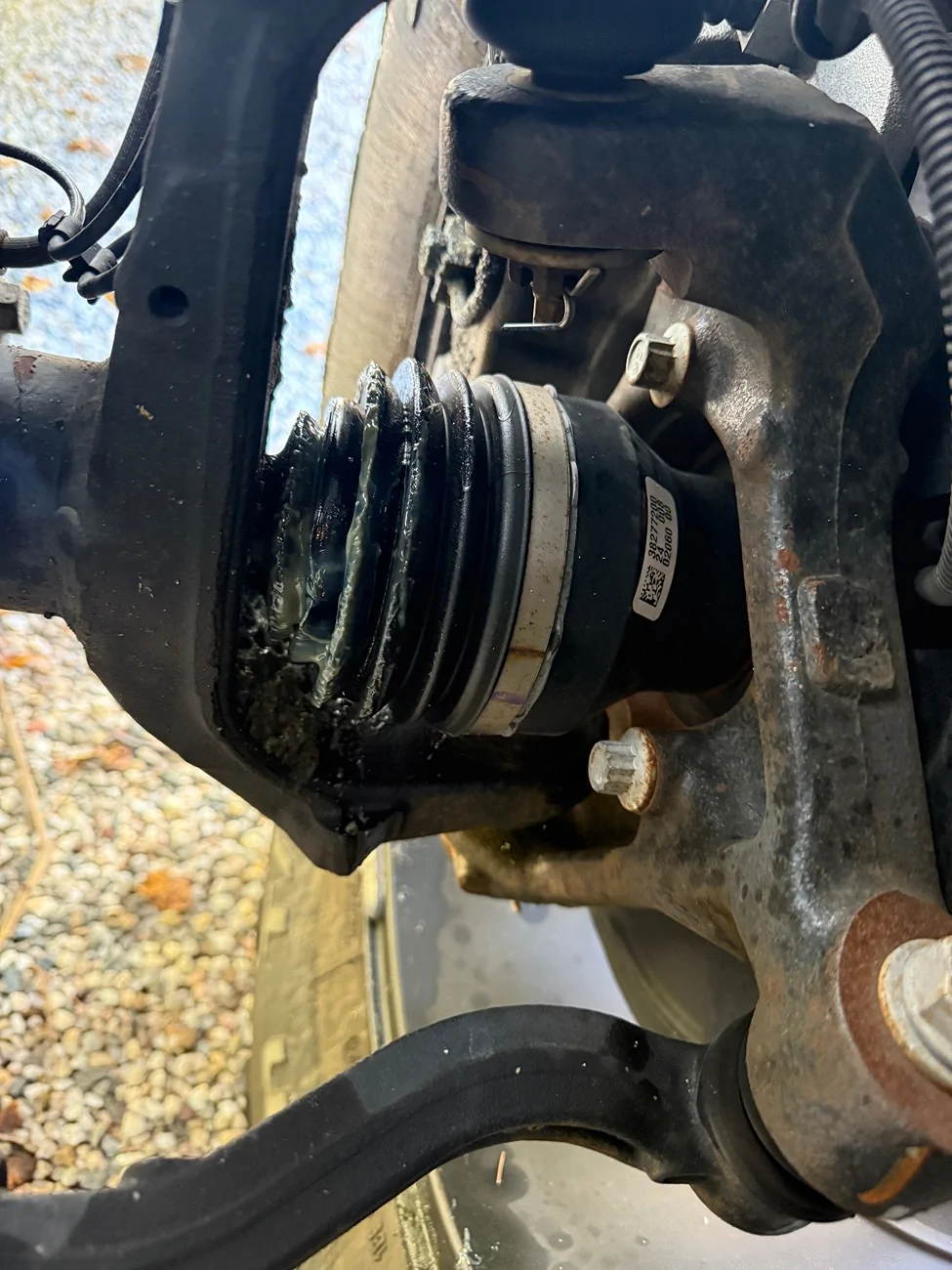

Walked outside to my 2024 Gladiator - have 22K miles on it (yes, drive a lot). Is this the CV joint that went? Appreciate anyone's thoughts.
Looks like a trip to the dealership.

Technically it's the boot on your CV joint that's bad, but the joint itself will also fail prematurely due to loss of grease and contaminate ingress if you continue to drive it. Be aware that this may not be covered by warranty if it's deemed the boot was damaged by something.
