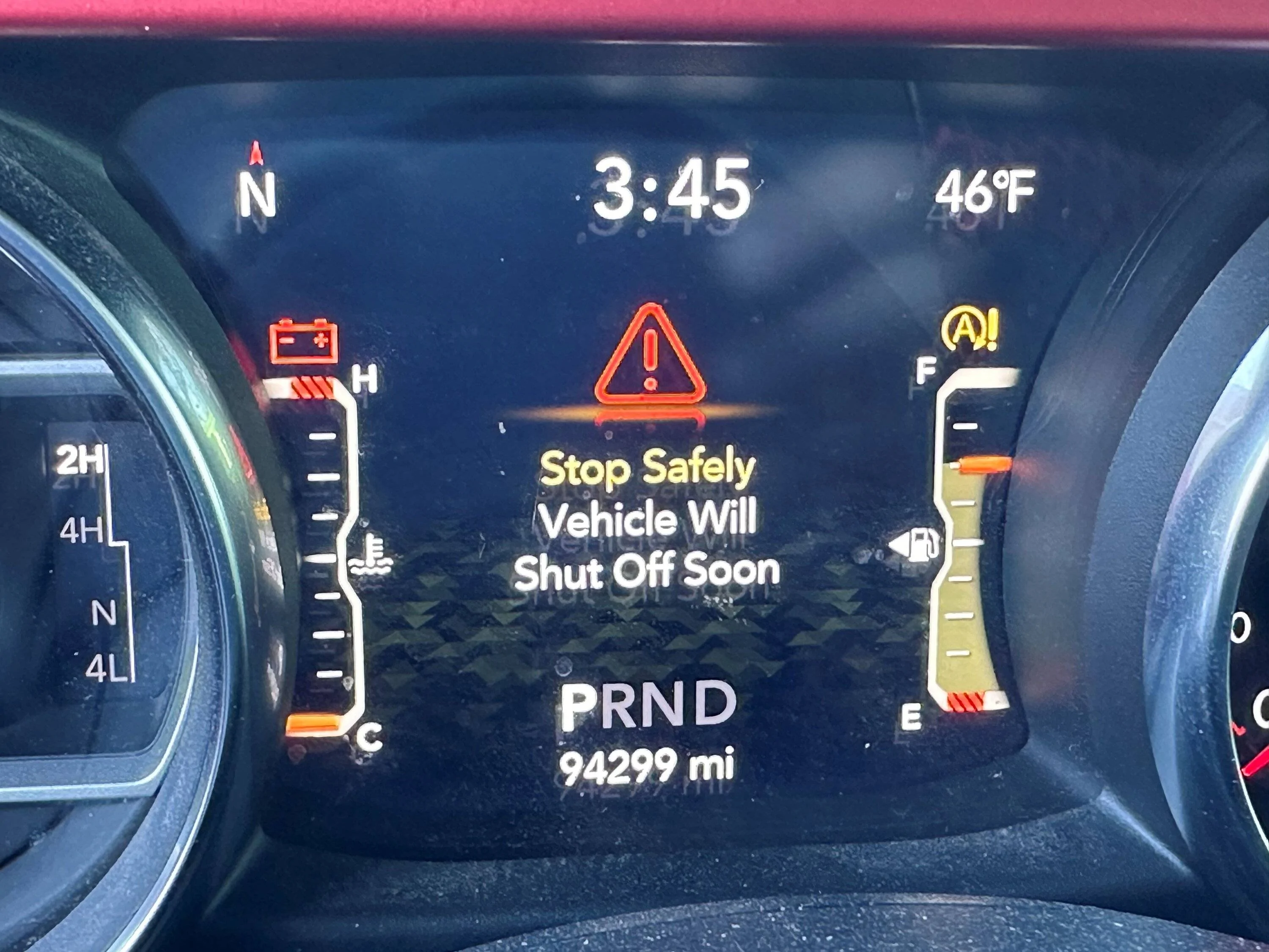

The answer is on your dash - the battery symbol is a charging system issue.

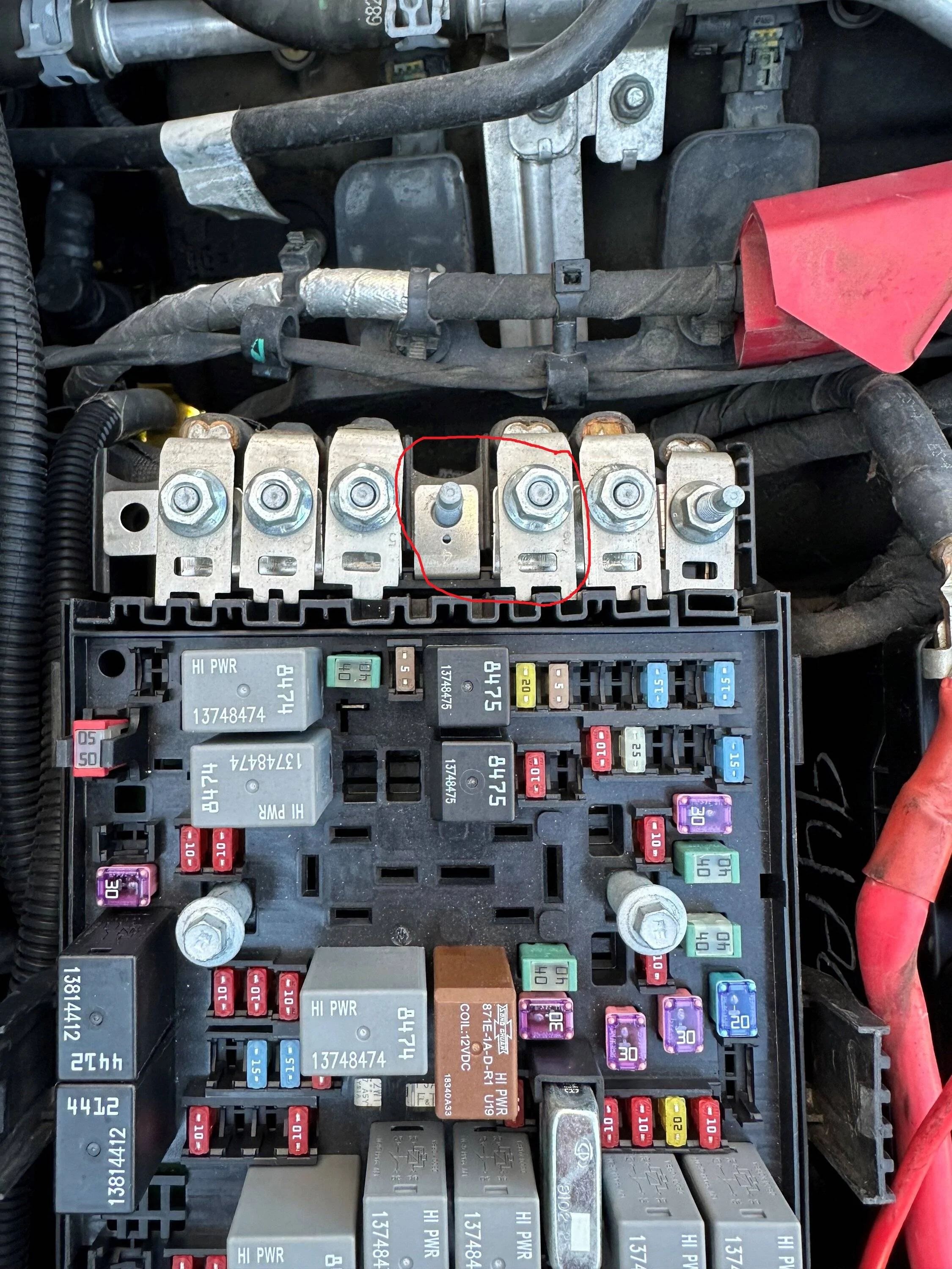

Here's what i see as a chicken/egg thing - the N3 fuse was blown but you may have blown it while changing batteries!
That's about the only time that fuse should blow.

What makes you say the charging system isn't working? 12.8 is normal IF both batteries are fully charged.
I really hope you charged both batteries before installing them - with a good AGM charger. Don't install batteries right off the shelf and expect them to be full or for the alternator to "take care of them".
Charge them first, install them, in this whole process, you should have pulled the IBS off the cables and battery terminal, set it aside for several minutes to reset it, then plug it all back in and put it back in place.

12.8 volts is what you see when everything is working fine, temperatures in the 60s or so, and the batteries are fully charged.

ODD as heck that the N3 would blow without any connection issues like loose battery terminals, or someone working on the truck..................
But it's a common thing when batteries get replaced and the cables touch when/where they should not.
I don't see a battery symbol. I do see the ESS symbol.
