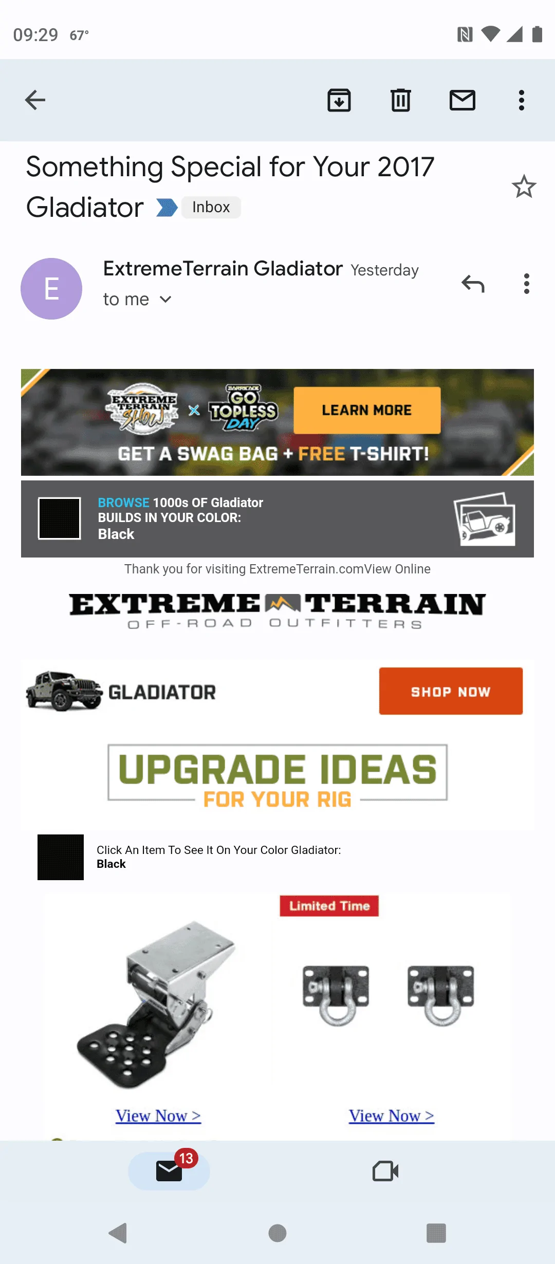

Gotcha. Well, with no animosity toward Extreme Terrain, I received this from them about a year ago in my inbox...
Jeep Gladiator Did I find the perfect Offset for a Mojave? 1709594999012

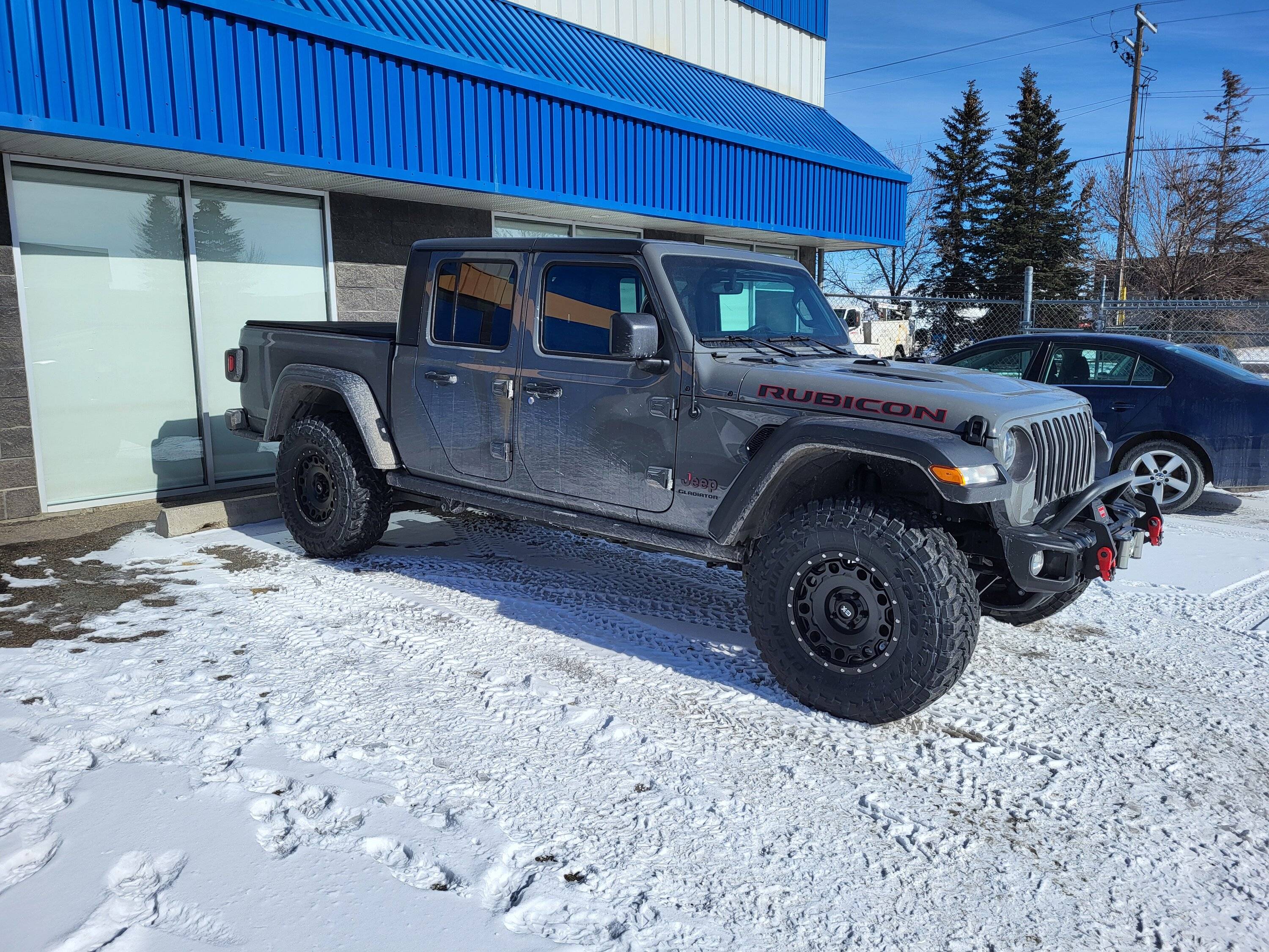

I can send pictures of my set up tomorrow. I went with the same BS but went to a 315 tire from the stock 33". I have a Rubicon but the Mojave is the same axel and fender. I went with a 17x8.5 rim and a 34 offset which is equal to 6" BS from factory.

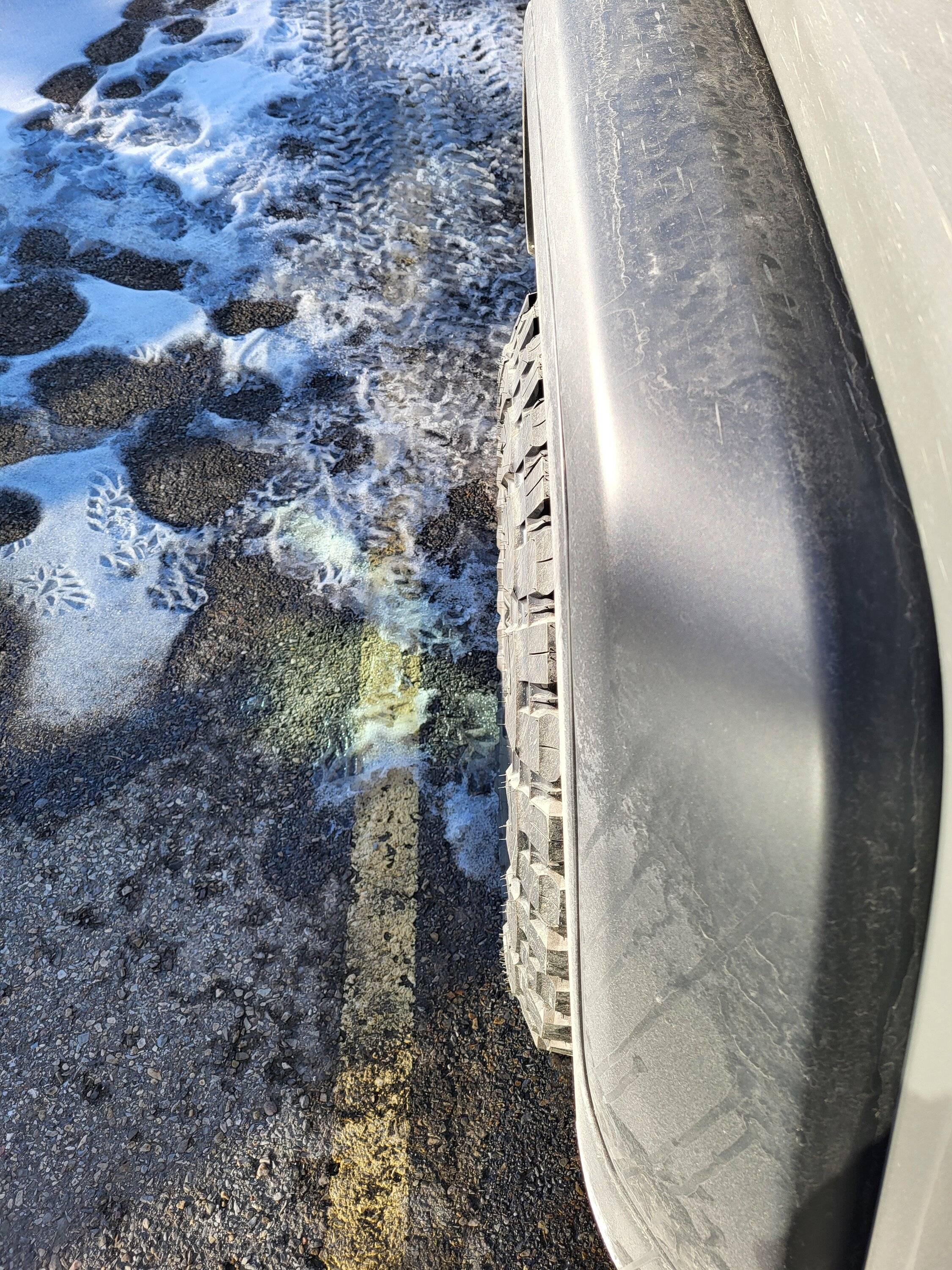

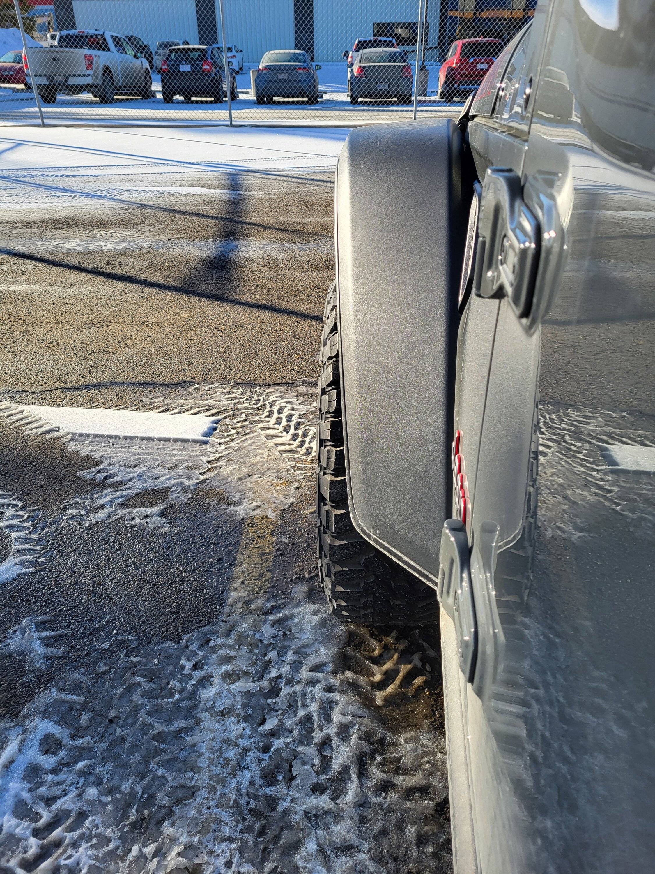

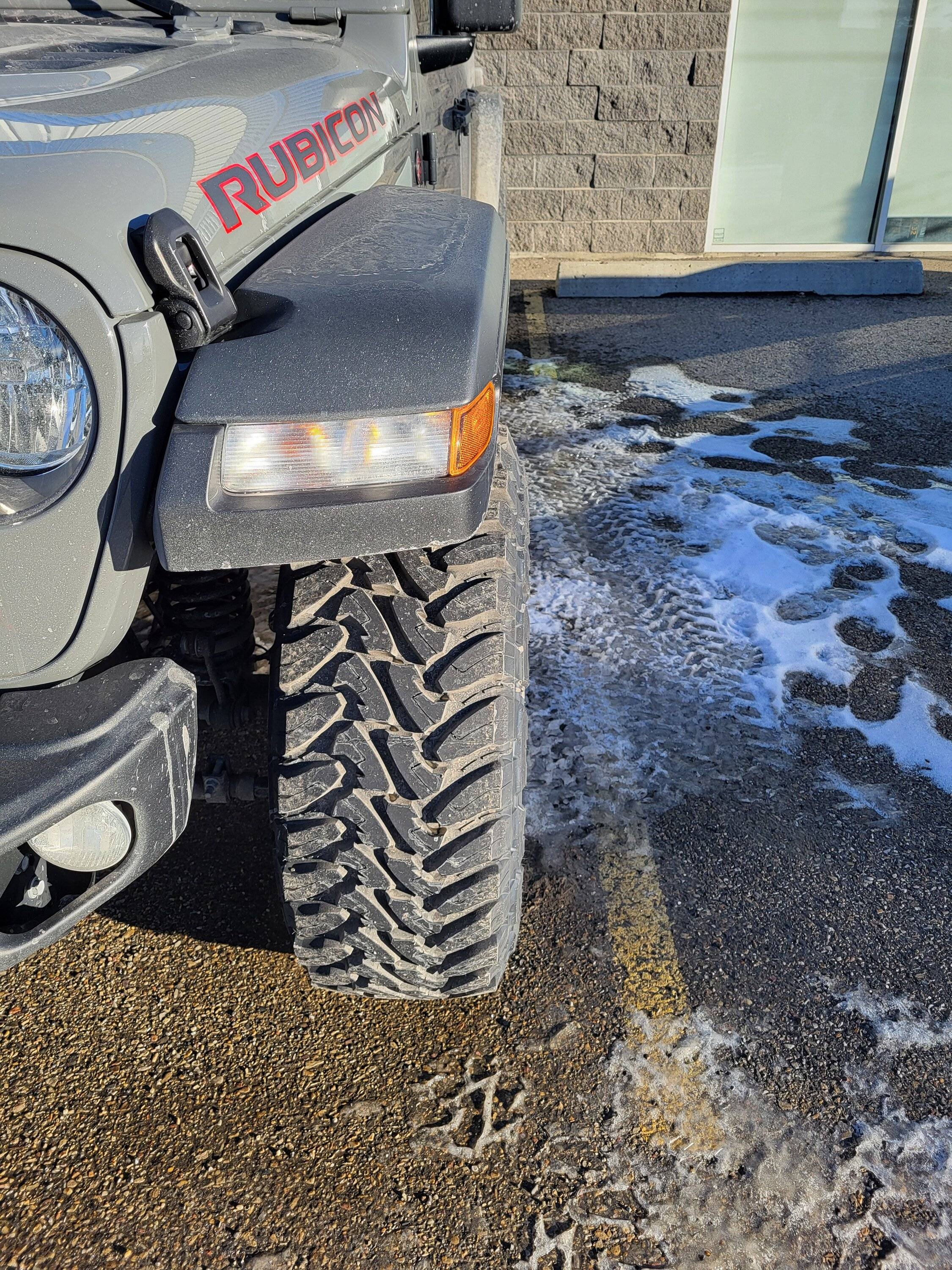

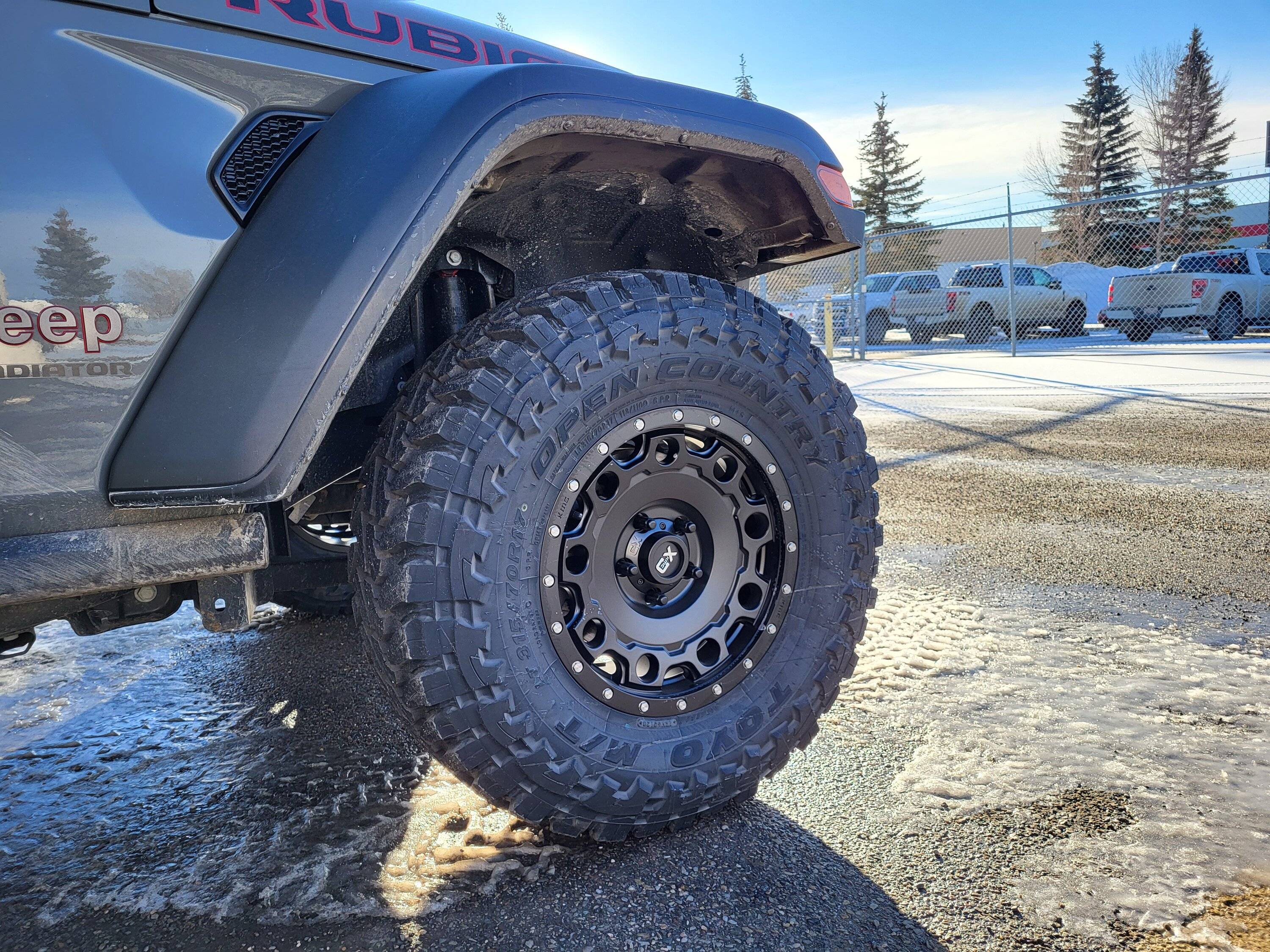

This is with a 17x8.5 rim ET34 which equals a 6" Back Space, which is what the Rubicon comes stock (17x7.5 ET44.5). Mounted with Toyo OC/MT 315/70R17. They measure 34.4" high and 12.8" wide (Actual) and only the side wall pokes out. One note here is that I have a 1.5" TeraFlex spacer in the front to level and compensate for the winch. You may have a rub with a stock bumper requiring to either trim out the back or go with a stubby. I have no issues with this set up and have flexed pretty hard with no rubbing or clearance issues. If you think there is to much poke you can go down to a 11.5" wide in either 35" or 37". They even make a 10.5" in Nitto I believe.
