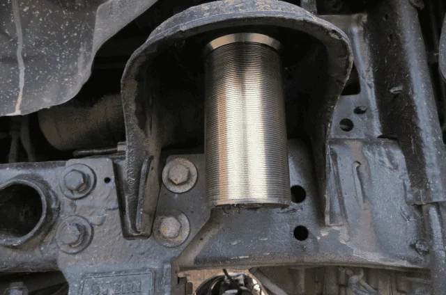

I did the JKS hydro bumps with the adjustable spring seat. These add 2" of lift by themselves. In the picture you can see where I cut. Just above the weld. I bet Fox/King want you to cut in the same spot.
How was clearance on axle- pan etc after cutting? It’s raining and pretty crappy this weekend- was hoping to catch a break and pull the springs to see how much clearance is going to be needed….. seems like the were very conservative with minimizing the up travel on the diesel…..

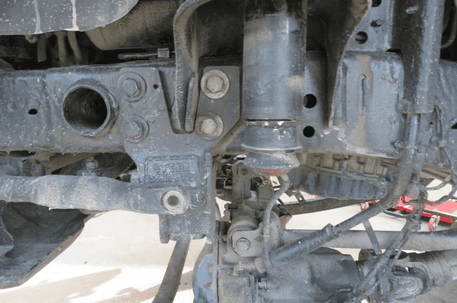

I'm using a 2" bump stop on the axle with 4" of lift. That keeps the 37" tire from rubbing the fender.
I figured what I cut off in length of the tube was replaced with the bump stop and maybe a little more.

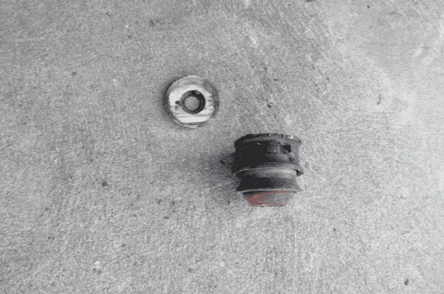

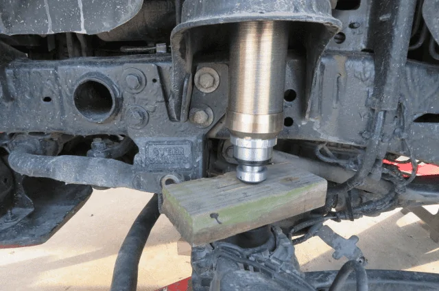

The sleeve is about 1/32" longer than the cut tube.
