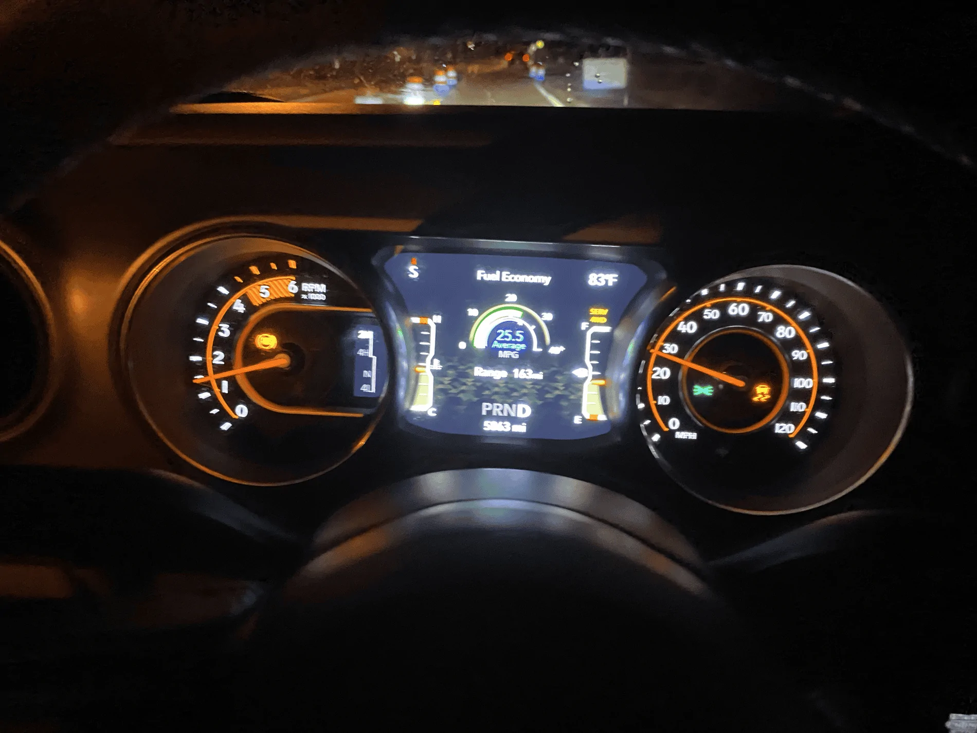

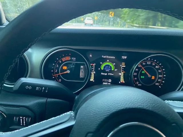

Did anyone find a good solution to this problem. I have the same thing as the dash pictures above, ABS, traction control, and Serv 4WD drive lights are all on. Can get the Jeep in 4WD but unable to get cruise control to work. It is no longer intermittent but are now on permanently. So many ideas on this thread as to what the problem might be I am wondering if anyone found the cause. The dealership said they wont have a master technician in until the end of July. Now I am wondering if it is safe to drive it that long with these issues.
Please let me know if someone has found a definite answer to this.
