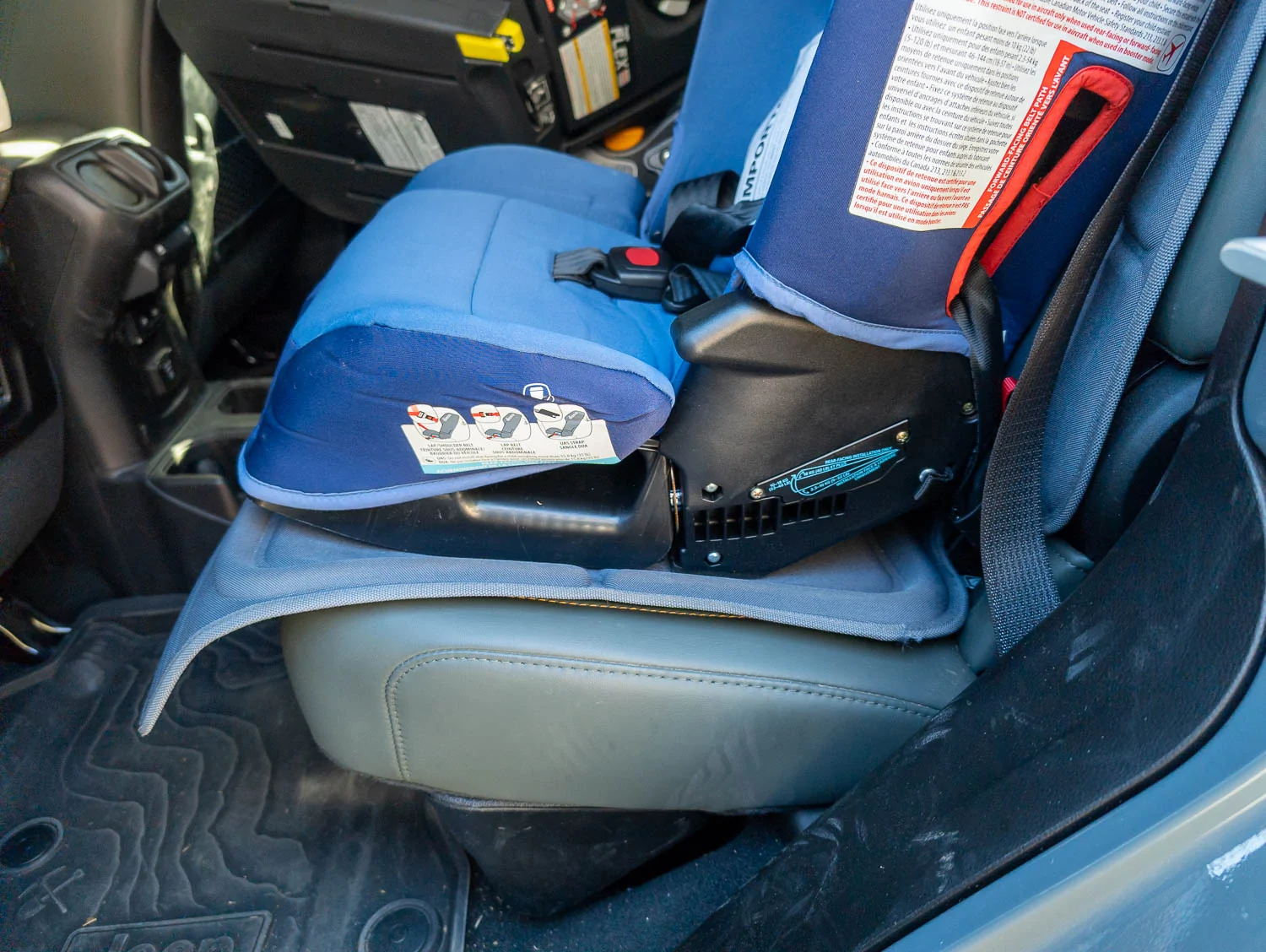

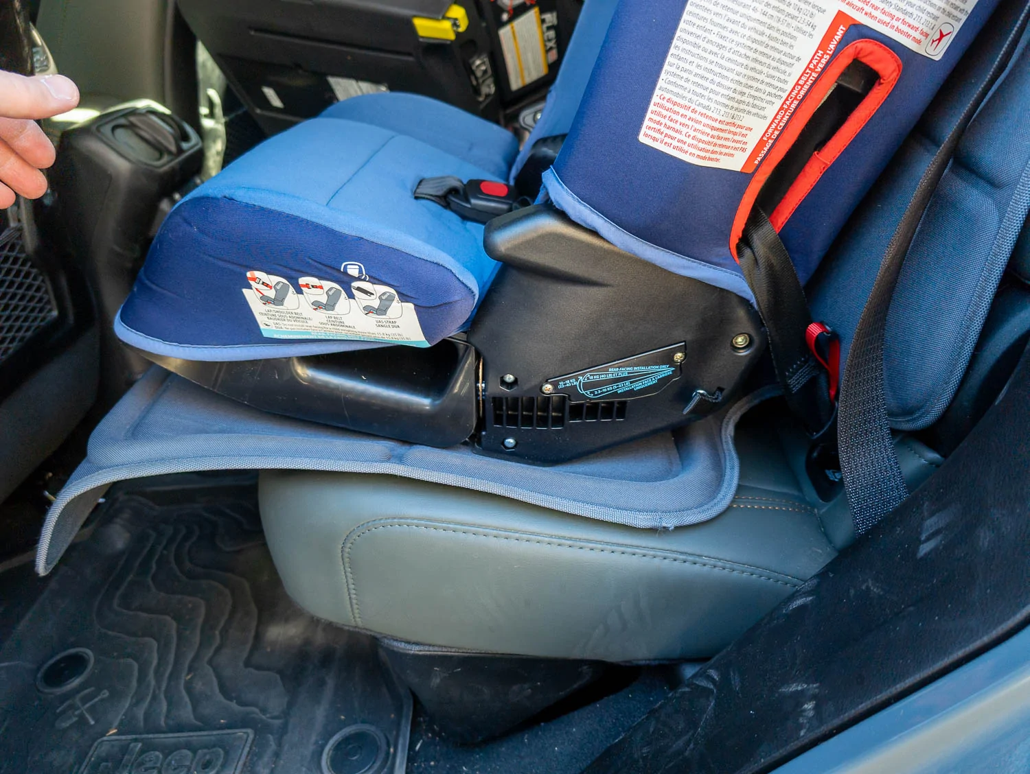

I'm trying to install a Diono Radian 3R car seat (forward-facing) and for the life of me can't get the thing cinched down after fooling with it for over an hour. I've tried both the included LATCH anchor and the vehicle seat belt. The Radian 3R is replacing a rear-facing Graco Extend2Fit that cinches down perfectly fine in the same spot (but the Graco is simply too large to fit three across).
I ran across @Dempsey 's thread (https://www.jeepgladiatorforum.com/forum/threads/car-seats.72958/), but figured I'd start a new one... mainly to vent my frustration with this thing.
I pulled the seat headrest out with only slight improvement in fit. Photos in sequence: the seat all the way back (where it should be), then the amount of play pulling the bottom of the seat forward, and the unacceptable amount of side-to-side play (12"?)...
Jeep Gladiator Diono Radian 3R forward-facing has me beaten Seat1
Jeep Gladiator Diono Radian 3R forward-facing has me beaten Seat2
Jeep Gladiator Diono Radian 3R forward-facing has me beaten Seat3
I'm at a loss for how this seat could possibly be anchored to any typical vehicle without sliding around all over the place? (due to where the seatbelt pass-through is located on the thing)

I had this same seat 3 across forward facing when mine were in car seats. I used the vehicle seat belts in all locations. The rear seats in our trucks are firmer than my wife’s suv, I would get in the back and put a knee in the seat. This allowed me to stop the movement you are seeing. I couldn’t pull the latch tight enough so I went with the vehicle belt.

@Mojave20 - how much play did the seat have in it when it was "done"? Same Diono Radian 3R, or one of their other models?
The Graco barely moves half an inch with the same technique (knee in the seat and full body weight while pulling the slack in).

Same Diono Radian 3R you have pictured. Side to side had minimal movement. Forward and back had a little more movement but nothing that made me uncomfortable with putting my kids in them. They were sucked down tight enough that after having them in there for a few years my rear seats have permanent impressions.

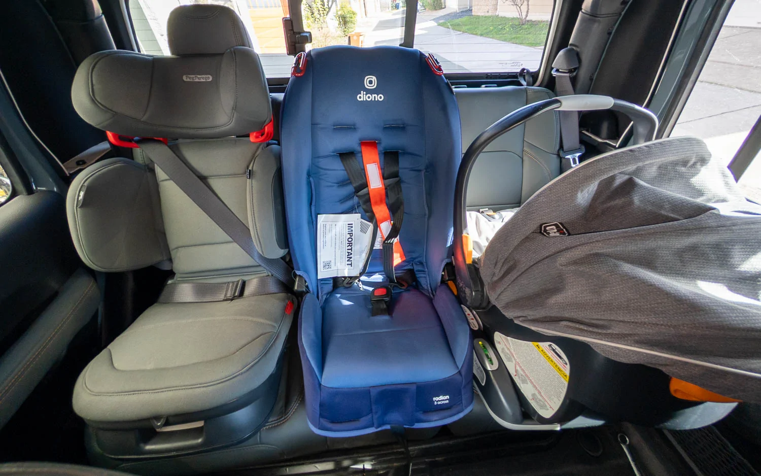

So the two outboard seatbelt buckles in the JT are ridgid metal plates with a vertical travel stop on them that really makes it difficult (impossible for me) to get the Diono cinched down properly in either outboard position.
The center seatbelt buckle in the JT is on a totally different flexible steel cable assembly, not a metal plate - made it easy to get the Diono tightened down with almost zero movement in any direction.

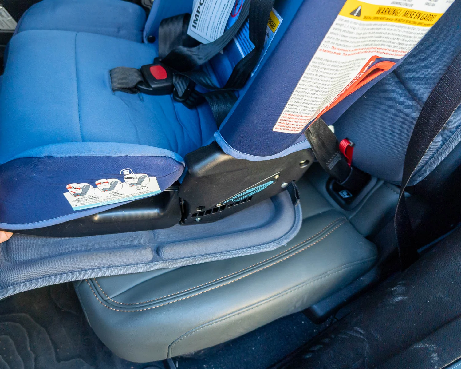

For anyone down the road reading this, here's the fit of three across from three manufacturers. Peg Perego Viaggio Flex 120 booster, Diono Radian 3R, Chicco KeyFit:
