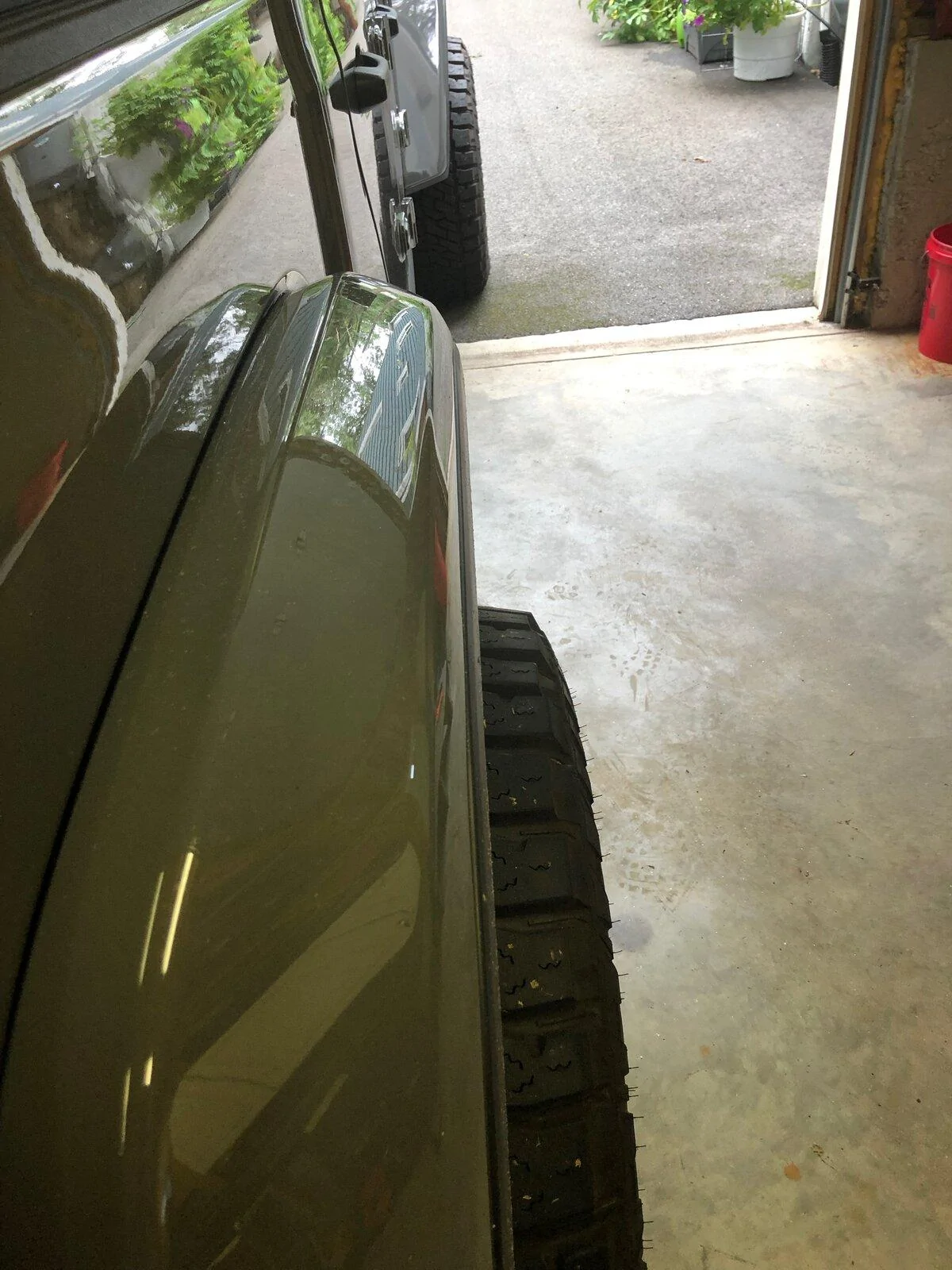

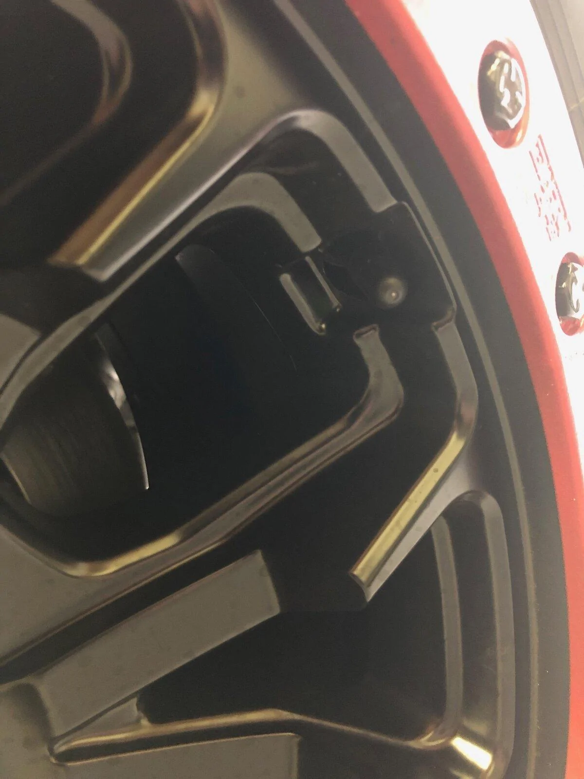

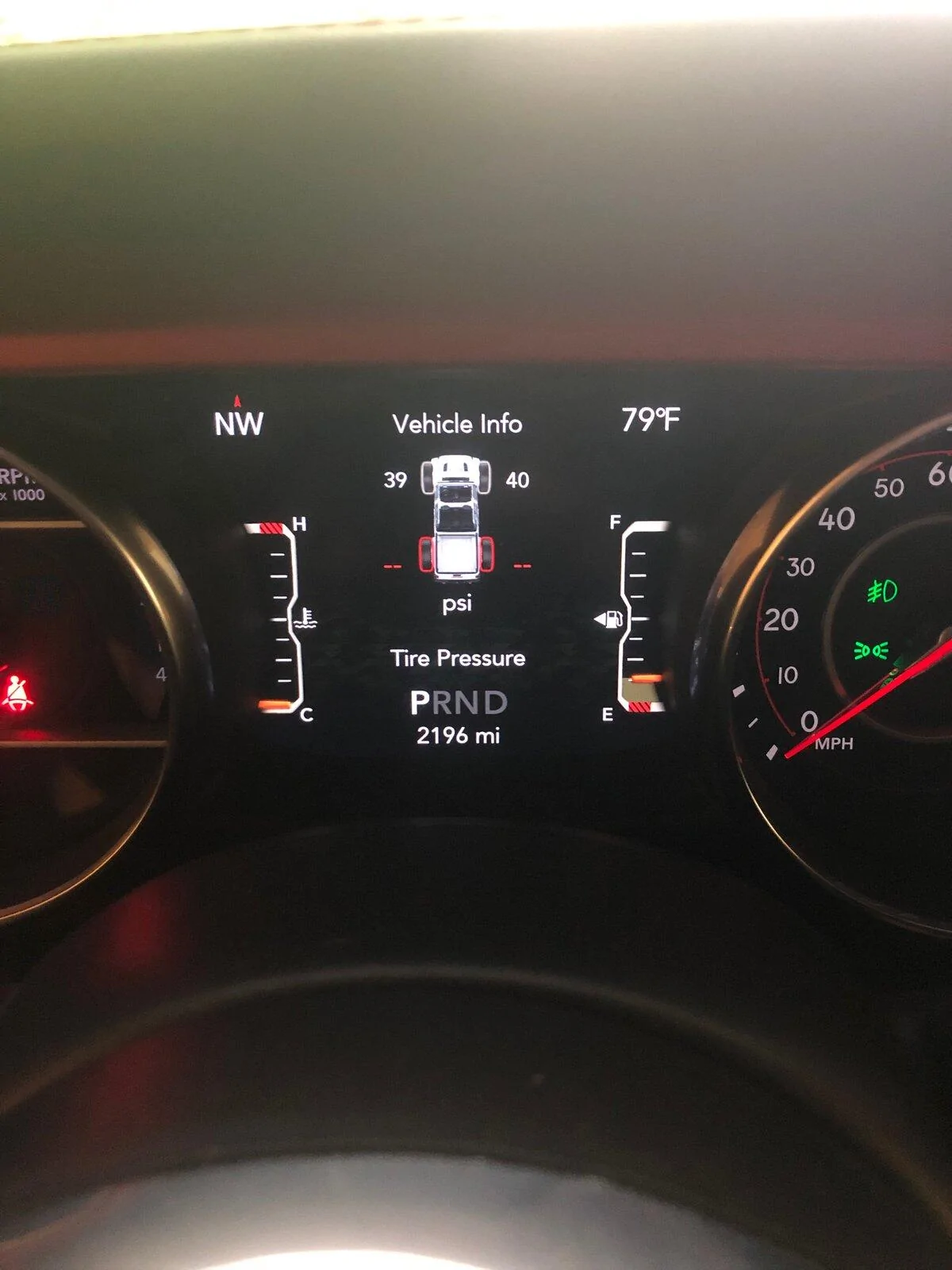

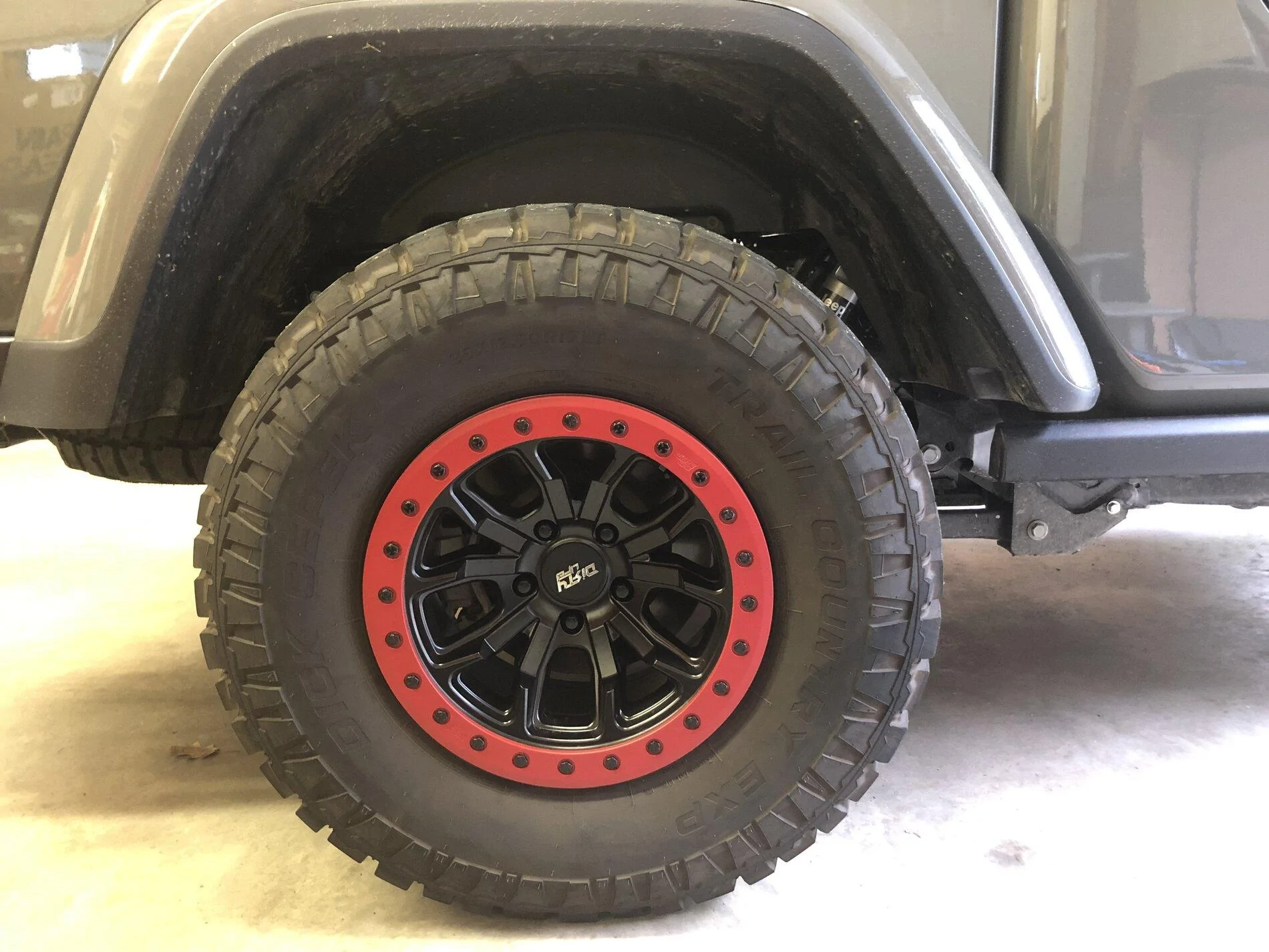

I recently mounted the DL DT-1s with 4 new OEM TPMS sensors. They are 17x9 w/ 4.5 BS. I am unable to get the TPMS to read the rears. I swapped a rear from the front and now its reading the sensor from that wheel and not the one in the back. This leads me to believe there is an issue with the rear TPMS signal and reader. With 4.5 BS the wheels do have some tire poke, about 1.5", but the TPMS are sunk into the wheel to protect them on these rims so it can't be that much further out than OEM.
I tried to air them all down to 15psi, drove a few miles, then inflated them all to 40psi, and still can't pick up the rears.
Anyone with similar issue with wheels or any 4.5 BS wheels?
Jeep Gladiator DirtyLife DT-1 & TPMS IMG_3091
Jeep Gladiator DirtyLife DT-1 & TPMS IMG_3088
Jeep Gladiator DirtyLife DT-1 & TPMS IMG_3089
Jeep Gladiator DirtyLife DT-1 & TPMS IMG_3090

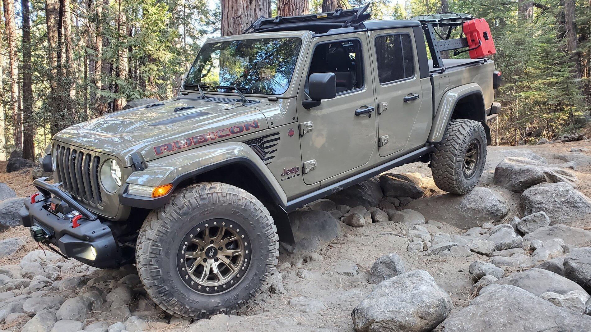

BTW I also have Dirty Life DT-1s!
Jeep Gladiator DirtyLife DT-1 & TPMS 20201017_095805

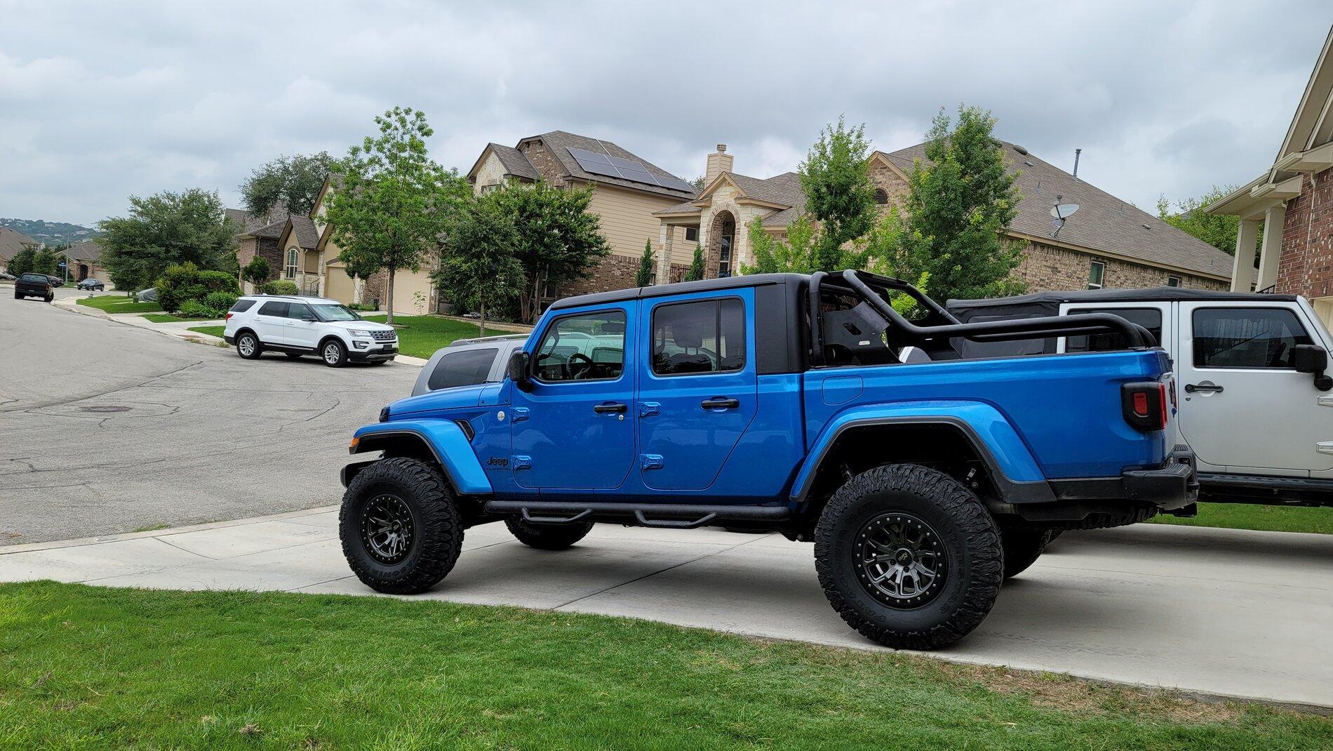

Also this thread now has all the DT-1 colors represented
Jeep Gladiator DirtyLife DT-1 & TPMS 20210528_140045
