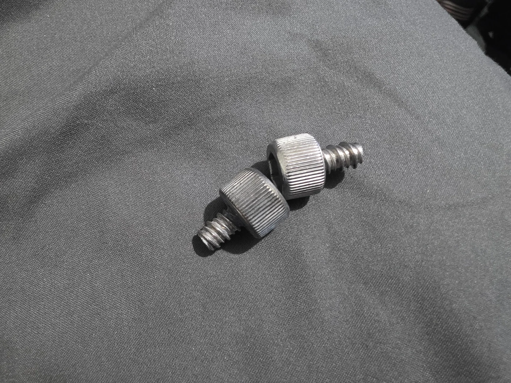

1. I went to the junkyard, and got the screws from a burnt up jeep. The junkyard was super nice, and gave them to me for free. Note: this is optional since you can use the original one, but I wanted to have extras

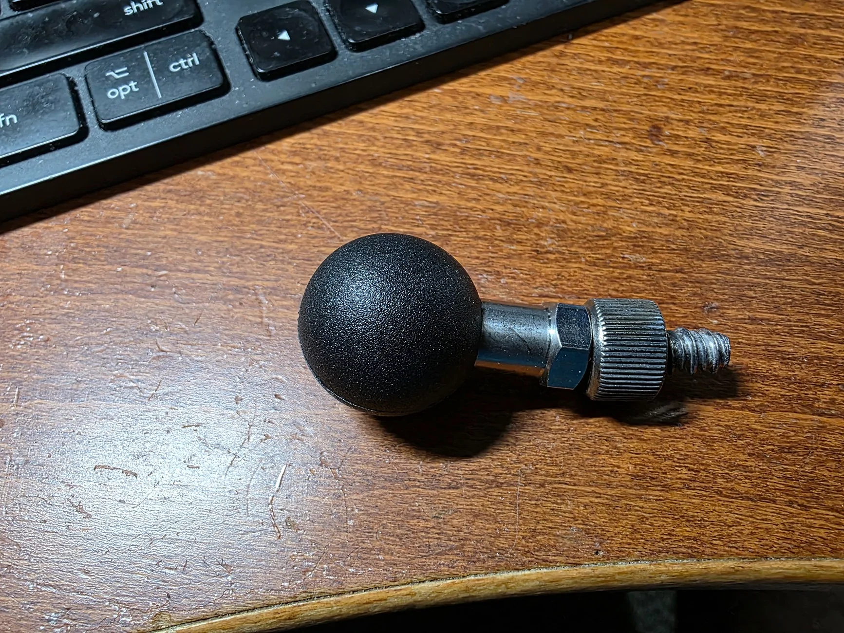

2. I bought a 1in ball mount with a 1/4 thread
https://a.co/d/eNfYDWr

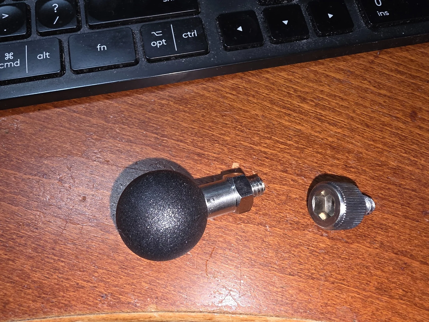

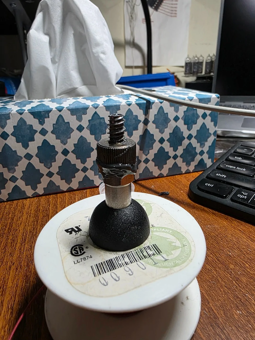

3. Using a dremel I cut about 4mm of the threads, to make it sit as flat as possible inside the Allen key hole
Jeep Gladiator DIY: Grab Handle ball mount 20251025_221012
4. Using a dremel brush tool, I cleaned all the surfaces
5. Made sure the final cut was good enough, you'd want a little bit of space between the screw head, and the hex head, essentially the threaded side of the ball mount would sink into the Allen key hole of the OEM screw with a little bit of spacing.
Jeep Gladiator DIY: Grab Handle ball mount 20251025_221028
6. Using JB Weld, I filed the Allen key hole of the OEM screw with the mix, and then pushed the threaded side of the 1in ball into the hole, then wiped out the excess jb weld.
7. Finally, made sure that it's straight, and placed it upside down to cure overnight

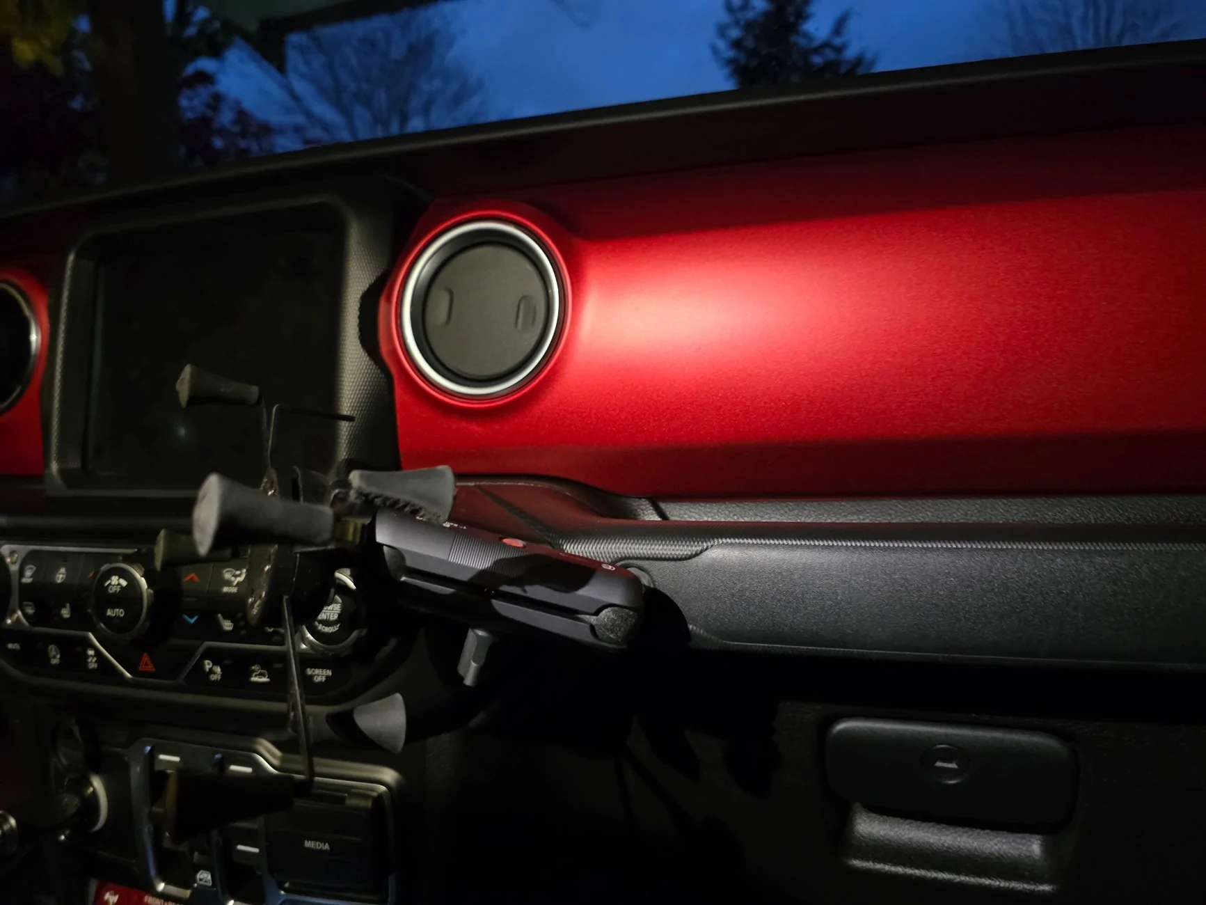

Final product
Jeep Gladiator DIY: Grab Handle ball mount 20251026_183104
Jeep Gladiator DIY: Grab Handle ball mount 20251026_183129
Cost:
1. 10 Canadian plus tax(ball was on sale)
2. Some borrowed JB Weld from my cousin
Notes:
1. Make sure that the JB Weld does not form a ring above the diameter of the OEM screw, since it's a snug fit
2. You are probably be able to use metal weld
3. I left it to cure 24 hours, before installing it
4. It looks very strong, and I think it will definitely hold, but I'll put an update if there are any issues

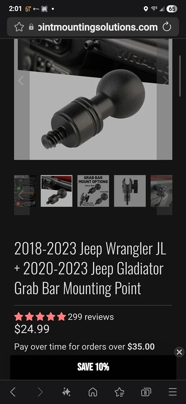

After I started to think about this, I found there are ready made alternatives but they were too expensive, or not available outside the US(I live in Canada). The two alternatives that are worth considering if you live in the US
1. Bullet Point Solutions, Always shows out of stock, at least here in Canada, Costs about 25 USD plus taxes and shipping, not to mention tariffs and duties, probably comes to 50 CAD
2. CMM makes this, but it was too expensive, especially with shipping to Canada(70 Canadian 🤯), so that option was a non starter
Jeep Gladiator DIY: Grab Handle ball mount 1761584071226-i
My mod cost me 10 CAD, and 15 mins of elbow grease
Hopefully this helps someone else 👍

Jeep Gladiator DIY: Grab Handle ball mount Screenshot_20251027_020142_Samsung Internet
nasiraod
Aug 21, 2025
Vancouver, Canada
2025 Golf R, 2020 Jeep Gladiator Rubicon
Hardware Engineer
Alot easier than your mod
We don't seem to be able to get those in Canada.
When I go to the website, it always says sold out. Then it is 25usd plus god knows how much in shipping/duties/tarrifs, would come probably close to 50+ Canadian, my mod cost me 10 Canadian, plus about 15 mins of work.

CMM offroad sells them
I know, as I mentioned in my post, as I started this mod, I did notice CMM, and the cost is more than 70 CAD with shipping, and god who knows if tariffs/duties are going to be on top
Jeep Gladiator DIY: Grab Handle ball mount 1761583510927-ig
$77 Canadian vs 10 bucks and 15 mins of work, seemed like a good idea to me, and my post is to try to share this with anyone that is not in the US, or want to spend less, and is handy. That is all
Just my way of giving back
Hopefully this helps someone :)
Both CMM, and Bullet Point products are either not available or too expensive outside the US
I will edit the original post saying that I considered both
