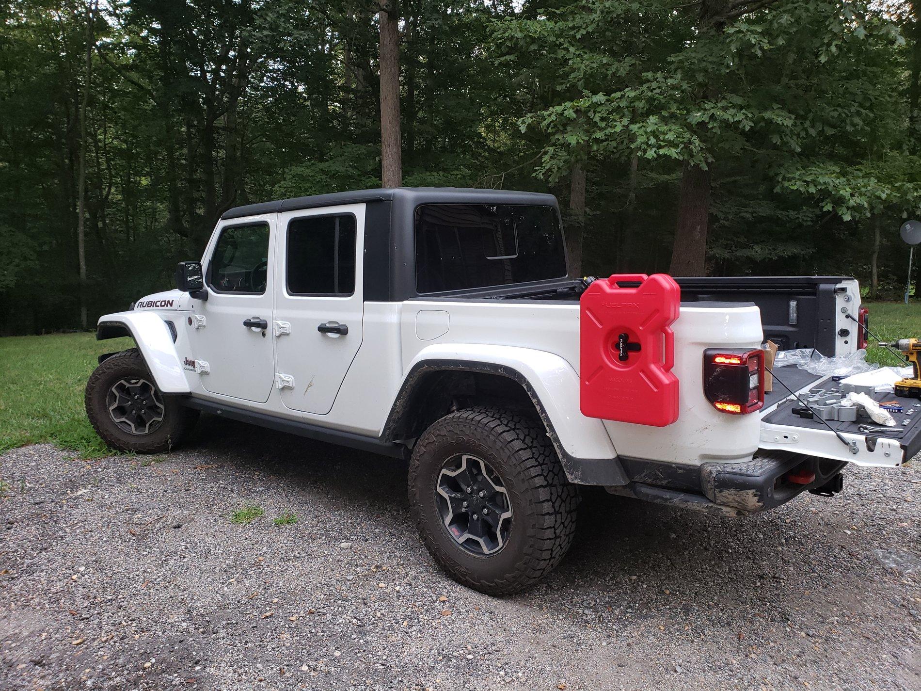

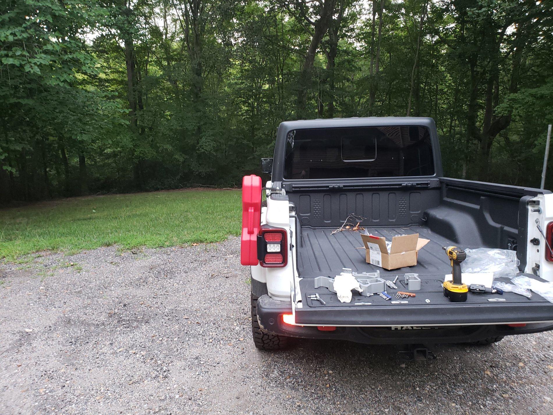

I put this together today with stuff I had lying around. I ordered the L bracket but had everything else. Mounts to the trail rails inside the bed.

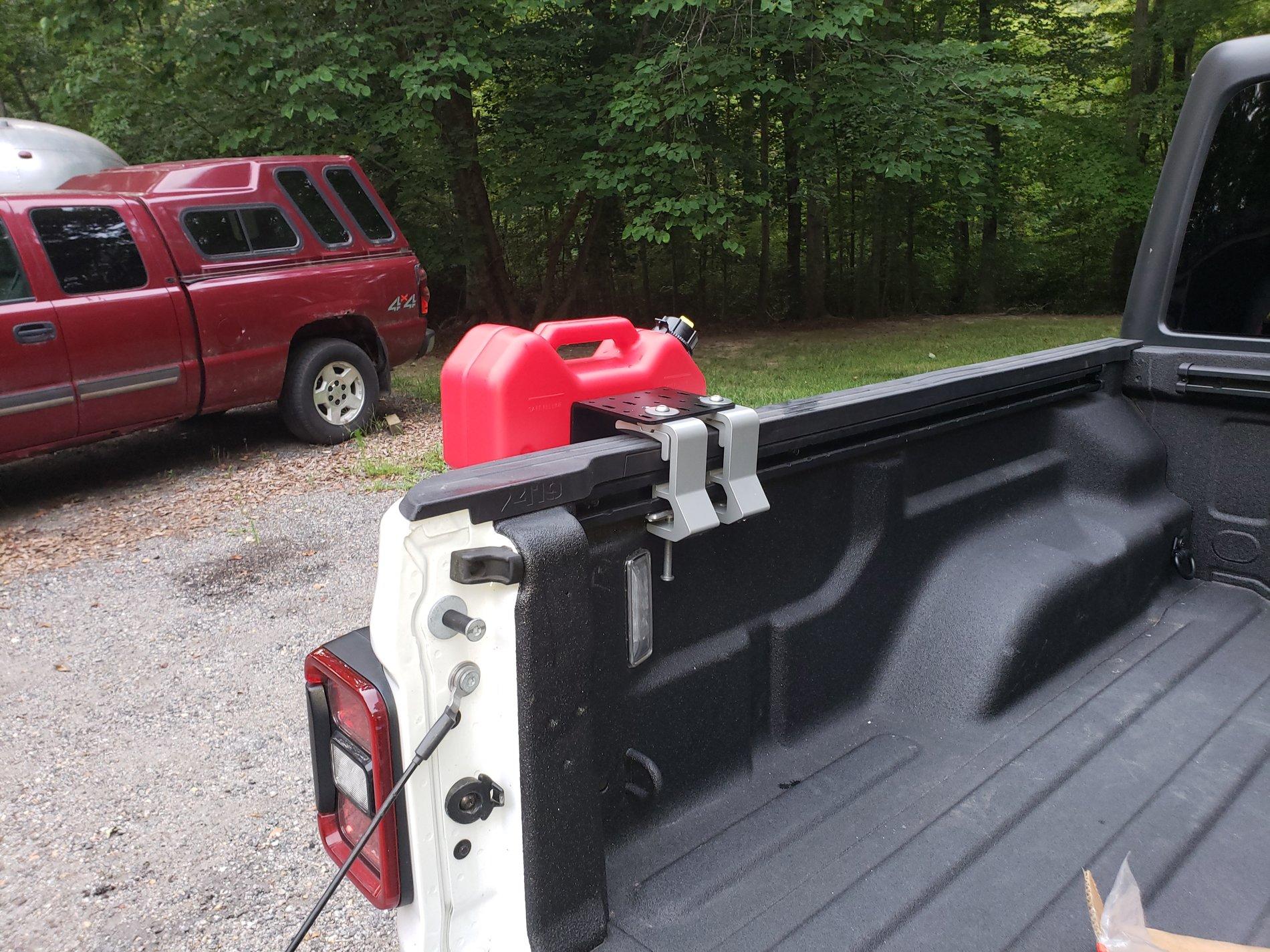

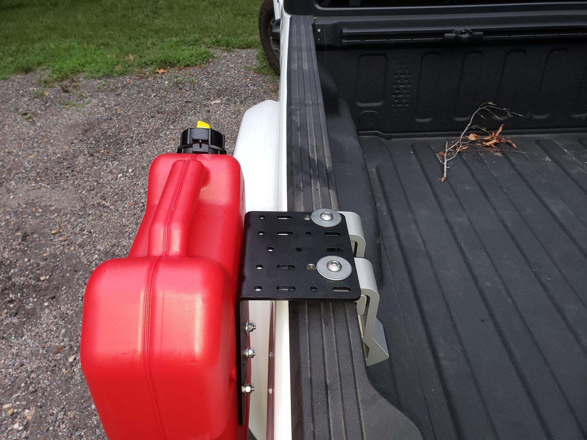

The mounts are from the thule tracrac 2016+ tacoma mounting kit and are for mounting a truck bed tool box, came with the kit I got to mount the tracrac (can be seen in a different thread). I had to enlarge the holes on the L bracket but it otherwise bolted up. As you can see, it sticks out a little, but that was due to the included hardware. I could mount it to the other set of enlarged bolt holes seen in the 2nd pic, but then the upper hardware for the rotopax mount would just barely touch the body. My plan, if I use it, is to trim the bolts and use thin nylock nuts with rubber covers and add a rubber bumper against the body to keep it from bouncing at all and protect the paint. It would work fine as I have it but sticks out a little too far, I'd rather it be tucked in to the body.

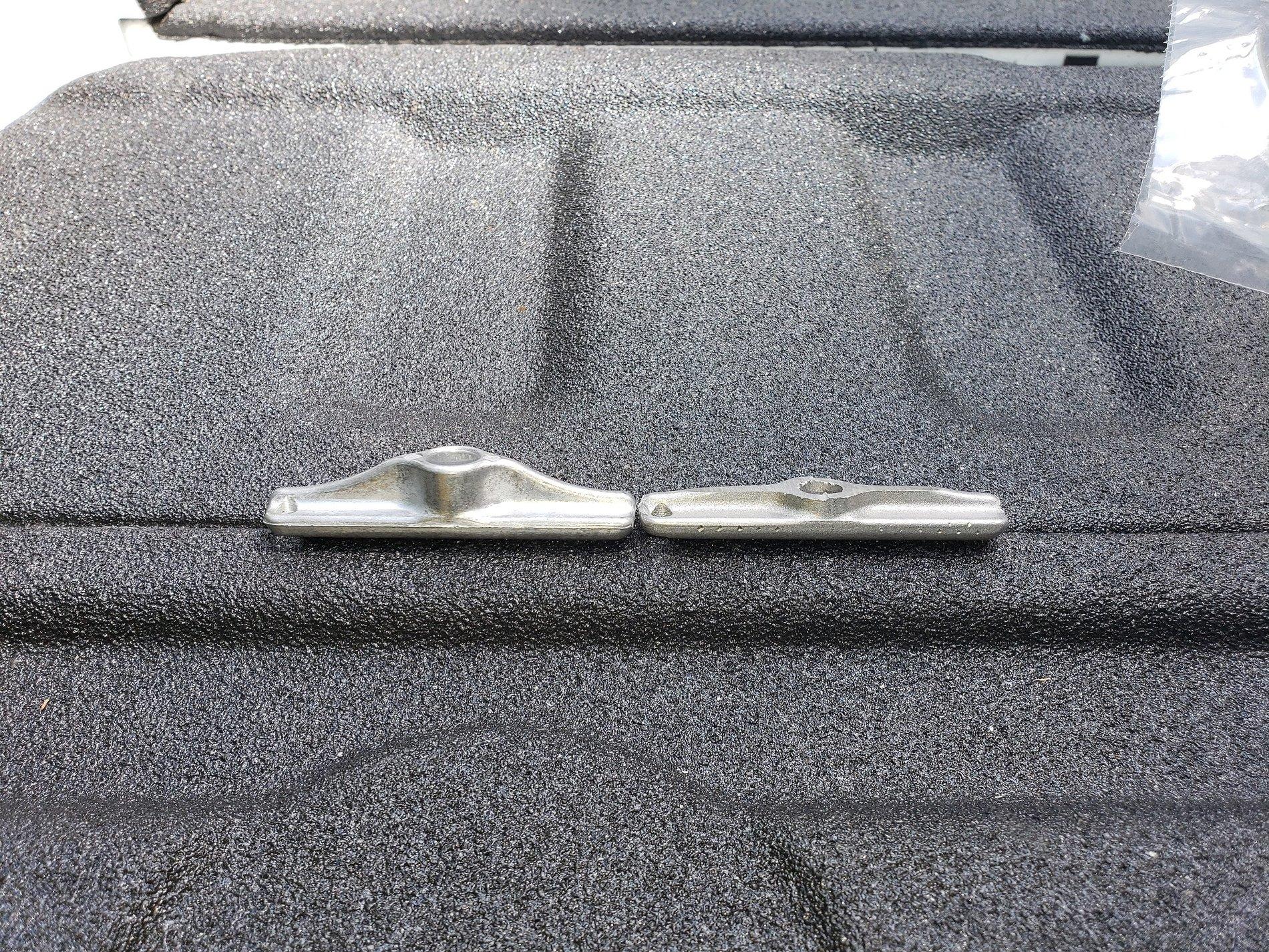

You'd have to modify the feet on the bed rail mounts like so:
Jeep Gladiator DIY rotopax bedside mount 20190630_153126s
And drill out the set of holes on the L-bracket (to 3/8") you want to use to fit the hardware that come with the mounts. Total cost is around $170, not including the actual rotopax/fuelpax container. I had everything except the L-bracket, so it cost me $40. You'd also have all the mounts necessary for a TracRac (fixed height) or Xsporter (adjustable) bed rack.

It floats away from the body - you can see it in the 2nd pic. I want to bring it closer to the body, but need different hardware for attaching the mount to the L-bracket as the bolts stick out too far and just touch the body. I also plan to put a rubber bumper on the bottom of the bracket so if it vibrates or gets bumped, that's what will contact the body and not anything metal. I haven't done any testing yet, just test fit it yesterday as I had all the parts in. I'm not concerned about it hitting anything as installed in those pics as it'd have to take a pretty good hit to contact the body - but, with it sticking out, the chances of it taking one are a little higher, hence why I'd rather tuck it in closer. That should also put less stress on the mount.
