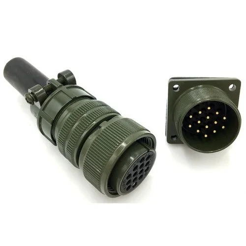

The best option for those that keep bending pins R&Ring doors, is to swap out for the military/aviation style Amphenol connectors. If I were to have the bent pin issue, these are what I will go with...
Expecting the doors to come off, and the whole rugged image Jeep portrays, you'd think these would be standard.
