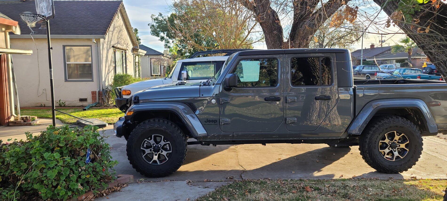

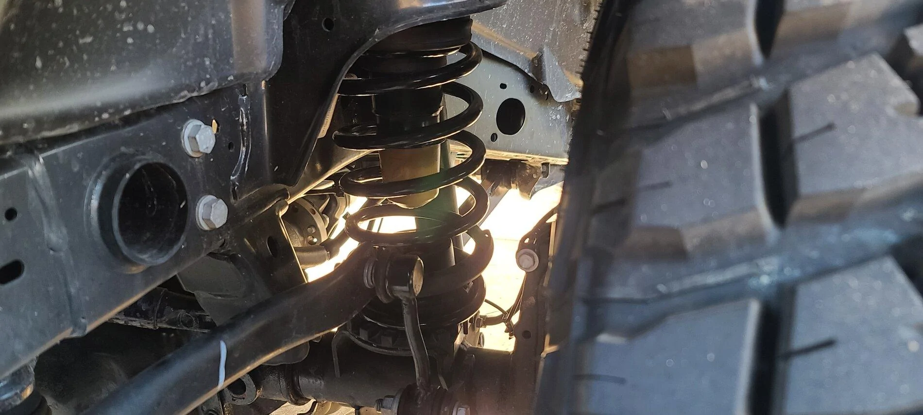

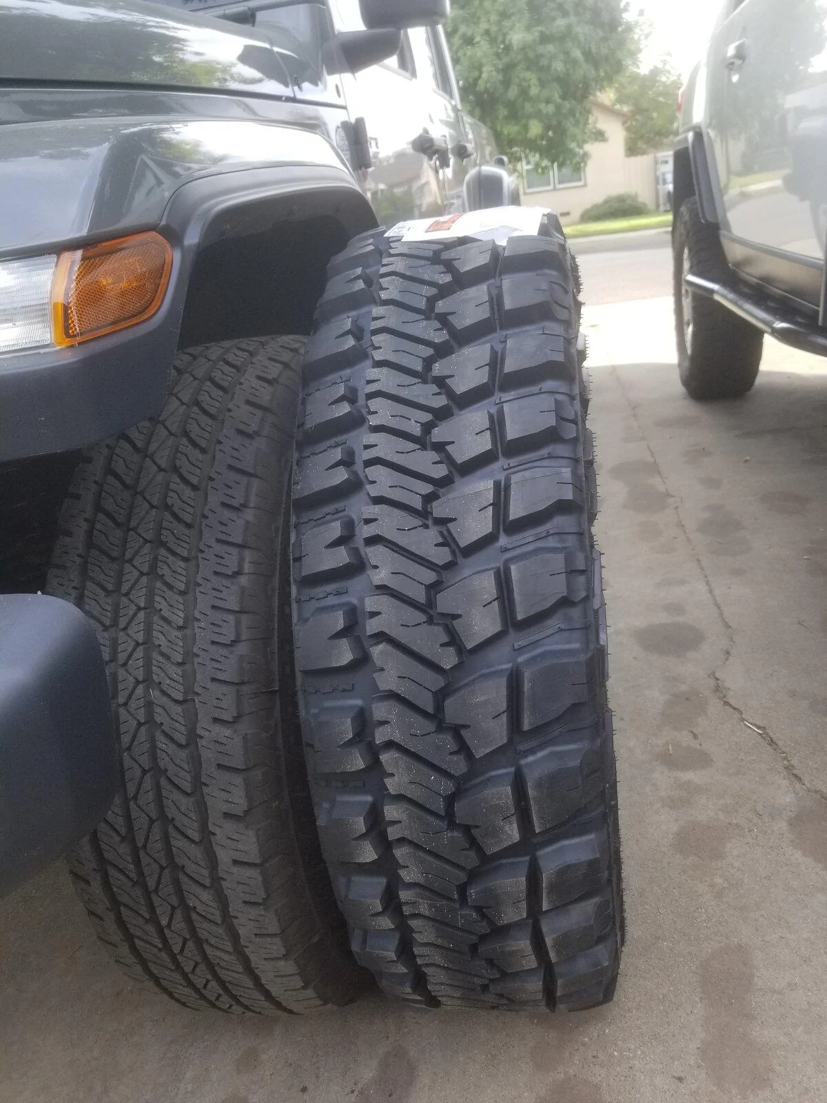

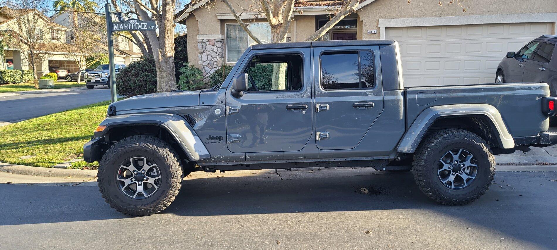

So i took most of the advice on the thread and went with teraflex 1 1/2 spacer lift with terra flex progressive bump stops., and Mopar extended lower control arms. Perfect solution for my rubbing. Installation was very simple. I also bought the 3/4 inch rear spacers but I like the stance without them. I just bought a toy hauler so if it sags after towing it I will install the rears. Thanks again everyone for your help.
Here are some bad pics.
Jeep Gladiator Does a a 1.5” Spacer lift affect steering. 20201229_142457
Jeep Gladiator Does a a 1.5” Spacer lift affect steering. 20201229_153232

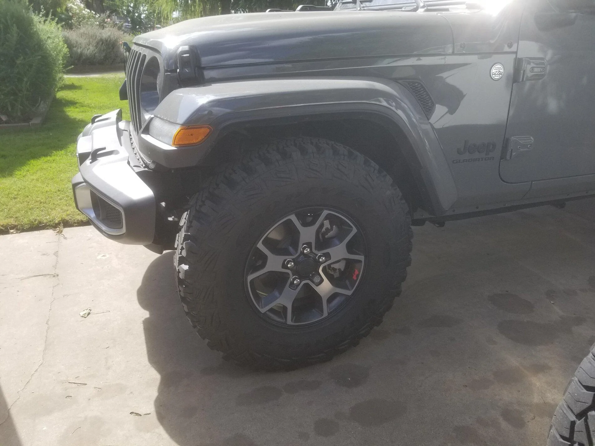

Hey Russ, can you shoot me some more pics of those tires, some different angles?!!! About to pull the trigger on the exact same MTRs, waiting for March 1st, see if any incentives pop up...anyways gonna be doing like a Tire Rack or something like that and don’t wanna deal with trying to return them if I don’t like them in person (the size that is, I already know I love the tires)....anyways yeah, shoot some pics?!?!?! Thanks!!!!

More pics
So literally going to pick my MT/Rs up tomorrow! What psi are you running? Wear pattern seems ok? I used to run 28-30psi on my old ones (315/70R17), but obviously a slightly different size and that was on my JKUR...
34 psi chalk tested
