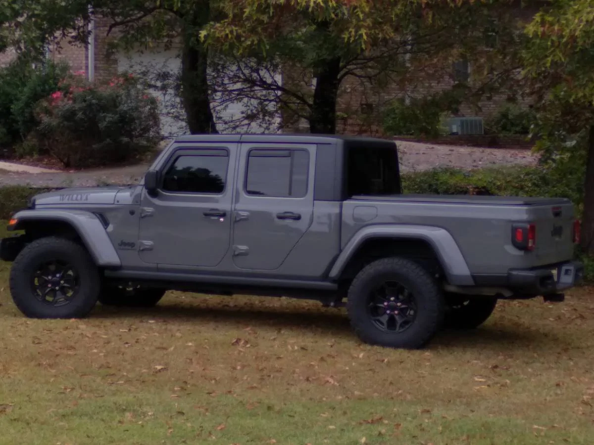

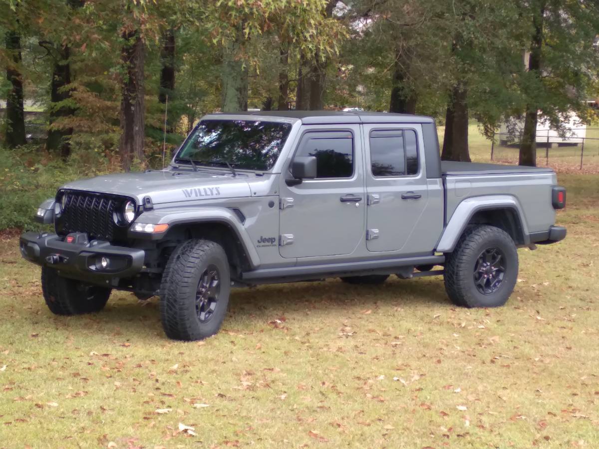

I had installed the 1.5" Teraflex leveling kit earlier. After installing a winch, I felt that I needed another 1" of level. I added another 1" Teraflex puck to the front, along with an adjustable track bar and shock relocation brackets. I also increased the bump stops from 1" to 2". I like the results. The truck is level from front to back (using a carpenter's level on the bed) and rides the same as before. I may add extended sway bar links in the future, but had no problems with the stock links at full suspension travel. These tires are 34's but I will go with 35's later.
Jeep Gladiator Upgrading from Teraflex 1.5 level to a Teraflex 2.5 spacer lift 20231006_124024
Jeep Gladiator Upgrading from Teraflex 1.5 level to a Teraflex 2.5 spacer lift 20231006_124115

Is that 2.5” of pucks up front?
AverageJoe
Joseph
Apr 10, 2023
122
170
Killen, Alabama
2021 Gladiator Willys Sport
Engineering consultant
Yes it is. About 100 lbs. of winch and winch plate had made the 1.5" lifted front squat a little.
