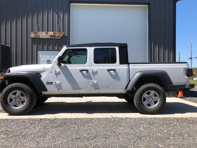

I went with the teraflex shock extensions with the 1 1/2 inch leveling kit. They might not be needed but it made me feel better.
looks good, are those OEM 33s or larger 35s?

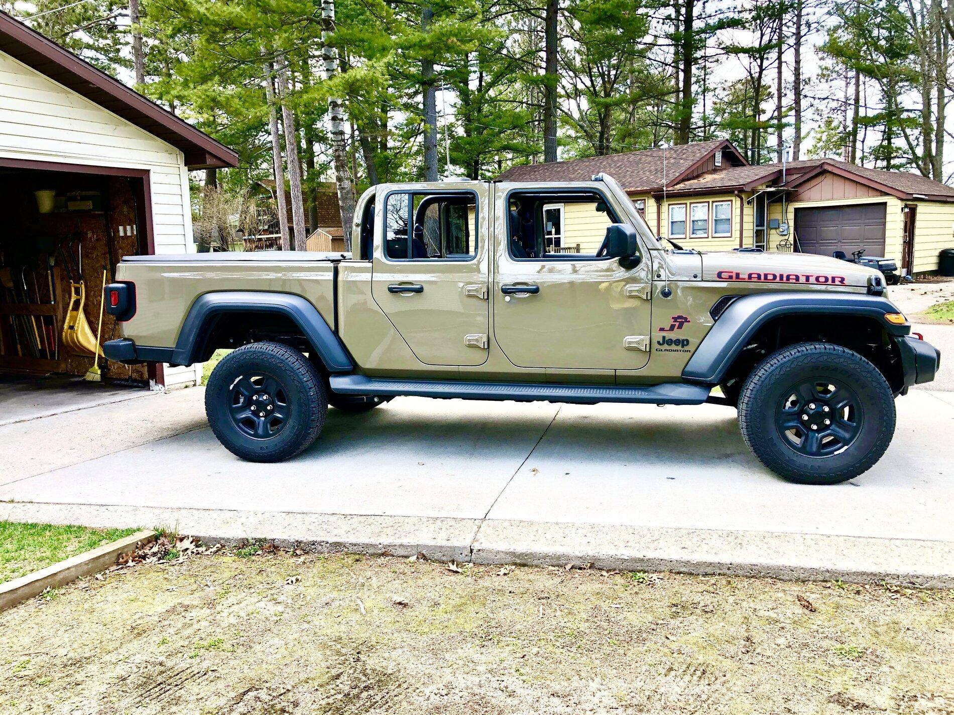

I used an Iron Rock Off-road 2” spacer lift. After installing it retains the factory rake for towing and allowed easily to move from 245’s to 285’s. Installed in no time myself and I‘m an old guy. Still maintains optimal ride and gained almost 4” with tires and lift. Full videos on their site. Link below.
https://www.ironrockoffroad.com/product/Gladiator-2-lift-kit.html

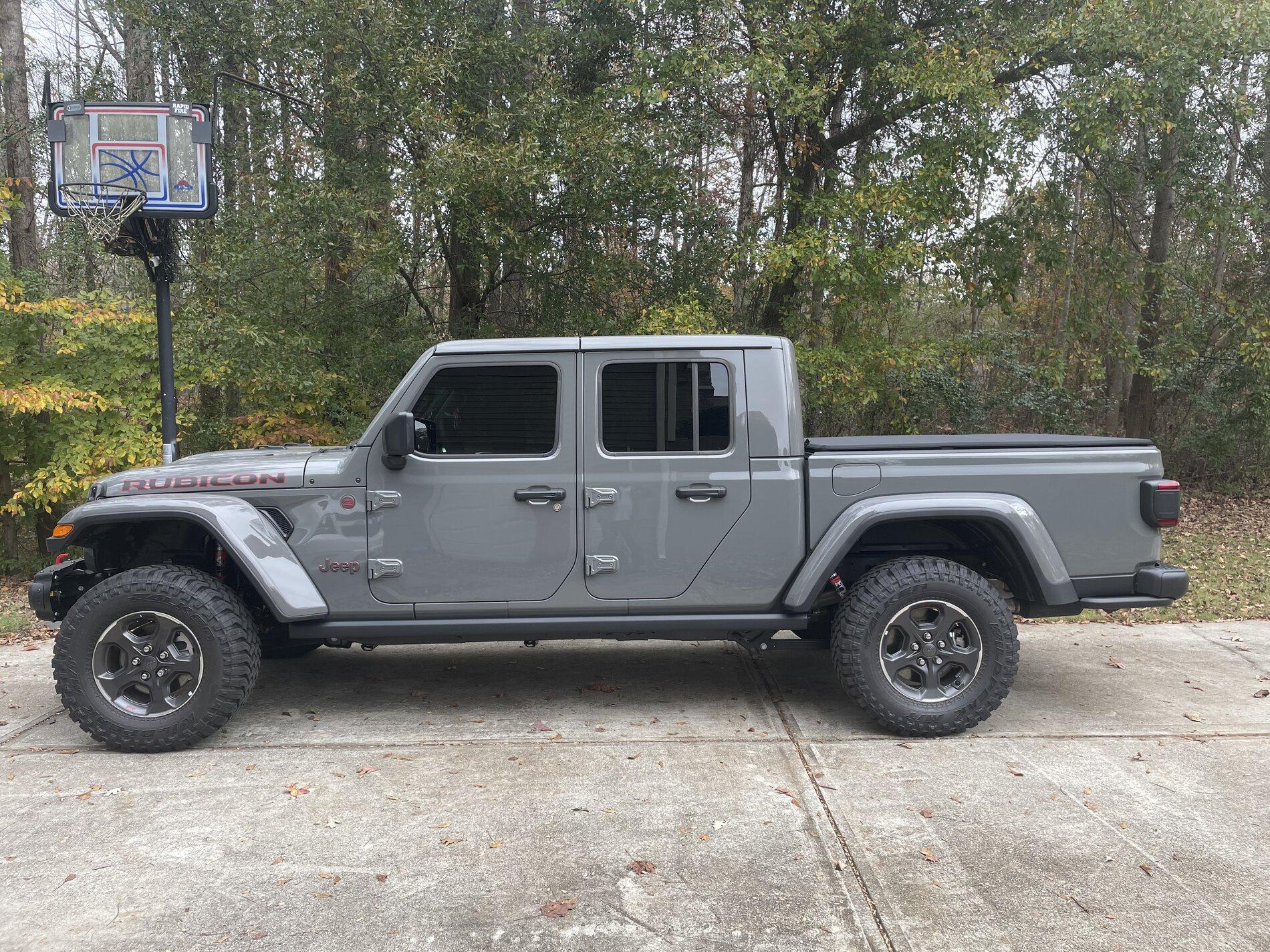

Did you go with the shock extenders or new shocks?
Im assuming you didnt look at his kit. It comes with extenders, and it also does not appear that he has any different shocks from pics.
The kit has an option to have shocks instead of extenders. And I didn't see any shocks in his picture.
I didnt even notice the options for additional selections.
