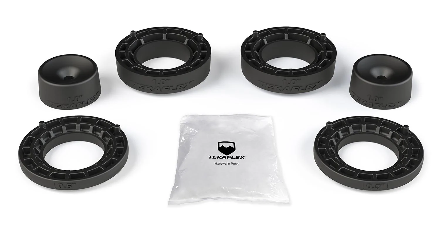

So, what exactly is included in these leveling kits? Just spacer pucks for the front? Or is there more to it than that?
Check the video out, it shows all the parts, but yes it's pretty much the pucks and bump stops.
You can use the pucks combined for 1.5" or separate to make 1/2 or 1" adjustment.

I was very satisfied with the visual improvement with my 285 BFG TA/KO2, and pretty pleased with how easy the install was.
I was NOT pleased with the stupid torque specs... "125ft-lb + 135 degrees".... it would click, then move like another 90 with every ounce of hernia I could give it, so basically I just called em all "good". THEN, they say to "Re-torque them at 3,000 miles after install".... so what, another 125ft-lb+135degrees? or another "GRRRRuuuuunt 'CLICK'"? maybe 5 ugga-chuggas from an impact gun...

I'm a little confused by this kit. It looks like 2 spacers per side, one says 1 inch, and the other .5 inch. So assuming you use both per side, that gives you an 1.5 inches of lift, but the instructions also say to use the factory isolator, which is .5 inches by it'self. So that would total out to 2 inches per side, correct?
How can something left in place being reused add to the equation? It's a zero that is carried over if you were doing the math.
This is just "old jeeper math" because on TJ/XJ/ZJ it was always said that the spacers were X" of lift but if you retained the factory isolator it would be an additional .5" of lift.
You are correct though, if the instructions say to retain it, then it would not add any lift because it was there to begin with.
