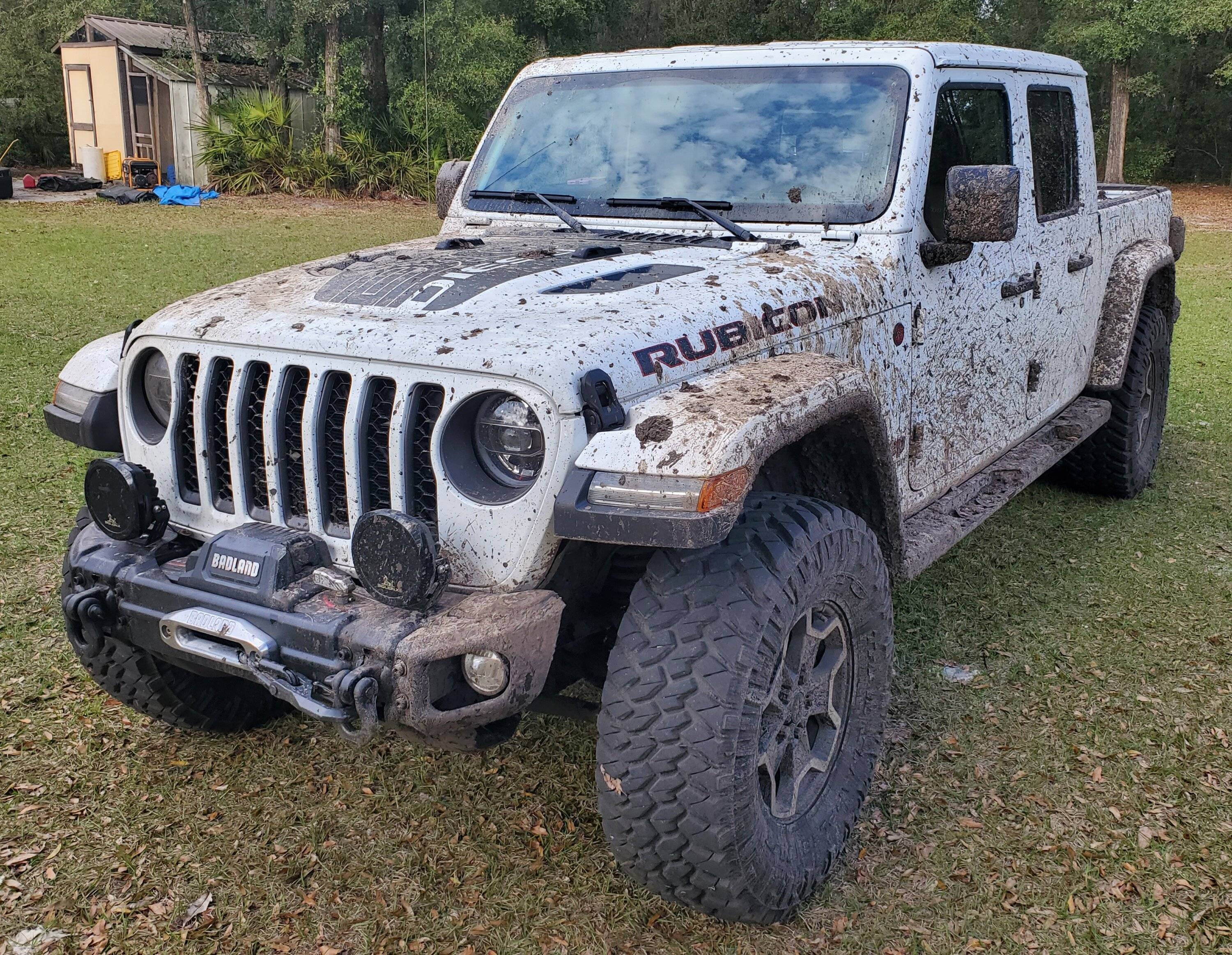

I installed the TF 1.5" kit as well
Only other change was to add the TF 2" front shock bottom mount extensions
No trouble with the alignment but did need to adjust the link to center the steering wheel
Jeep Gladiator teraflex 1.5 leveling kit 20230210_160220
