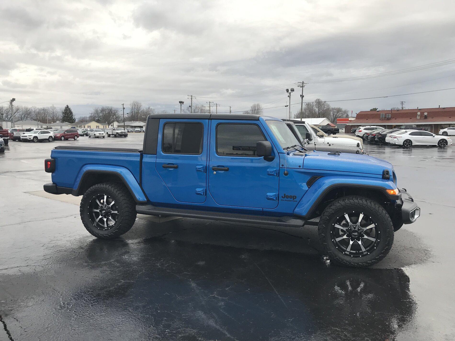

I put 1.5 teraflex on mine. On pavement 90% of the time. Extensions aren't so much needed really. Looks a lot better. Handles a bit different but not that drastic of a change

Sorry forgot to mention the first photo is before. Second is with the leveling kit

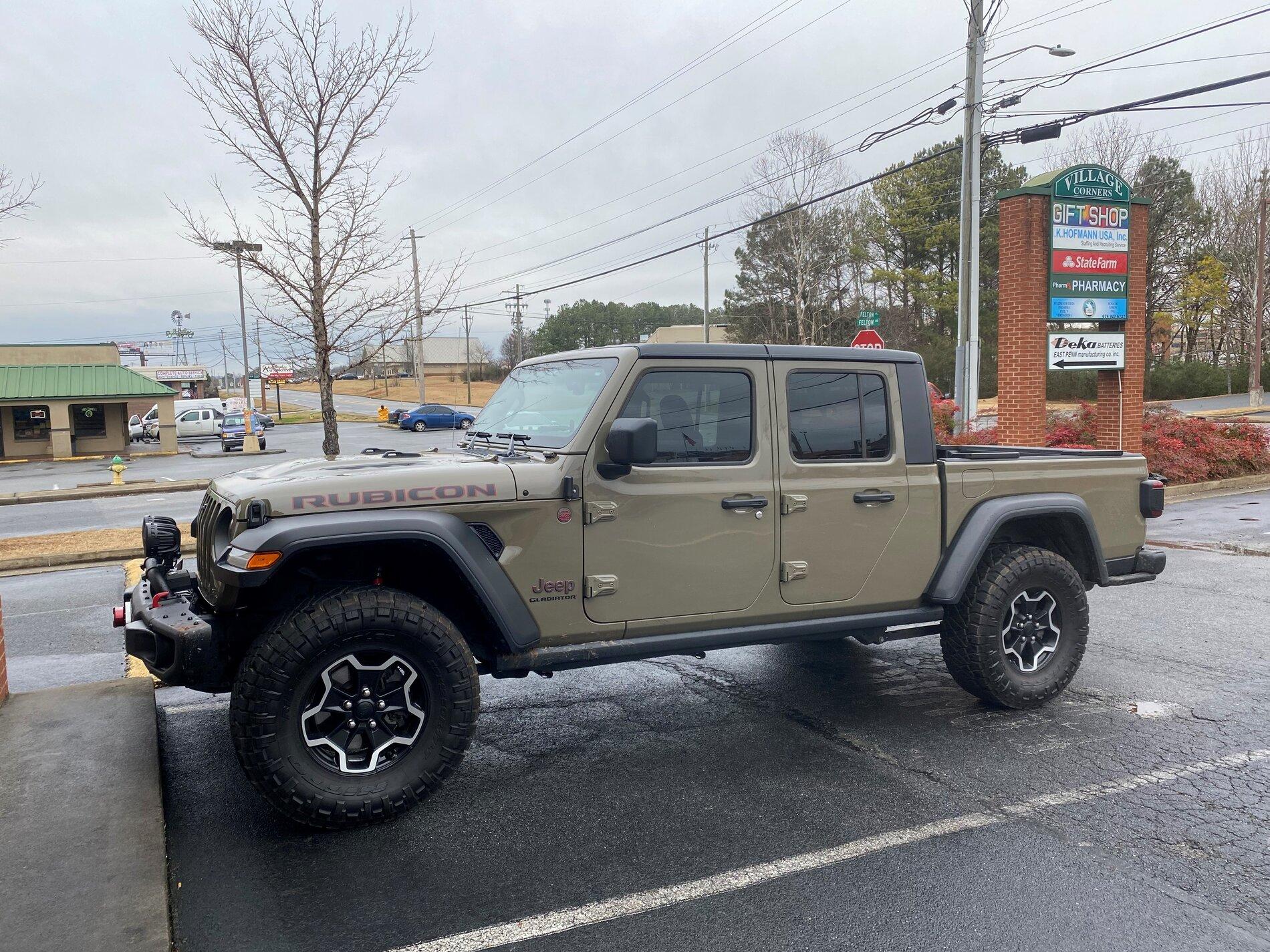

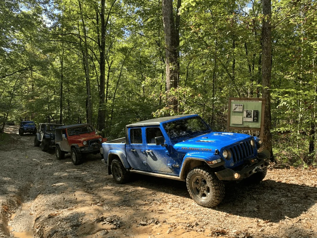

I installed the 1" spacer only on mine this weekend. Measured to the rock rail from the ground and it's 18 1/2" in the front and 19" in the back after install. I have the factory steel bumper with mopar 7" lights, Light bar, and 9500lb winch. Sitting on 35x12.50 ridge grapplers. For reference for anybody who is thinking of doing this. I also have airbags installed in the rear but no air in them (actually 5lbs) in this pic and for the measurements. Truck sitting on a hill in this pic in front of my office so it's hard tell the rake but it's there.
Do you know or can you identify which front coil spring part numbers were installed on your JTR? Mine is equipped the same minus the steel bumper & winch. My springs are 6362AA/6363AA (DS/PS). I'm going for this look & plan on installing the mopar steel bumper & perhaps the winch. I want to retain about 1" rake, so if your springs are the same I'd probably opt for the .75" front spacers.
Thise 12.5" wide tires fit the factory wheels without rubbing?
