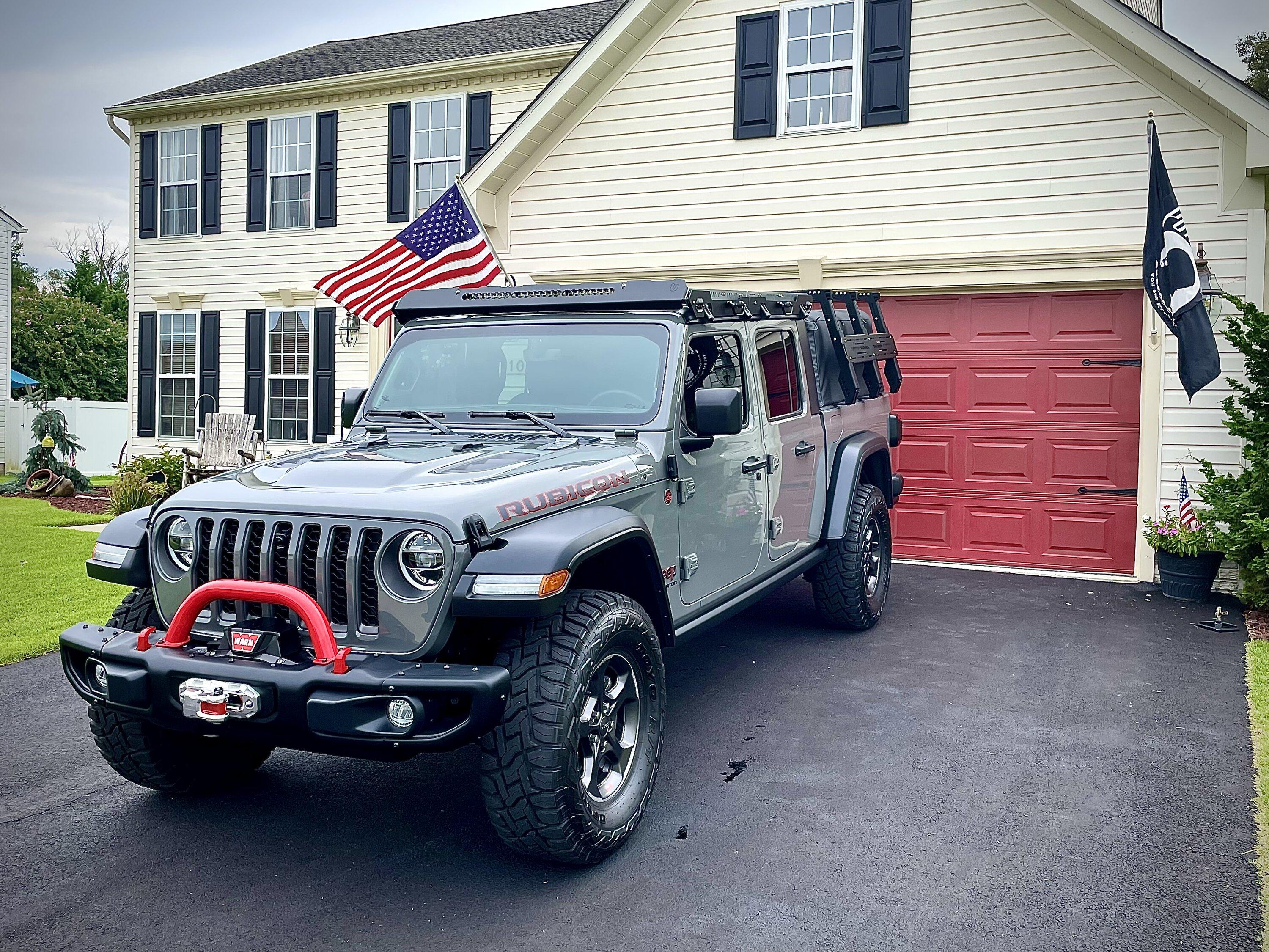

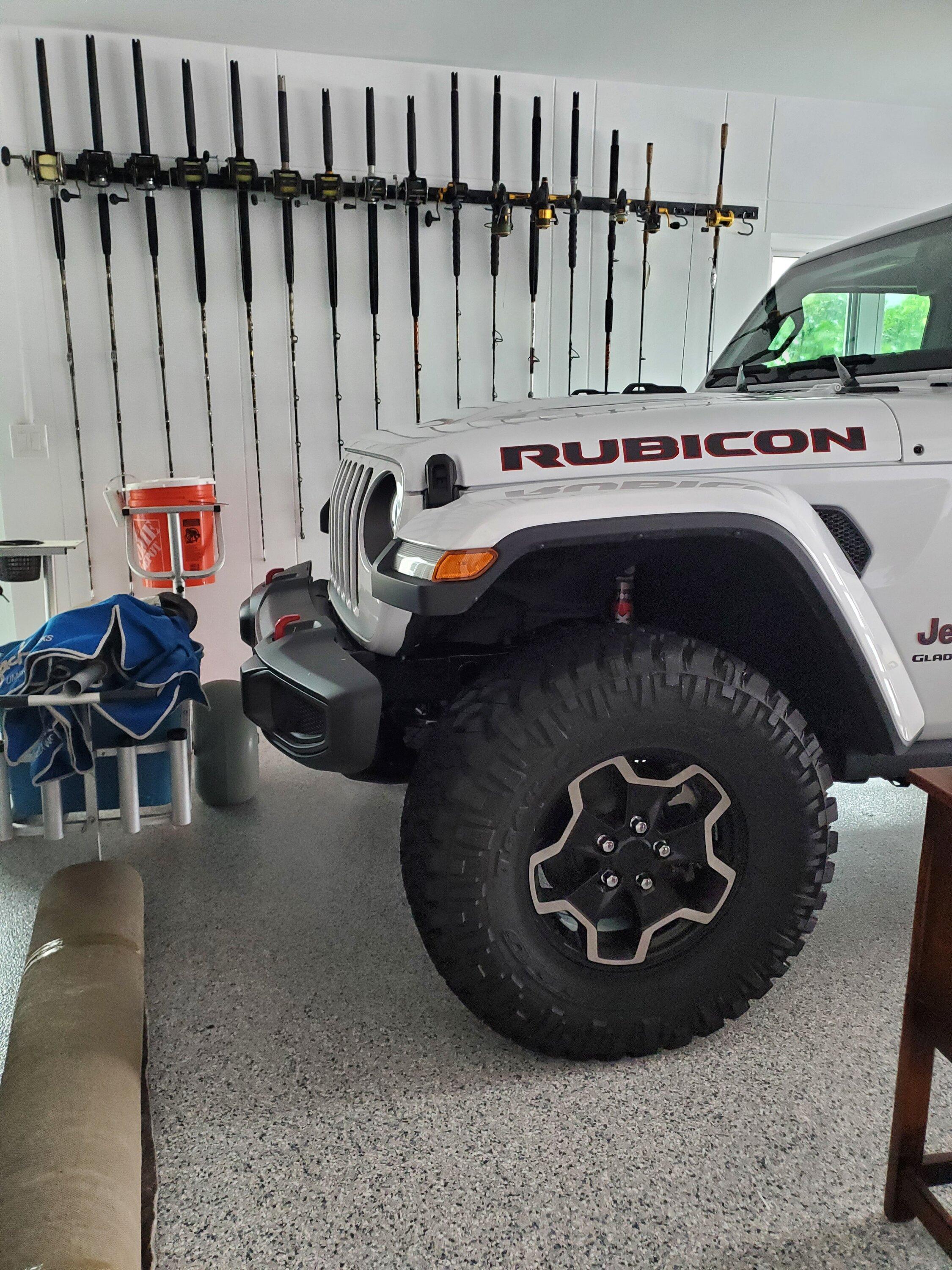

Thise 12.5" wide tires fit the factory wheels without rubbing?
315/70R17 on stock Rubicon wheels. 1” teraflex spacer installed up front, 1/2” teraflex spacer in the rear. No rubbing anywhere.
I like that way that looks a lot. Do you have a part number or link to the rear TF spacers? I can find 1/2" ones for JL, but not JT.

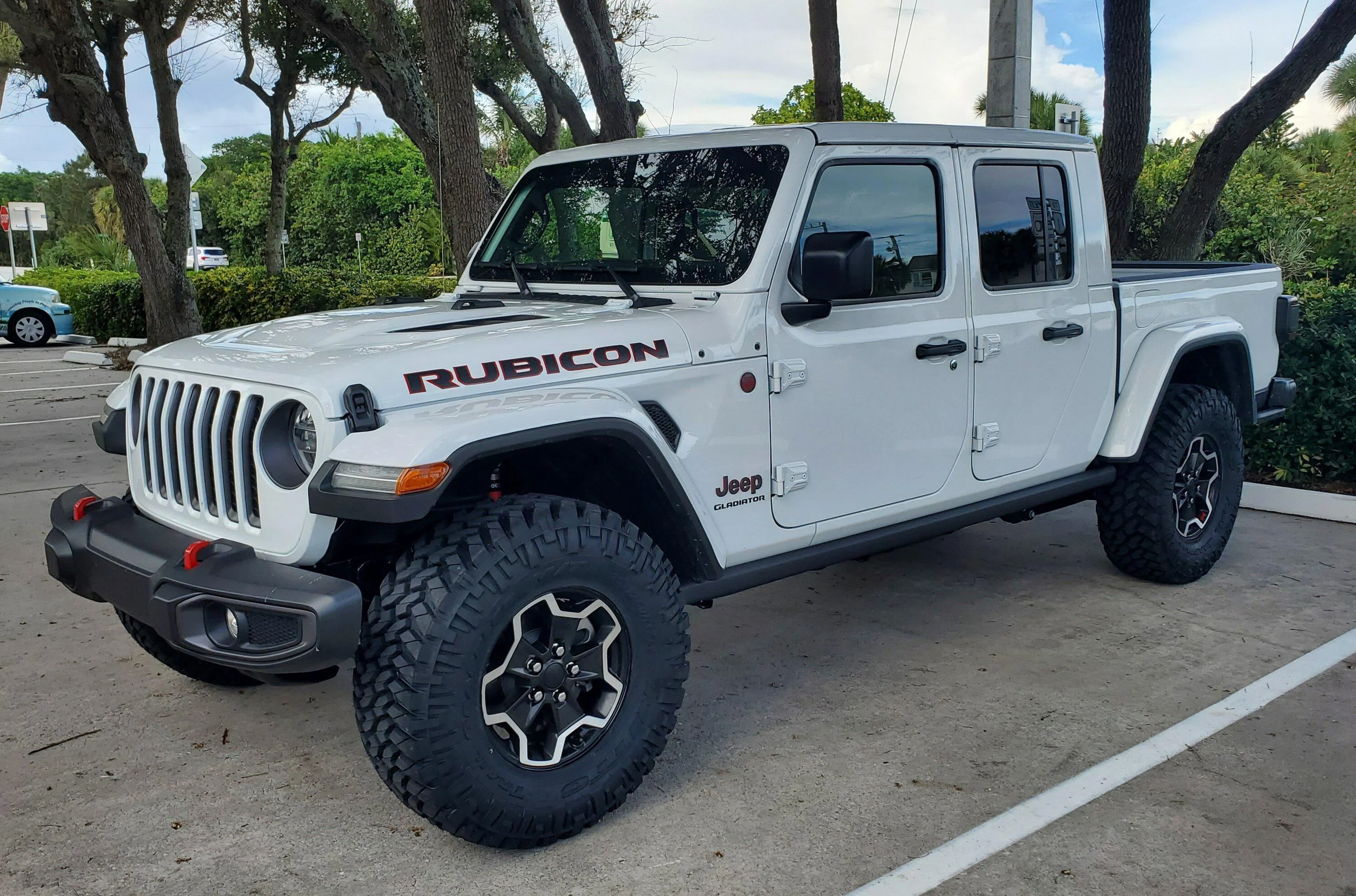

My son and I installed the ( front only ) Teraflex 1.5" Leveling Kit and Teraflex 2" Shock Extension Kit.
Figure this puts us back to within 1/2" of OEM shock travel.
It took right at 1 hour start to finish, including re-centering the steering wheel.
Put a 4' level on the bed rail and the rear end side of the bubble was just touching the center/level line.
Nitto Trail Grappler M/T 35"×12.50×17"
OEM Optional 7.5" wheels
No Rub and Full Articulation
Before Pic
Jeep Gladiator Teraflex 1.5 Inch Front Leveling Kit 20220921_165444
After Pic ( will retake in Before location after Ian )
Jeep Gladiator Teraflex 1.5 Inch Front Leveling Kit 20220929_132519

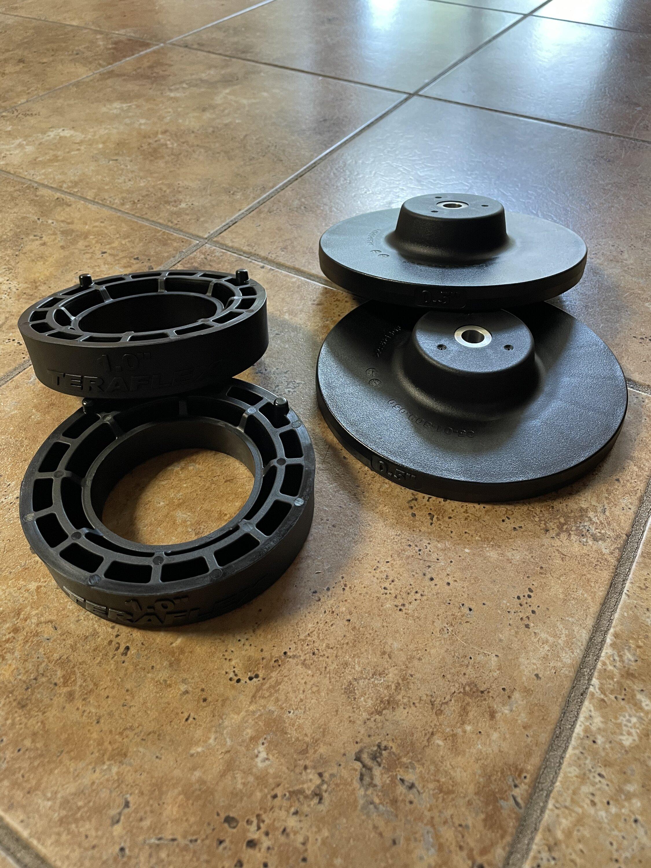

I just called them direct when I got them. I couldn’t find a part number anywhere online, but they were happy to help on the phone.
Thanks, I’ll give them a shout. Do you remember if the spacer went on top or bottom?

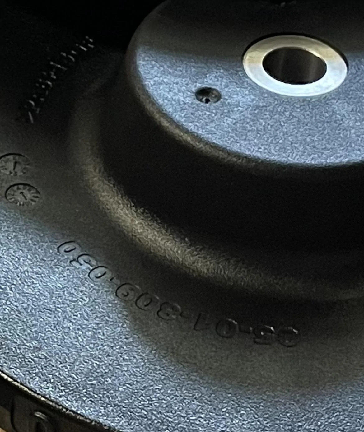

Jeep Gladiator Teraflex 1.5 Inch Front Leveling Kit 0D1A2381-3CDC-402B-949F-0962CEB7CFCF
Part # perhaps. I can’t make out the first number, it’s either a 3 or a 0.
x5-01-309-050
