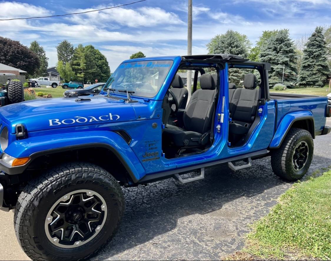

Don’t know if this will help you any or not, but here’s my 80AE with 34s and just the 1.5” Teraflex spacer.
Nice. Those tires fill the wells nicely. Any rubbing at max articulation?

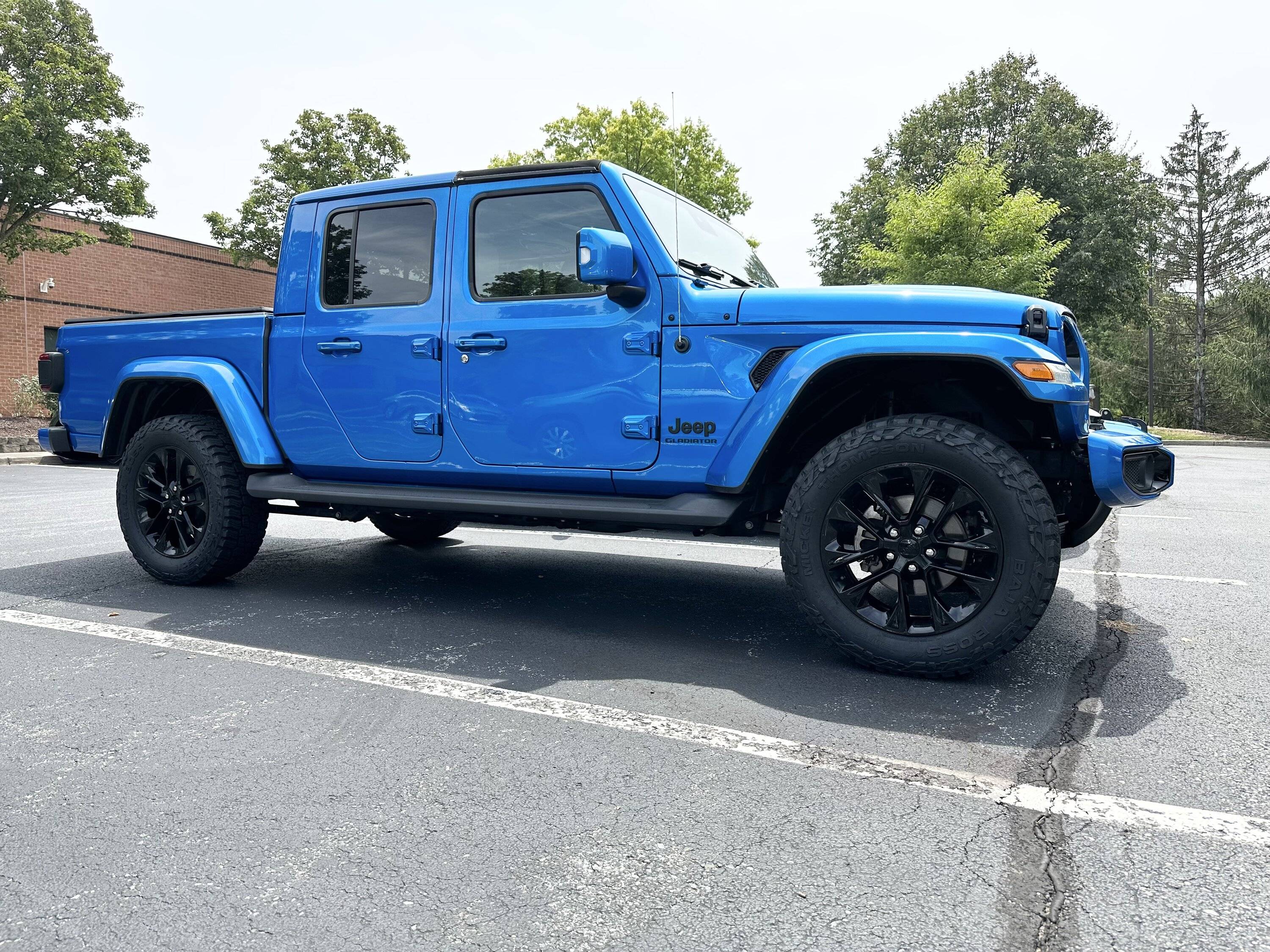

I did the 1.5 teraflex kit with mopar lift LCAs on 33 tires. It drives pretty well. There is a slight pull at highway speeds. I’m planning on upgrading shocks, steer smarts track bar and getting the fox ats stabilizer. It’s totally driveable without all of that, but I’m very picky on steering and those are the parts I had on my JL that helped tremendously. I don’t think you’ll need the additional .5 spacer in the front or .75 in the rear unless you plan on running heavy bumpers/winch. I always prefer a tiny bit of rake in the front so you aren’t squatting if you load up cargo.

I do not feel any negative difference, feels a lot better actually - I am running Mickey Thompson Baja Boss A/T tires (on stock wheels) in SL rating though, so not nearly as heavy as an E rated tire. Still hits 8th, feels more planted, gets up and goes.

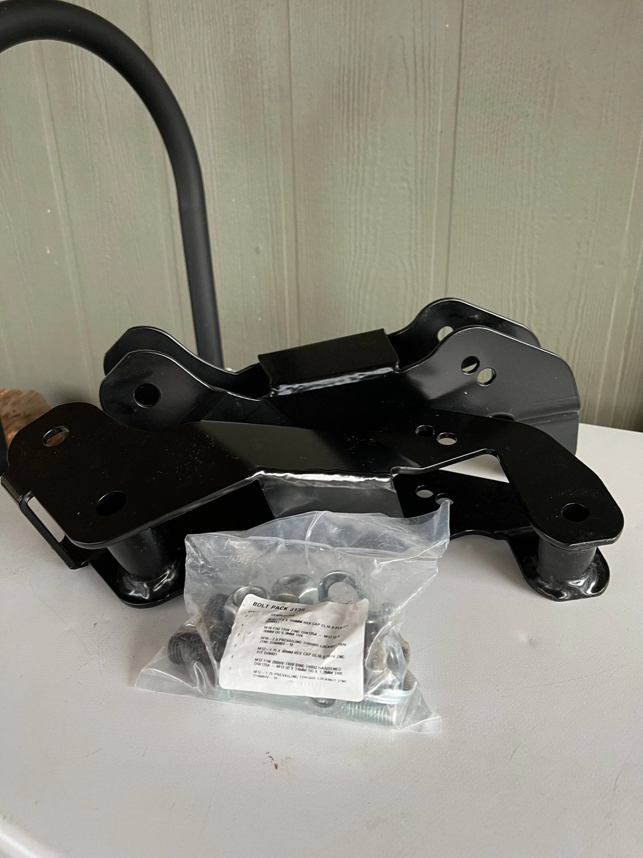

Received the JKS Geo brackets. Wow! This things are huge and beefy. Wait, that didn't come out right. Sturdy and big. ?, heavy metal? Never mind!
