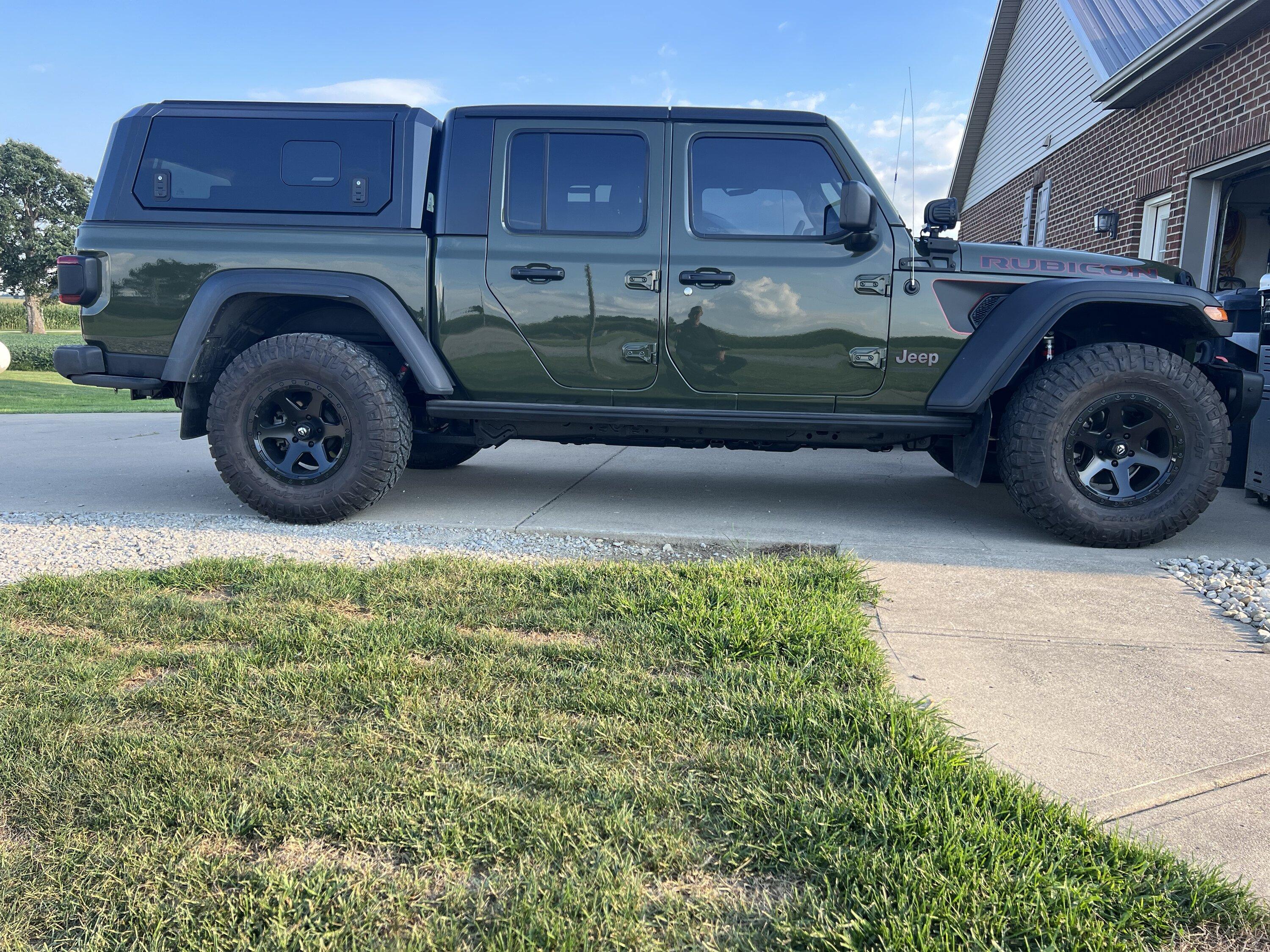

I installed these lower arms over the weekend with the level kit. Really glad I did. Vehicle feels very good. Not sure if it’s in my head but feels like it tracks a little better on highway. 35’s going on this weekend.

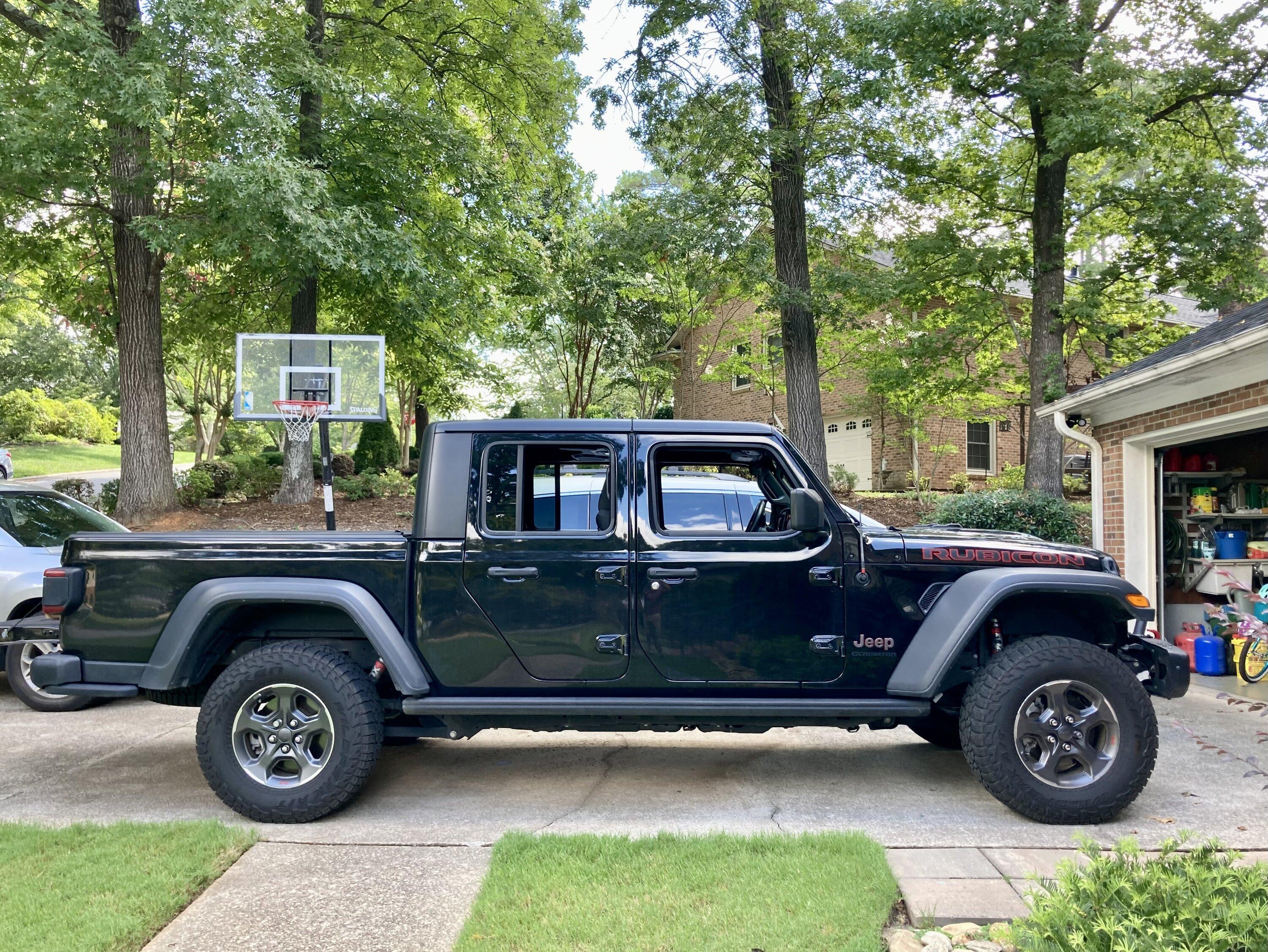

I recently added Fuel wheels, 35” Nitto Ridge Grapplers and MOPAR Performance lower control arms. The result is a ride that is at least as good as stock if not better and tighter steering. I believe that this was money well spent.
