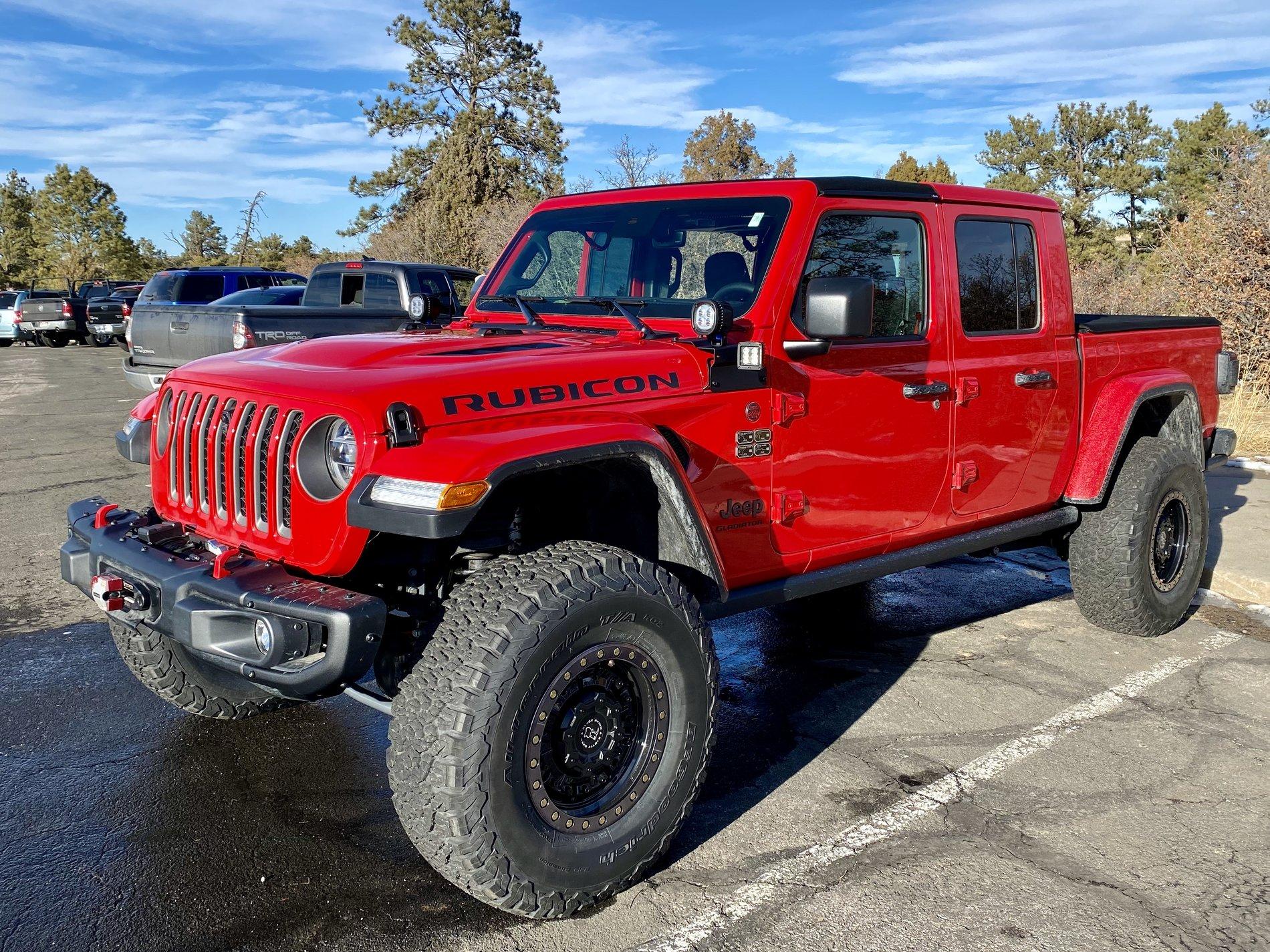

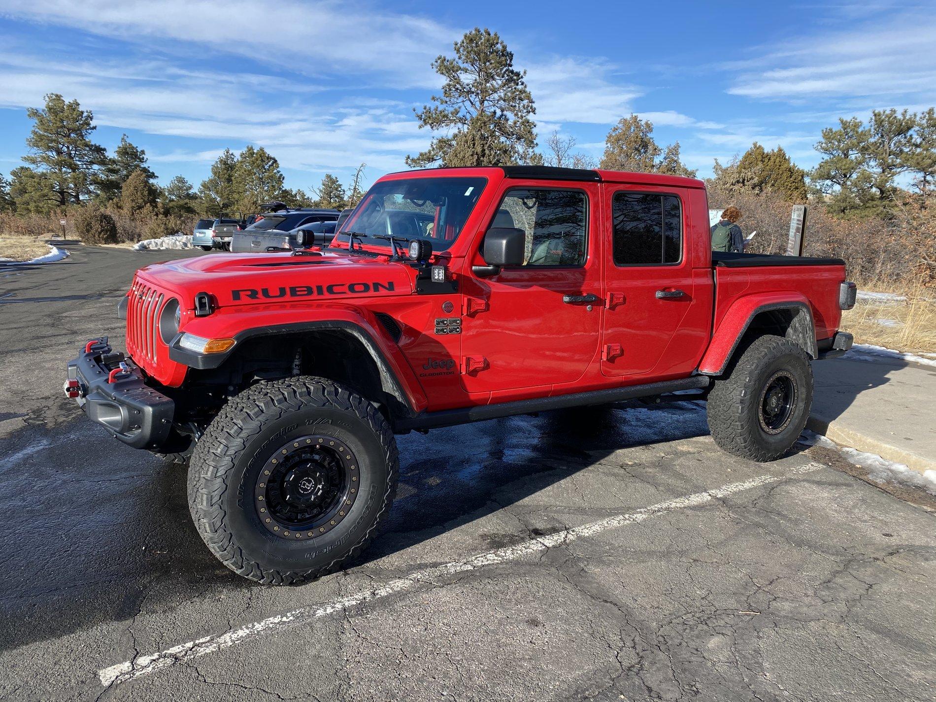

Jeep Gladiator Teraflex 1.5 Inch Front Leveling Kit 1A556766-D85E-4ED1-94FA-20307457738E
Jeep Gladiator Teraflex 1.5 Inch Front Leveling Kit 2BB5F993-A7F8-40A4-8CAA-720DE847123C
Mopar 2”, Terra-Flex 1.5” on 37’s, and 12k winch.
