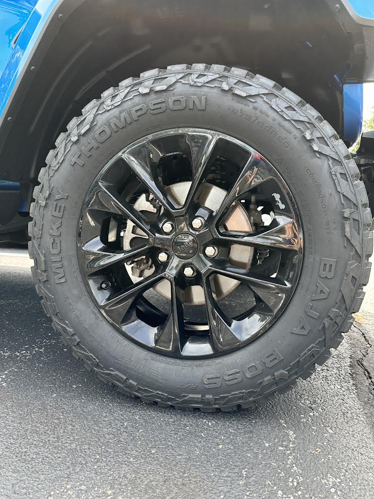

I have those tires on another vehicle after having the st maxx cooper on my JKU - love them. What size are you running? I would like to upgrade to those - i don't see any std load 33s though. Thanks-
275/60r20 - 33.4 (32.9/33 loaded). I wanted to keep the stock wheels. I’m not sure what they offer in r17 options.

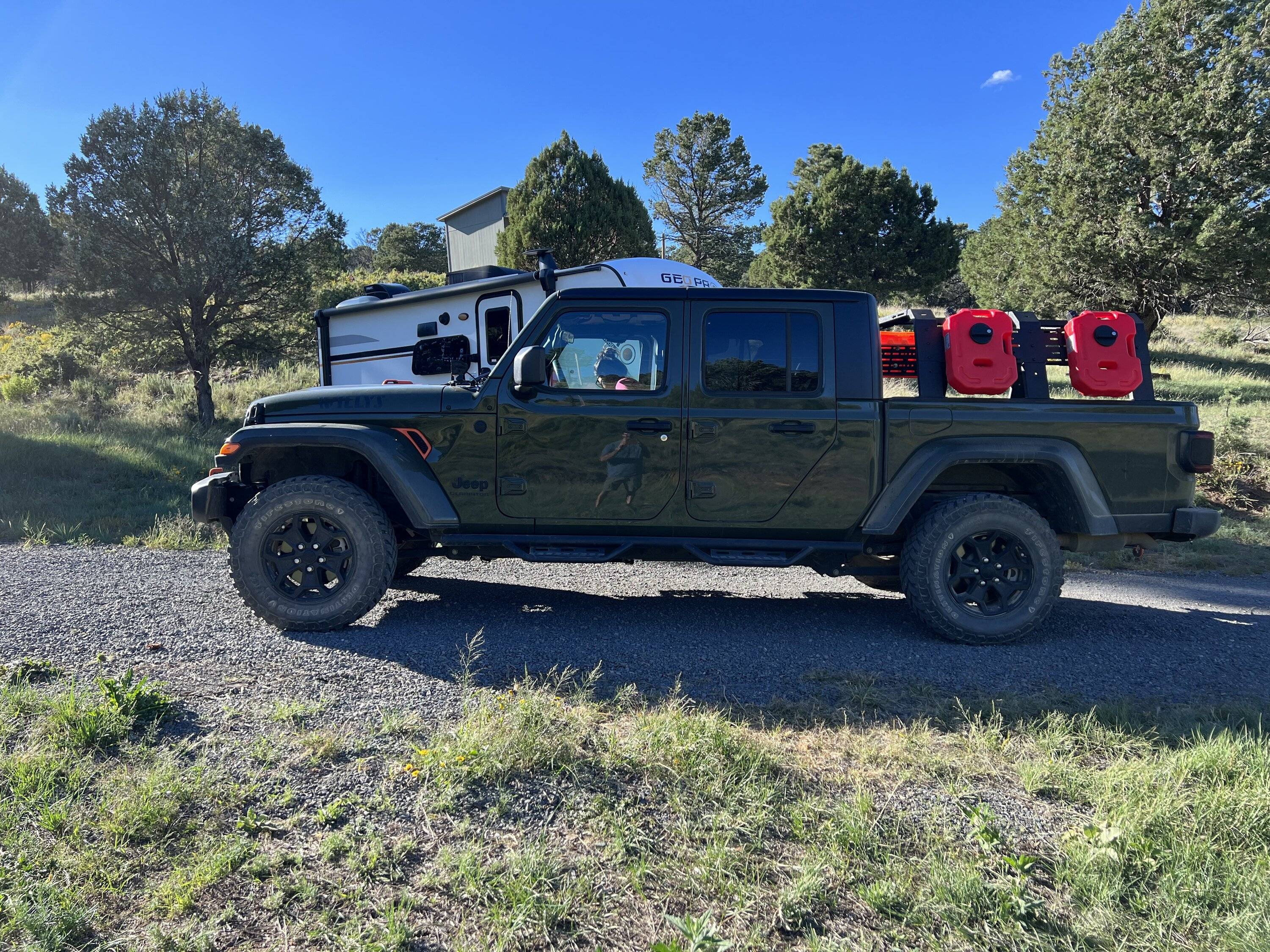

What do you think about the way it looks with the 32s?

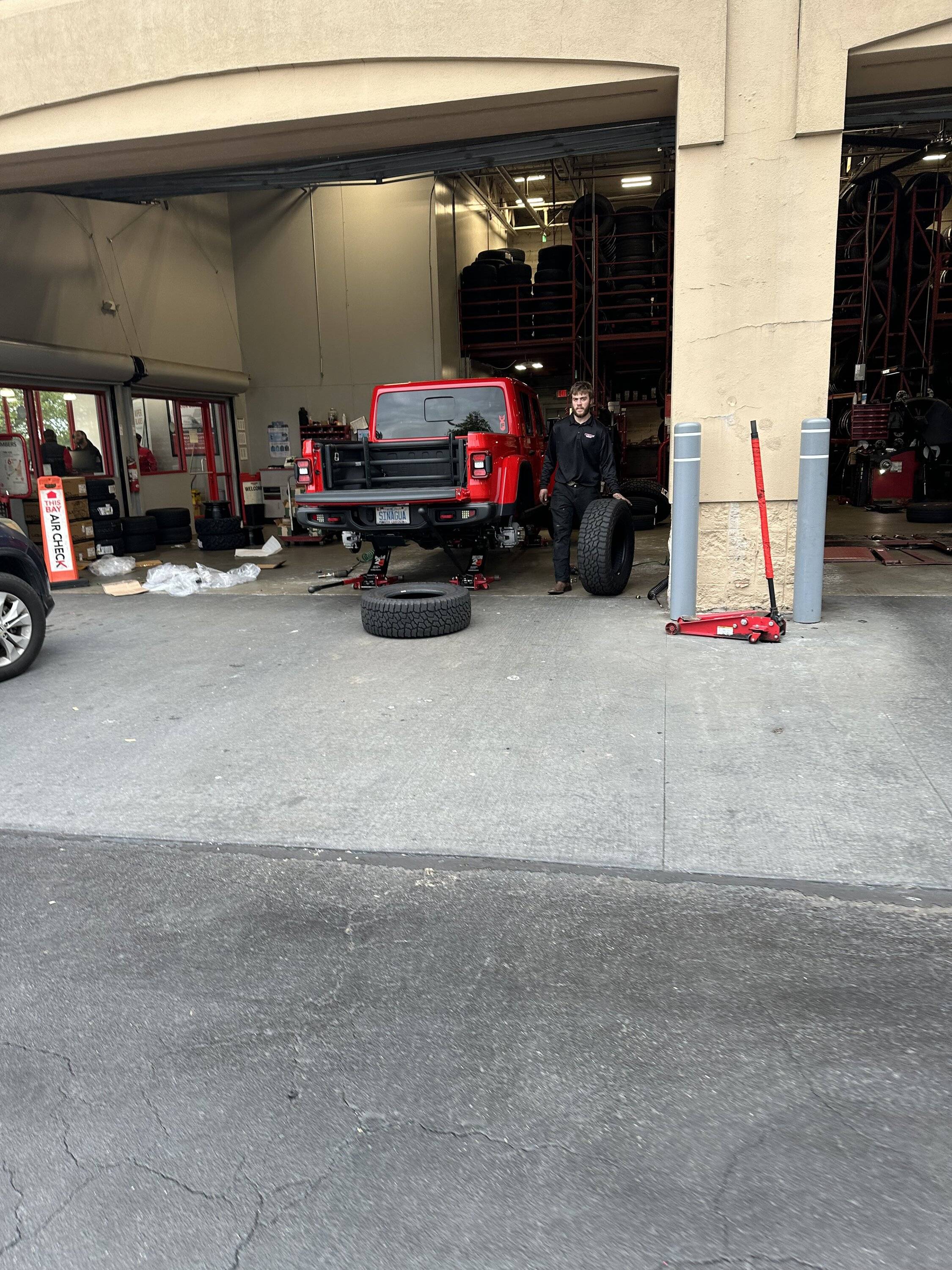

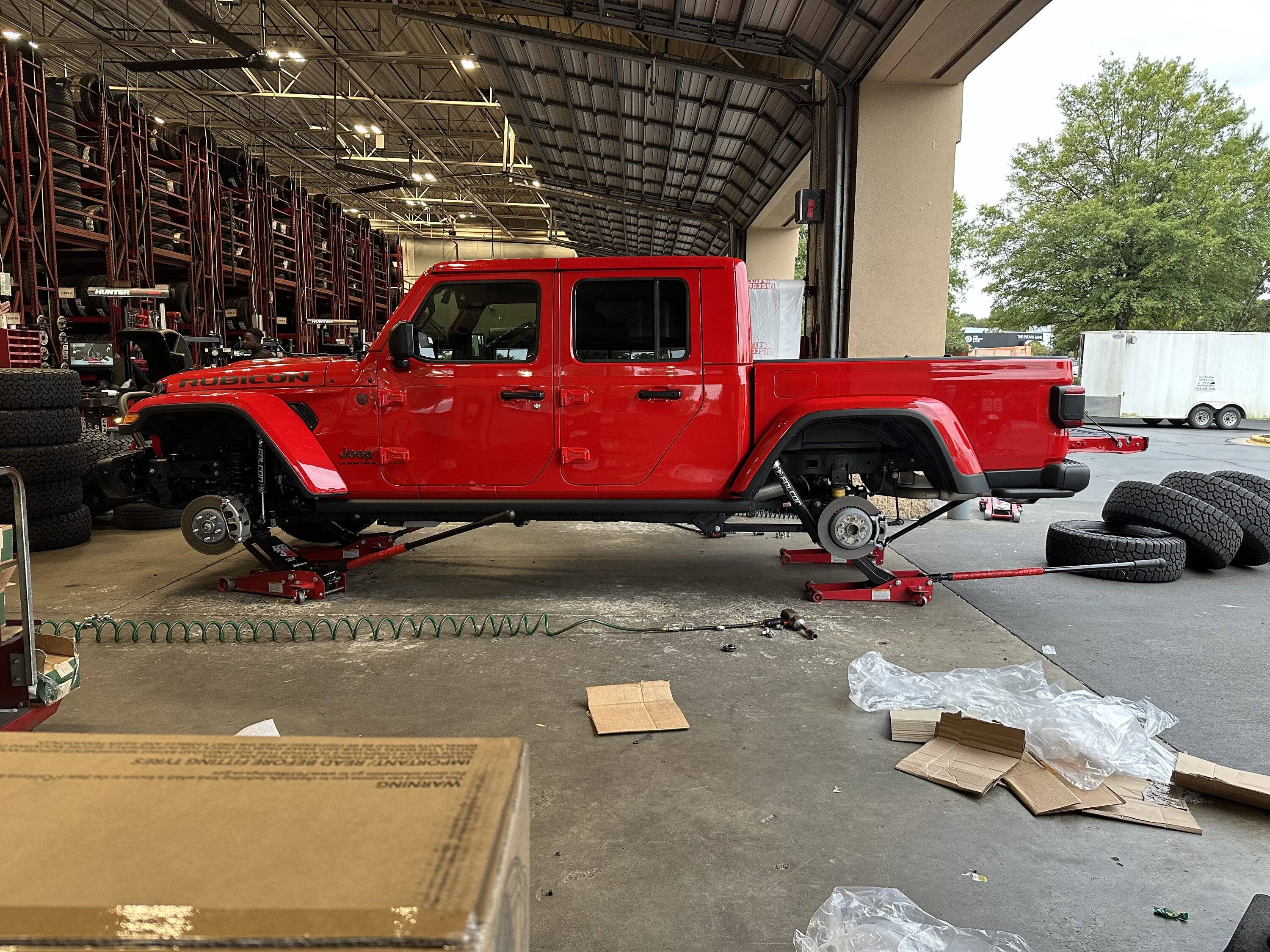

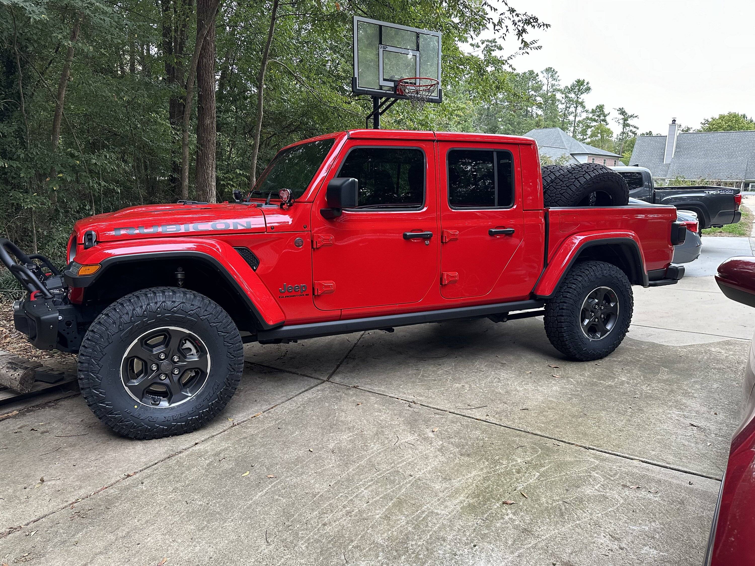

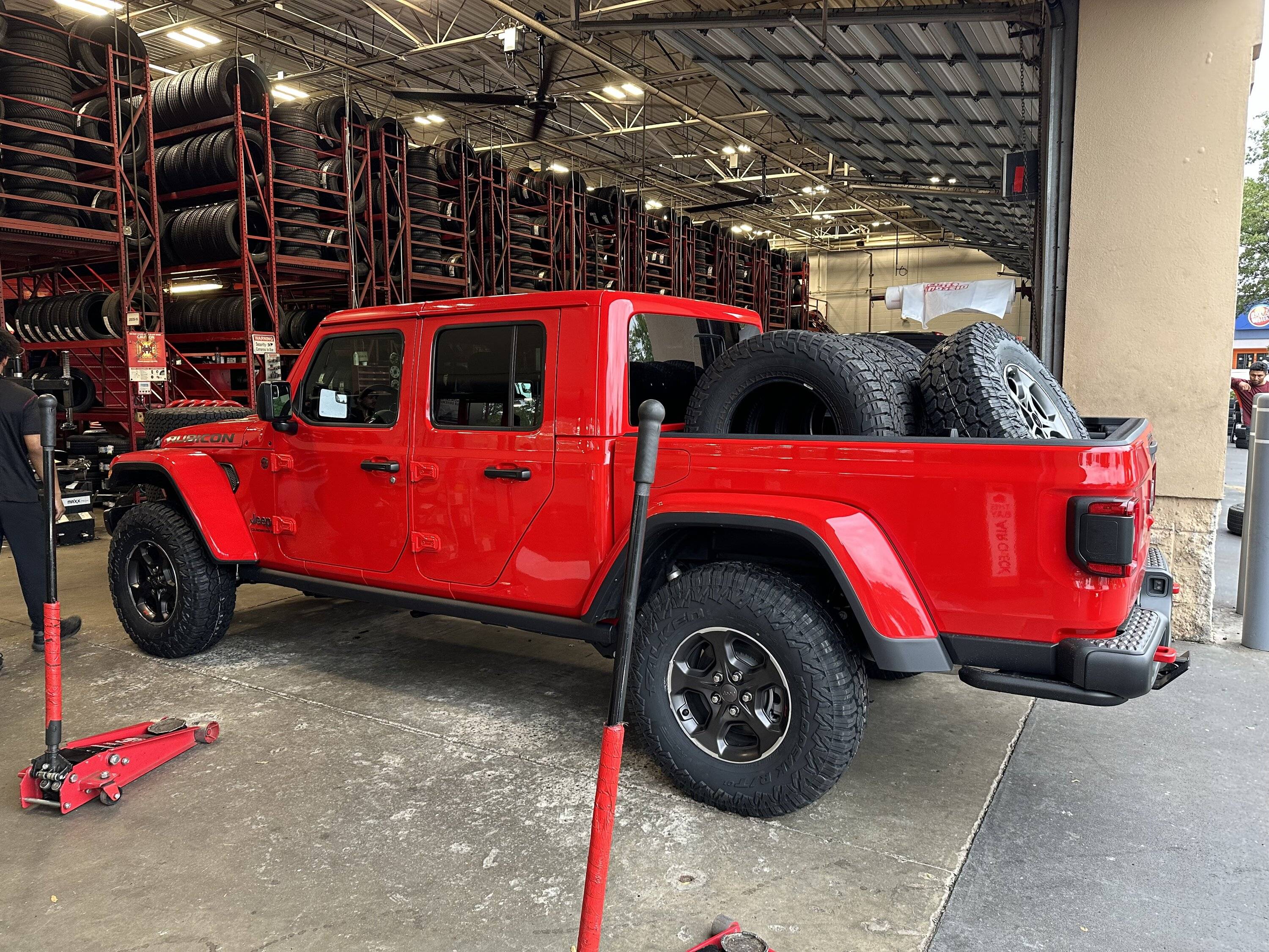

I put my Teraflex 1.5” kit on over the weekend on my Rubicon and just added a set of Falken RT01 35’s this afternoon. Drives great! Not a noticeable difference in power.
Looks like @ DiscountTire, Love that place!
Same here! Grew up in the Phoenix area and have always used Discount Tire! Joe here on the forum was of great assistance to arrange everything.
Set up the appointment yesterday and arrived today for the appointment and was in and out in an hour!

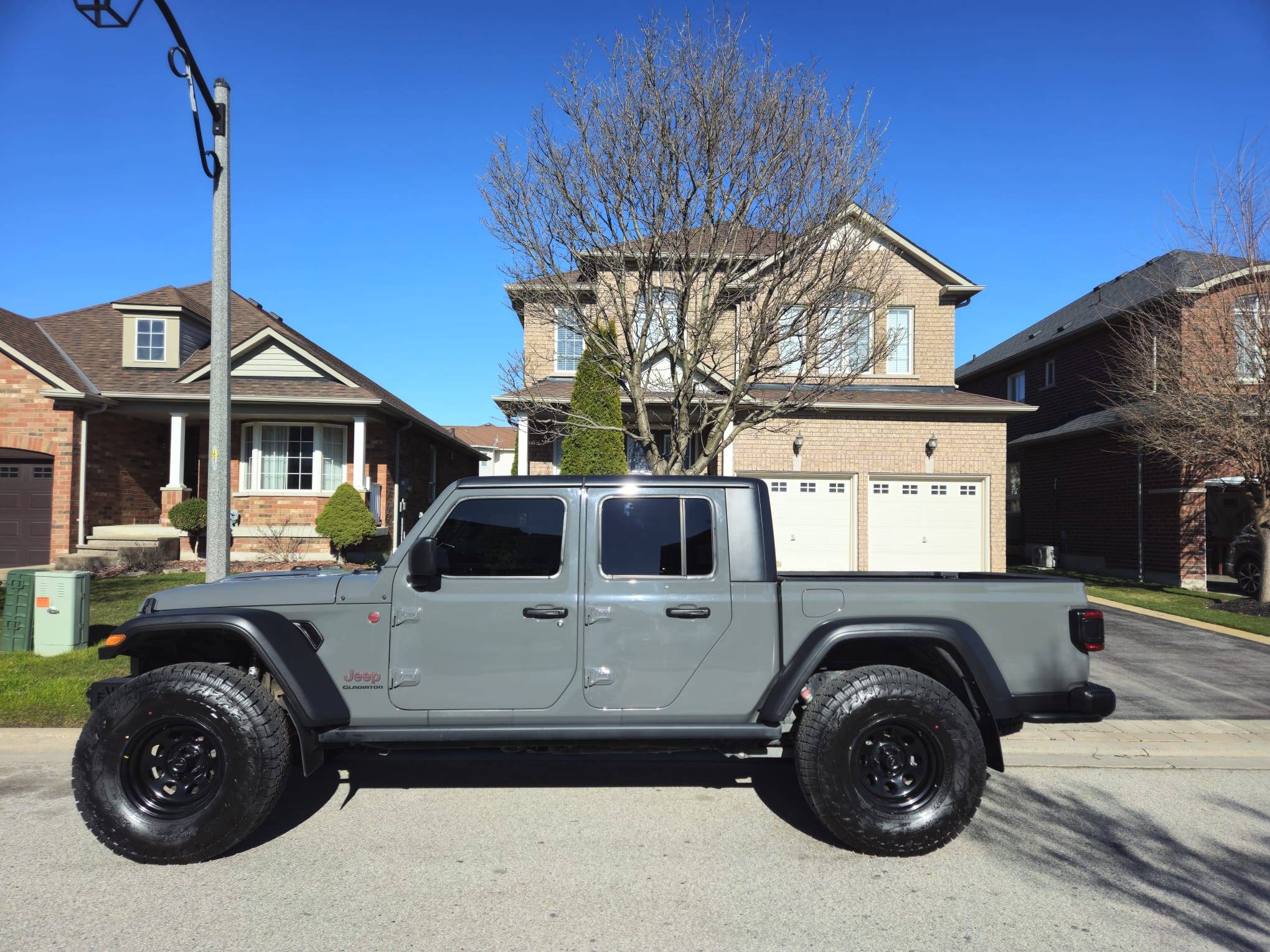

RoamingGladiator
Jake
Mar 21, 2024
254
398
Canada
2021 JTR Diesel
Probably going to do the same to my new to me Rubicon since I traded the Willys last Monday. I'm contemplating stacking TF spacers to get 2" up front and add Daystar 3/4" to the back (already have them laying around). I would do an adjustable track bar since I can't stand the axle shifting to the right looking from the inside. I have JKS geo correction brackets that I didn't use the last time since I left it at 1.5" in the front for the Willys. Do you think stacking spacers to 2" is a bad idea? I'm in the middle of home additions and finishing our guest house and I really can't divert money to a full blown 2" lift with springs, etc. I'm planning on going up to 35" since I don't want to re-gear the Rubi.
You will always regret being cheap on suspension components, at least in my experience. The Teraflex 1.5" gives you a nice level with very little rake (Almost none on a JTRD). You also should not be using geo correction brackets until you're over a 3" lift, unless it's a pavement princess then you're fine.
Below is a picture of a JTRD on 37s with a Teraflex 1.5" Leveling Kit. You don't need an adjustable trackbar with this type of setup. Though you'll eventually wind up replacing the front steering anyways with larger tires, the factory stuff isn't a fan of it long term.
The Teraflex 1.5" on a Rubicon can fit 37s if staying on the road, and 35s very comfortably.
Jeep Gladiator Teraflex 1.5 Leveling Kit Questions WhatsApp Image 2024-04-06 at 17.12.03_bd862120
