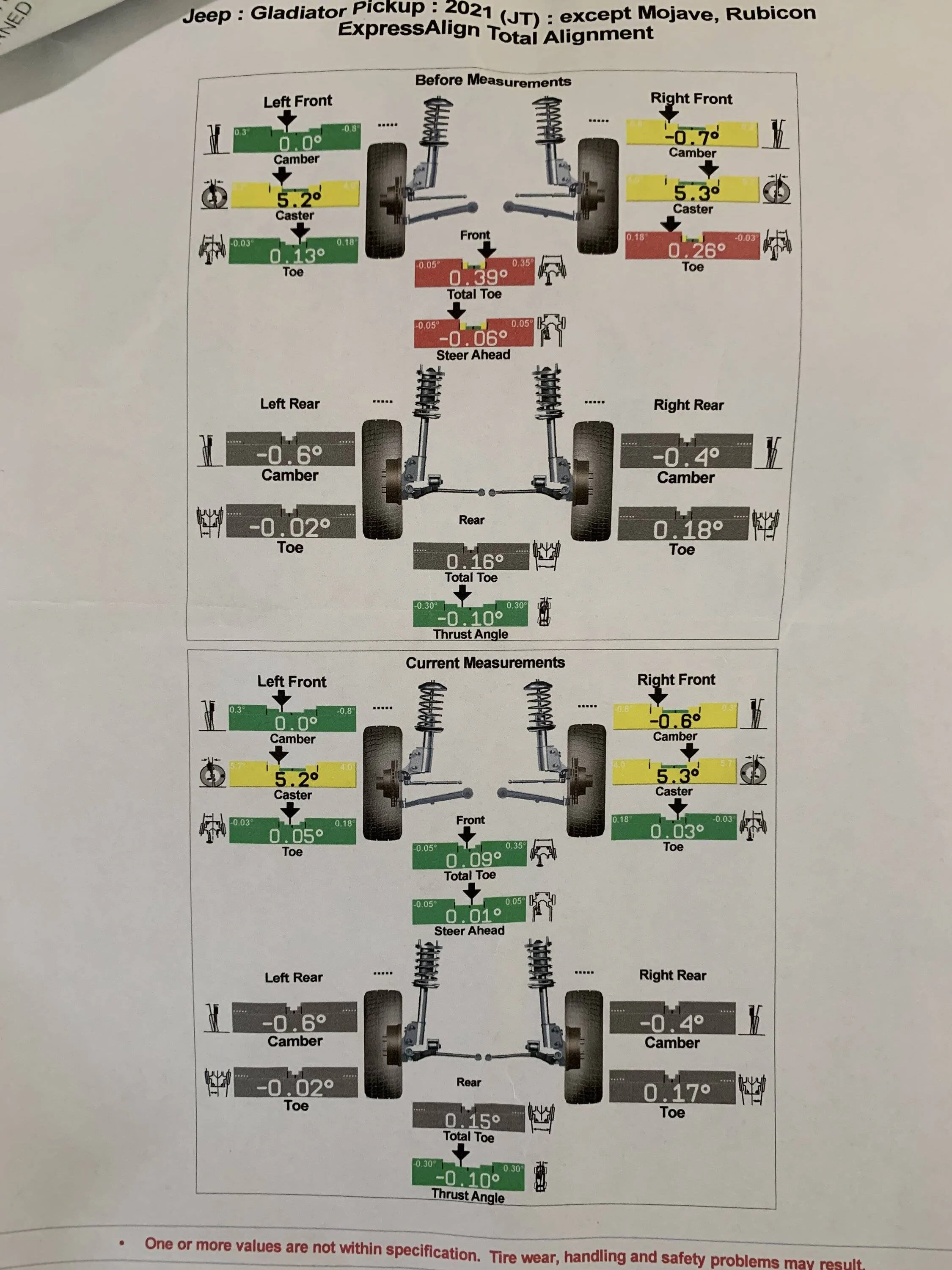

Installed this combo, TF 1.5 spacer and Mopar LCA for 2in lift, and following install had a bit of a pull to the right/passenger side. Rather than messing with the toe myself I found a coupon for Belle Tire $64 for 1yr unlimited alignments. They set toe at the values in the lower half of picture attached. It’s been a few weeks and the pull is gone but I’m consistently feeling a slight shimmy over bumps that was never there before the spacers and alignment. Have gone over all the bolts again and the they are to torqued to spec. Didn’t check before the install for the factory toe setting, but thinking my toe should be set further in. For those who have done the same TF 1.5 spacer and Mopar LCA, to what degrees do you have your toe set? Next trip for alignment I want to tell them exactly the setting to calibrate. Thanks in advance.
My guess would be bump steer caused by caster from the Mopar LCAs that weren’t required for the leveling kit.
You need more caster, I have 1.5” front spacers and Mopar lcas, I still had what felt like the verge of death wobble on certain bumps, installed Rancho geometry correction brackets on the lowest setting, upper control arms in top hole, completely eliminated it and drives much better.
40,495
54,056
Naw, caster is ok. I've run those lower control arms with NO lift, and a lift as small as 1.5"
Positive caster won't cause bump steer. Too much caster can cause caster WOBBLE.
Looks like he's barely out of specs, hardly at all.
I'm sitting 1.5" higher than stock up front now with the Synergy springs, I have the longer MOPAR lift kit lower control arms and it handles great. No wobble, no shimmy, drives perfectly up to 95 mph. Bumps don't bother it at all.

Thanks for your feedback. I’m also inclined to think the minor amount of extra caster added isn’t the problem given how low it is from the factory and multiple others who have done this exact same setup with no issues. I am going to try having the toe set to ~26 degrees overall or around 13 degrees each wheel, then see how it goes before trying anything else. Want to stay pretty close to stock since it is still under warranty and my Glad was dialed in pretty well suspension wise from the factory, excluding occasional bottoming out from the diesel engine weight up front.

Having the toe set to ~26 degrees total has mostly eliminated the issue, tends to track even more straight now as well. Overall happy with the value, look, and feel now that it is aligned properly. Lesson learned, slight toe-in (25-30degrees total) with this set up is the way to go:like:
