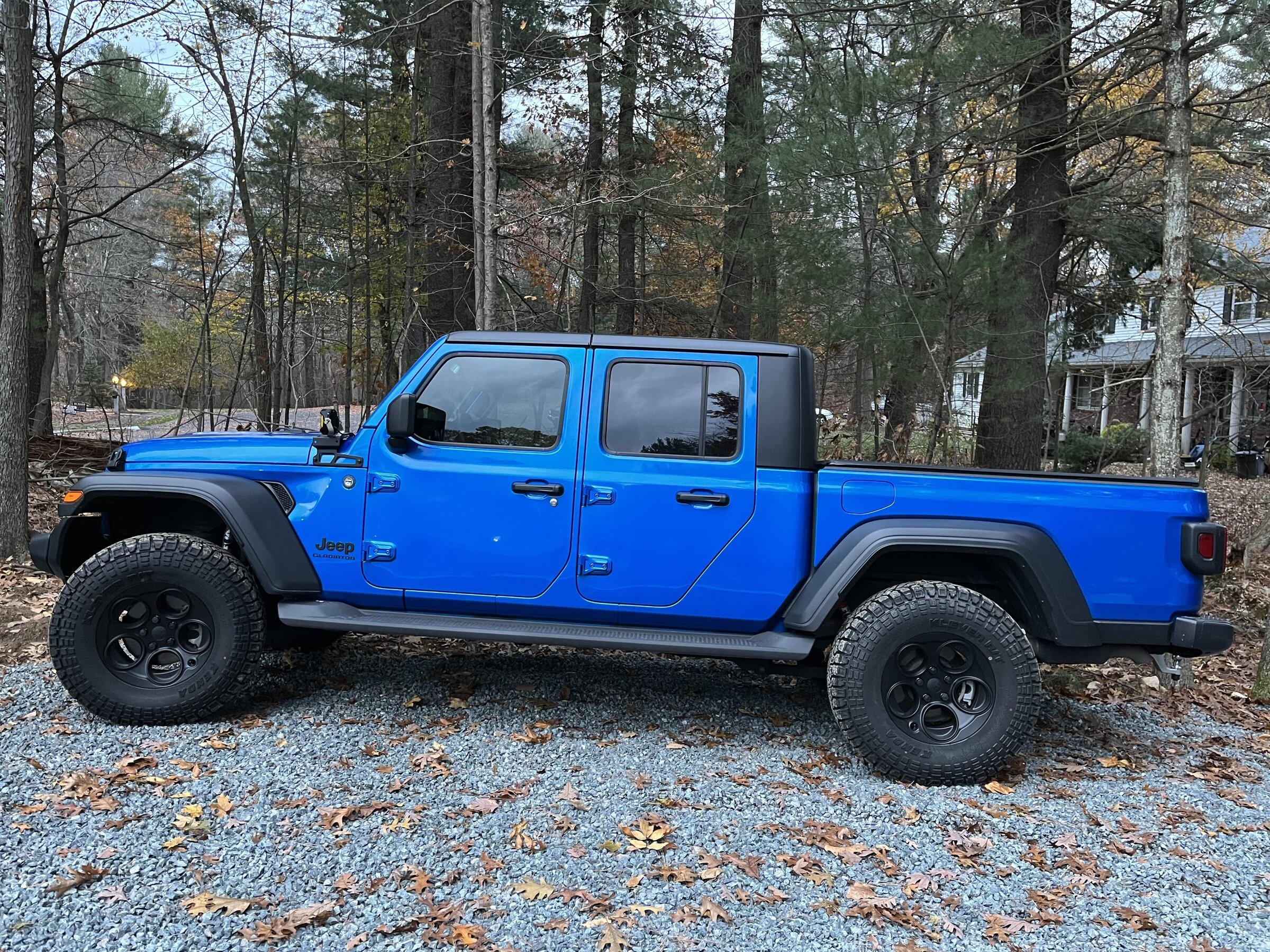

Not a direct comparison as the Rubicon has higher front fenders. This is my sport with 340, 343 front springs, Daystar 1.5” front and .75” rear spacer. I also have the Mopar LCAs, 2” Rubicon Express front shock extensions and Daystar coil spring correction pads. The Mopar LCAs are definitely worth it.

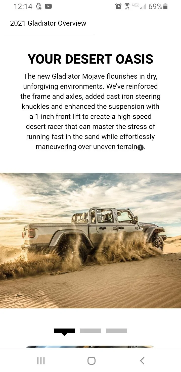

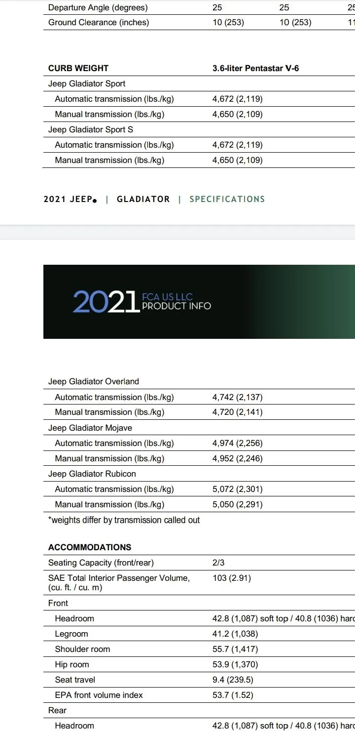

Thats simply not true. Find me something/anything from Jeep (not some forum post) that says Rubicons come with a lift. They advertise it for Mojave, nothing for Rubicon. According to FCA, the Rubicon weighs 400 lbs more than the Sport. Add oem options like steel bumpers and its even more. The difference /lift achieved, when used on other trims, is the result of a spring with higher spring rate (meant for a heavier vehicle) being used on a lighter vehicle.
Rubicon's do indeed have a lift, there is nothing inherently heavier upfront about a rubicon other than its tires and the swaybar motor upfront. Hence why rubicons gain less lift from spring swaps when measured. The mojave has an additional one inch on the rubicon so they are between 1.75-2" taller than an equivalent weighted sport.

Thats simply not true. Find me something/anything from Jeep (not some forum post) that says Rubicons come with a lift. They advertise it for Mojave, nothing for Rubicon. According to FCA, the Rubicon weighs 400 lbs more than the Sport. The difference /lift achieved, when used on other trims, is the result of a spring with higher spring rate (meant for a heavier vehicle) being used on a lighter vehicle.
Oh boy this reminds me of the facebook posts that swear the mojave is the only one with the 10.5mm axles in the front too because its the only one "advertised" with them.
First, multiple separate people have done the axle to body measurements, the rubicon is taller than the sport/max tows. Second, the caster spec on the rubicon from the factory is lower to account specifically for the taller suspsension which lowers the caster by ~ .5 of a degree stock. Lastly, the simple physics of springs indicate by your own argument that the rubicon has to be taller.
The springs have been shown to be longer by about an inch and have been measured at a heavier spring rate (except for Max tow). The rubicon has spring rates of 150 or so infront, and 185 in the rear assuming an even split of the 400 lbs, means you at most lose .5-.6 of an inch. The falkens weigh ~70 lbs a piece though compared to a sports ~30 lbs so 150+ of that isnt suspended (rounding down because its not exact 70 or exact 30), and you lost 1/3 of an inch. The 5th tire is firmly behind the rear suspension which would actually pull the nose up, so upfront you're down maybe .25 of an inch then. Voila, the simple physics of it indicate that the rubicon would then be the 3/4+ of an inch taller that the measurements matched, that the sports folks see, and that the caster spec indicates.
So no, i cant find where mopar specifically says the rubicon is taller because they dont advertise a specific lift for them upfront like they do a mojave, but there is no behind the curtain stuff going on here, the rubi's are taller because the rubi springs are longer and stiffer for an only slightly heavier vehicle.
Edit: The mojave's caster specs are actually even lower than the rubicon's to account for the extra height of them as well.
