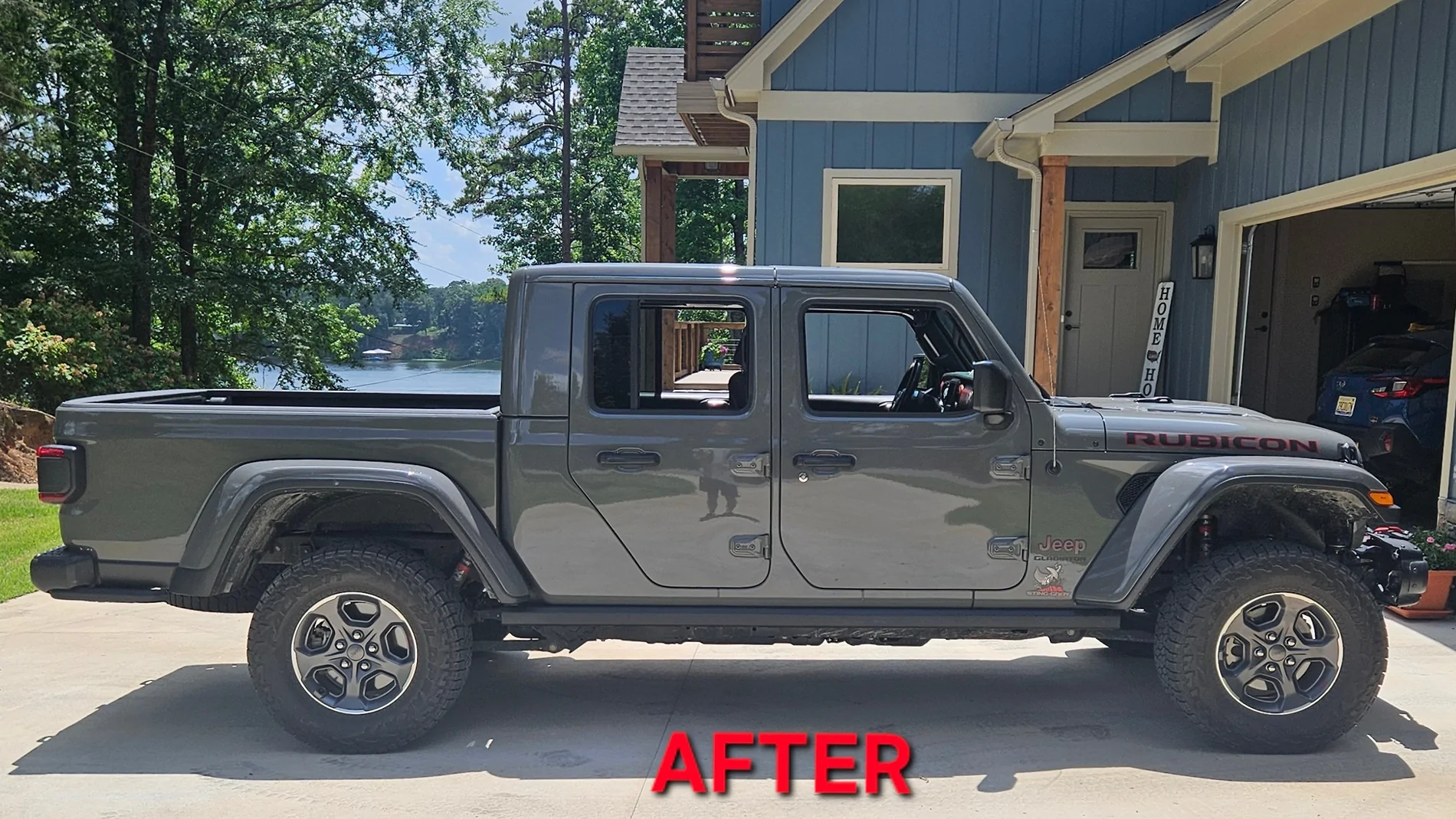

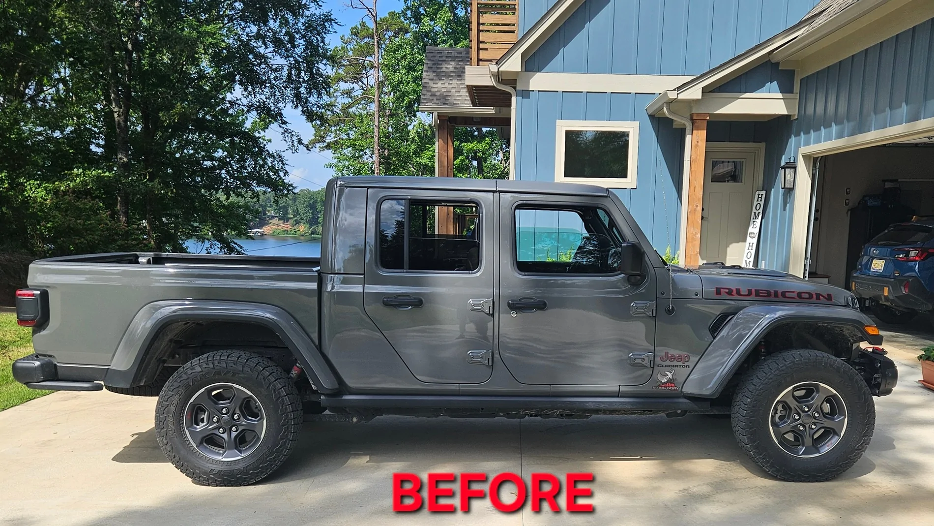

Installed a winch/winch plate on my JTR back in May. The 60+ pounds dropped the nose approximately 1/2" which accentuated the rake, so I decided it was time to level it up a bit. Ended up going with the Teraflex 1.5" Spacer Leveling Kit and also decided to go ahead and install 1/2" spacers on the rear to maintain a little rake. Simple 3.5-hour solo job with 2 jack stands, a floor jack, and old fashion (non-electric) wrenches/rachets. Instructions state to loosen the control arm bolts, but I decided to not mess with those (and the associated retorquing) and didn't have any issues. Used a rachet strap to help get the track bar holes lined up as I had seen in a video - simplified that process. Now the 33" tires look too small :facepalm:

Did you need to adjust the steering wheel? I made the same changes to my JT and the steering wheel needed to be adjusted.
Yes, had to adjust steering wheel. I think I turned the adjuster ~3/4-1 turn on the first try which was an overshoot when I test drove. Had to back the adjuster off ~1/4 turn (if I remember correctly).
