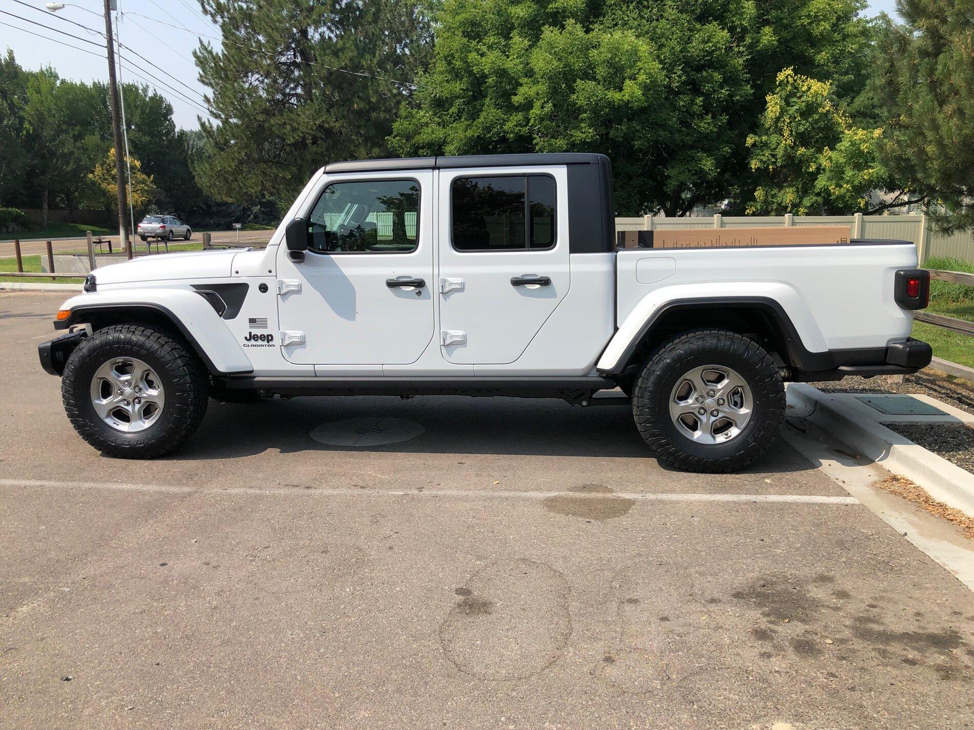

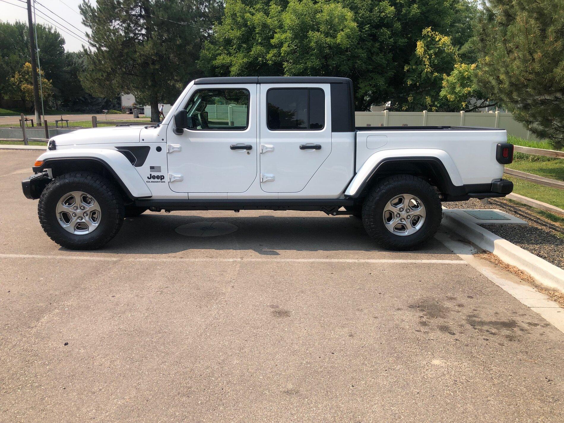

Very nice. I'm literally going for that exact same set up.

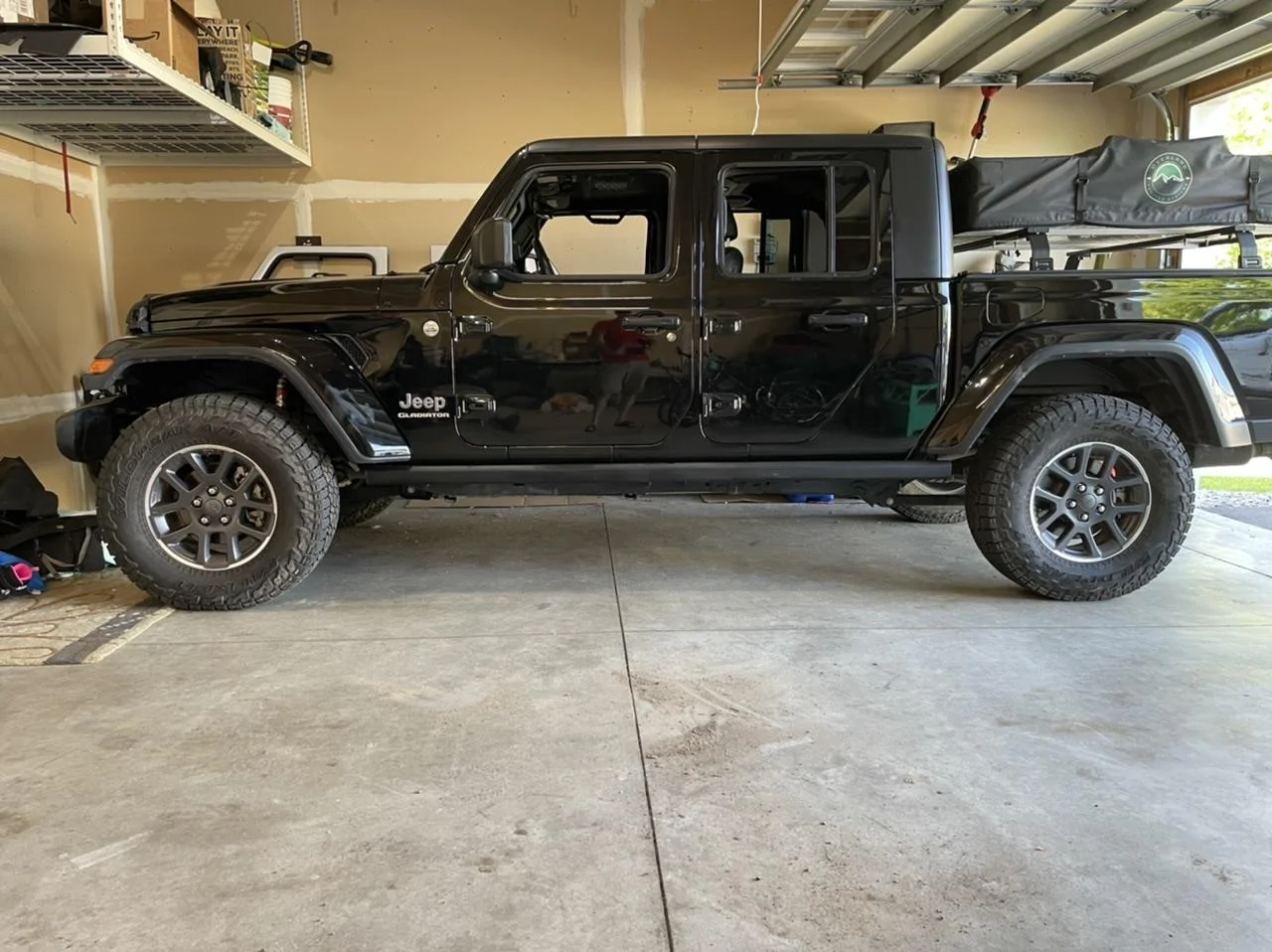

Just got my 295s although I went with Coopers which I love. Only difference is I'm on the fence about maybe adding a 1.75 wheel spacer since the 295s just don't give the amount of poke naturally that I'd like, considering I too kept the stock overland wheel.
They just poke past the fenders, so if your going for a bit more stance you will need spacers. I thought about it, but my preference would be just another inch, and 1” spacers require cutting wheel studs and that was enough for me to just leave it as is.
(Picture is pre-lift)

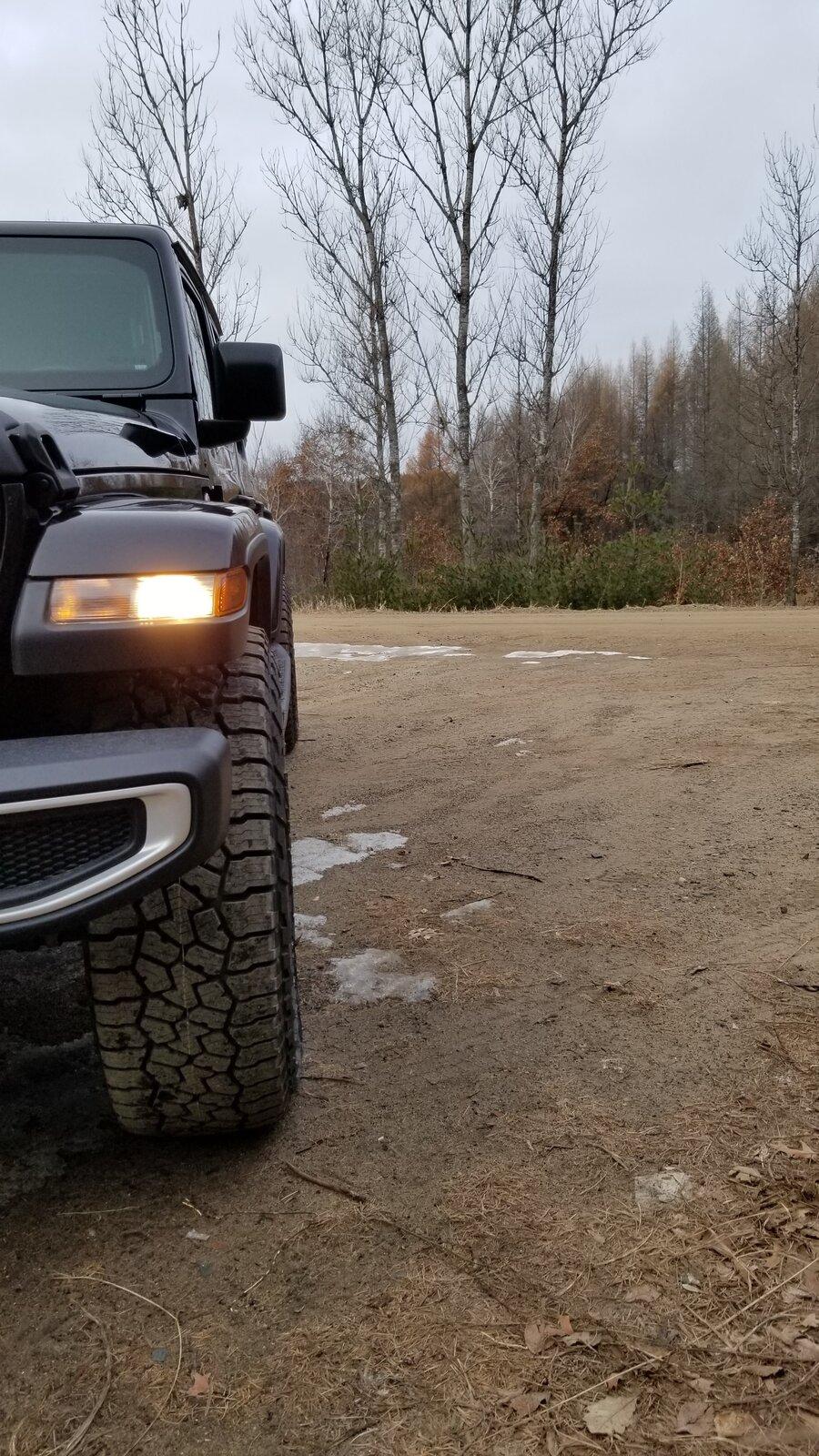

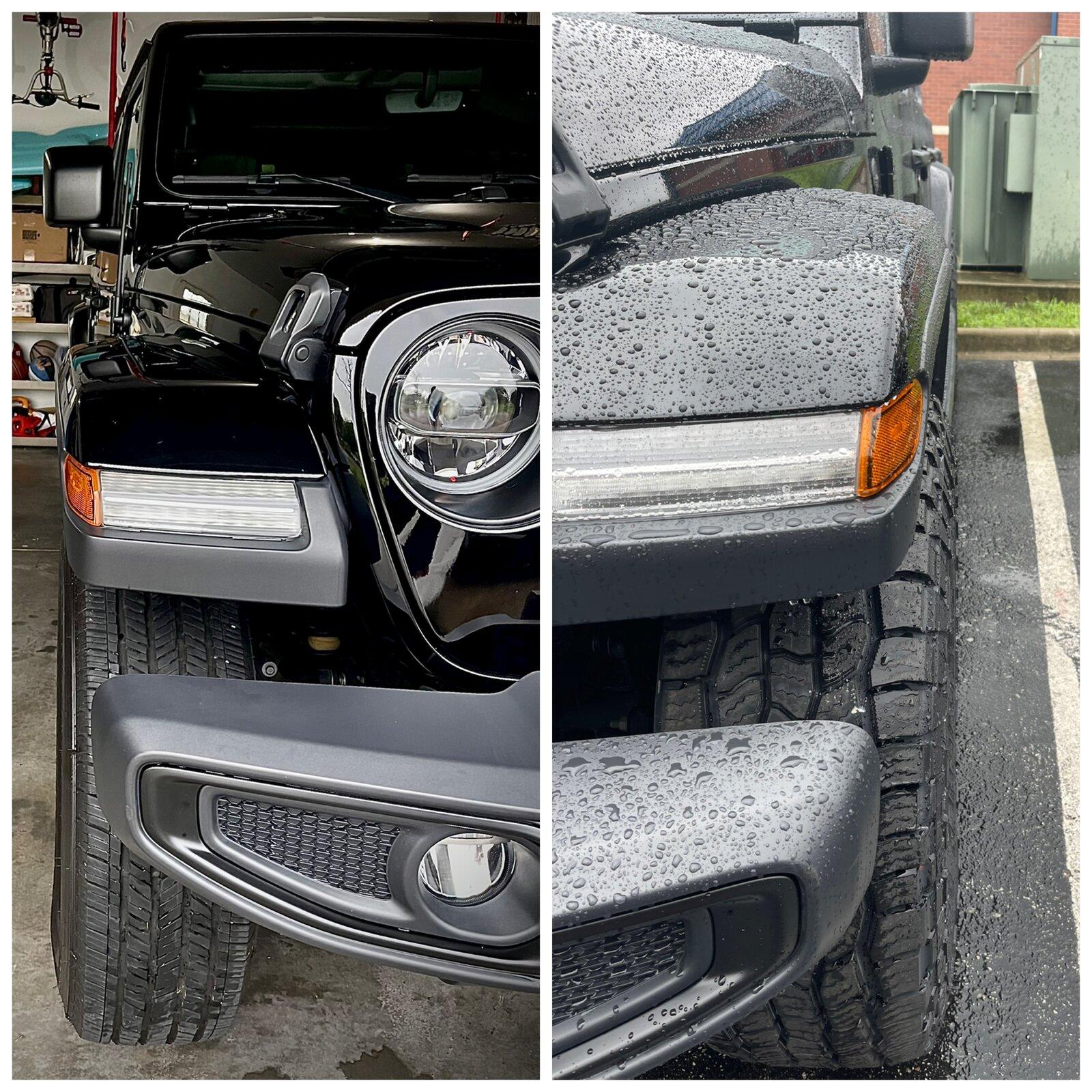

Not sure if it’s the angle or just the Falken tires you have but yours look like the poke just a tad bit more than my Coopers. Not bad actually. Maybe if mine were like that, I wouldn’t be considering a spacer. I’m so on the fence about it.
before /after 295s
Jeep Gladiator Teraflex 1.5” leveling kit on JTO ? B25EBF30-3AC6-4619-8BE9-C5D6AC130D82
After

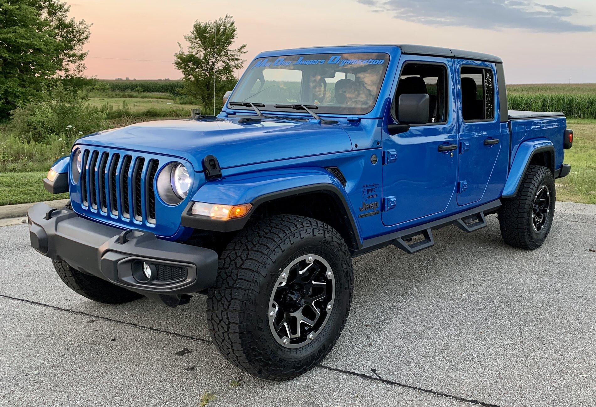

So I don’t just have the teraflex leveling kit . But I would recommend swapping the stock overland shocks for some rubicon take offs. Low cost, they get you the extra length, and handle rougher roads more smoothly and reduce bounce in the rear.
295/70r18 Falken Wildpeak AT3w on stock Overland wheels.
Rubicon take off Shocks and springs.
Daystar 3/4” rear spacer.
The stock shocks on an Overland and the Rubicon shocks are the exact same length. The springs are the difference.

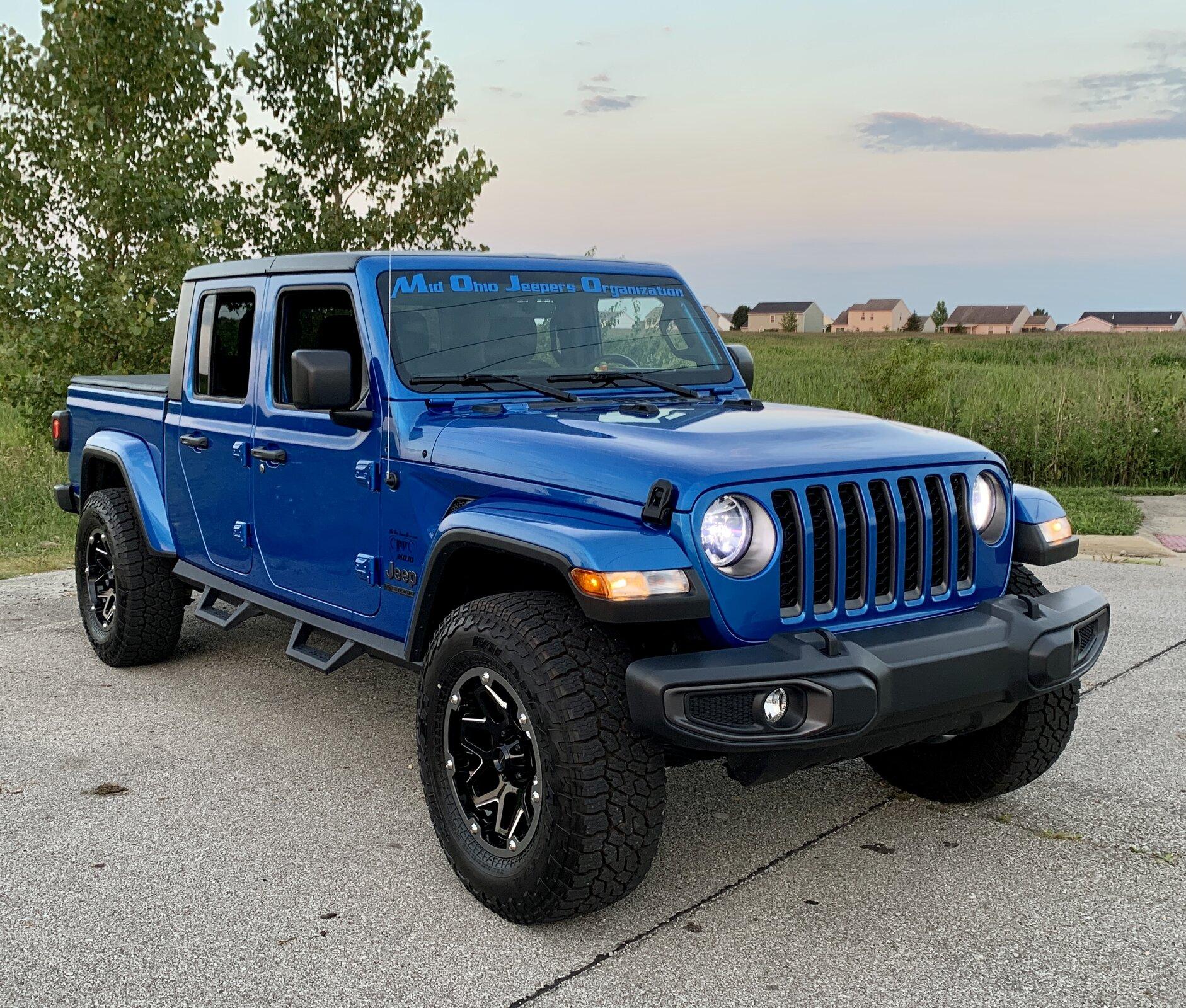

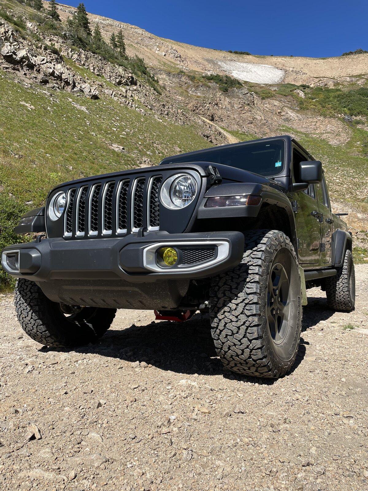

Another vote to include JTR takeoff shocks and springs along with your spacer install. This is my first Jeep as well, so I wanted to take the additions slowly to see what I liked and what I would need for the type of terrain the JT sees. I plan to scrap this setup for a real lift in the next year or so, but as long as the shocks don’t get floaty like some have reported, I’m very happy with the ride quality and increased capability.
‘21 JTO
JTRD takeoff shocks and springs
Teraflex 1.5 level
Daystar .75 rear spacer
315/70/17 K02s
