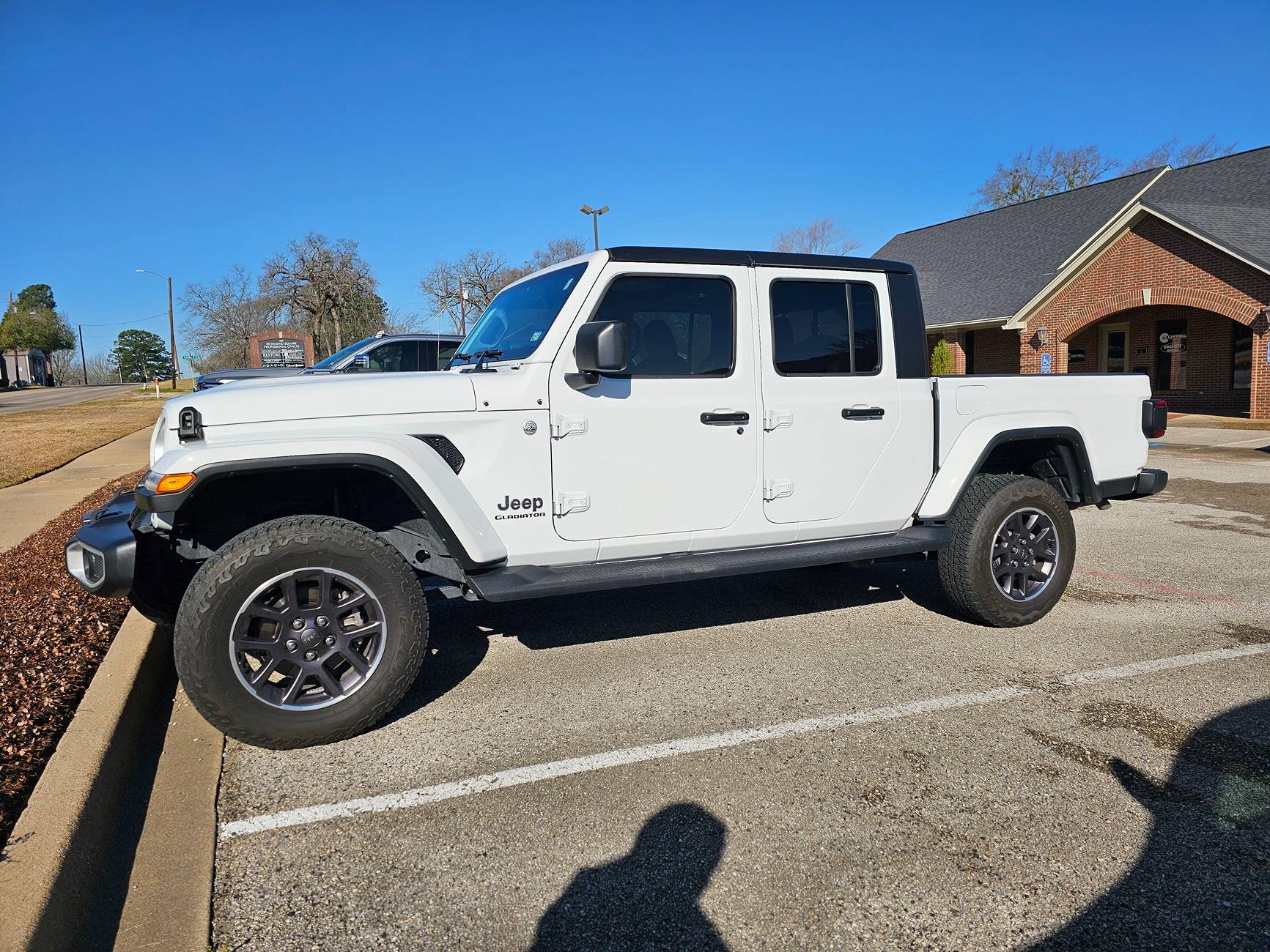

1.5" should level it. I've seen 2.5" front without any rear lift and that end up with negative rake. Also, the 1.5" leveler leaves more suspension travel for you versus the larger pucks using stock shocks, etc. Here is a photo of my Sport after the installing a Teraflex 1.5" kit, with my stock tires. (I've since replaced the shoes with 35" tires. Looks great with those, but I shared this because it looks like your tires are closer to what I had before.)

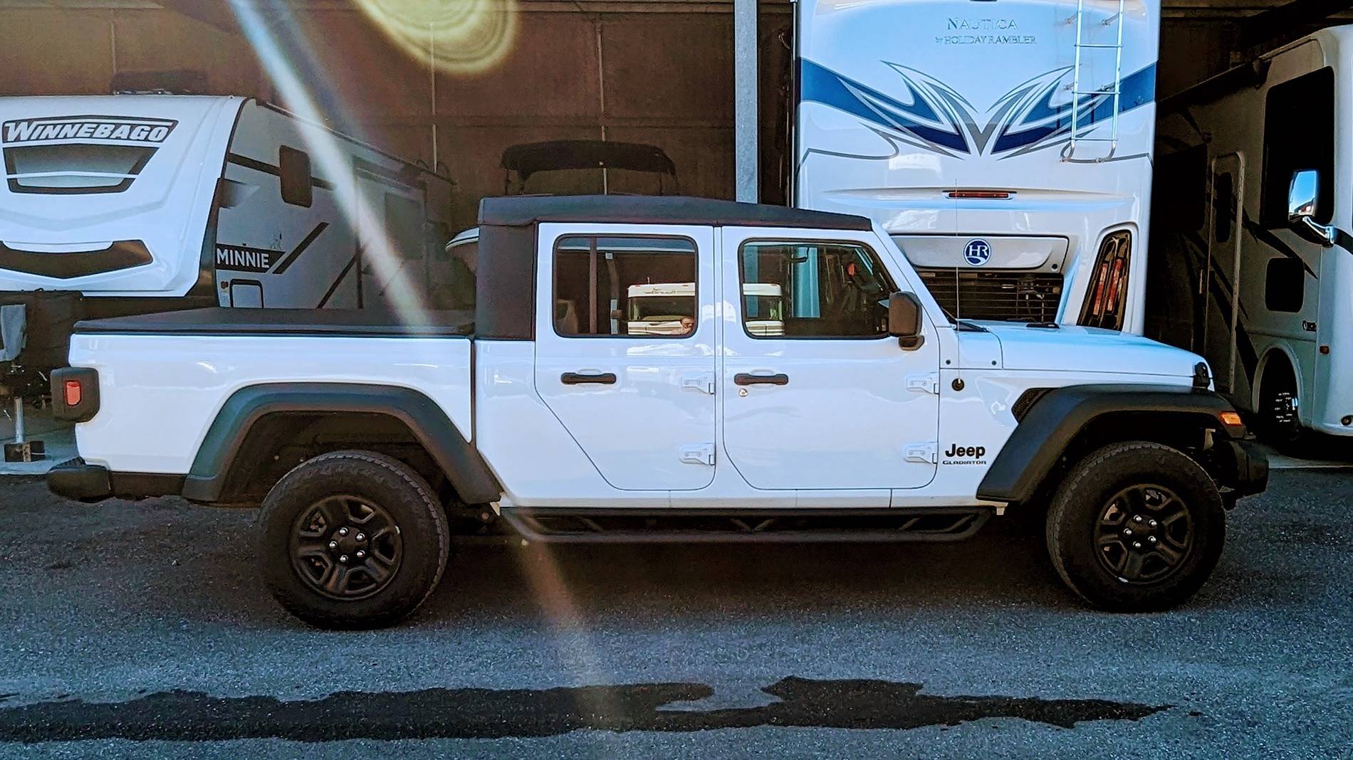

I started with a 2.5” spacer and it was dead level. I purchased some 3/4” daystar spacers for the rear but never used them. Any weight in the rear would have created a reverse rake. To me the 1.5” up front wouldn’t have been enough.

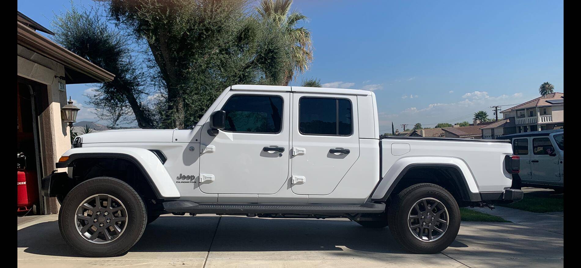

Here is a pic of my Overland with 2024 Rubicon X springs and shocks, 1.5" Daystar front, .75" Daystar rear. Still maintains a slight forward rake. 2.5 in the front is just to much to be a "level" kit.
BTW, the factory rear Rubicon springs are some really nice progreesive rate springs. Compared to my original Overlands, they are a great upgrade.
