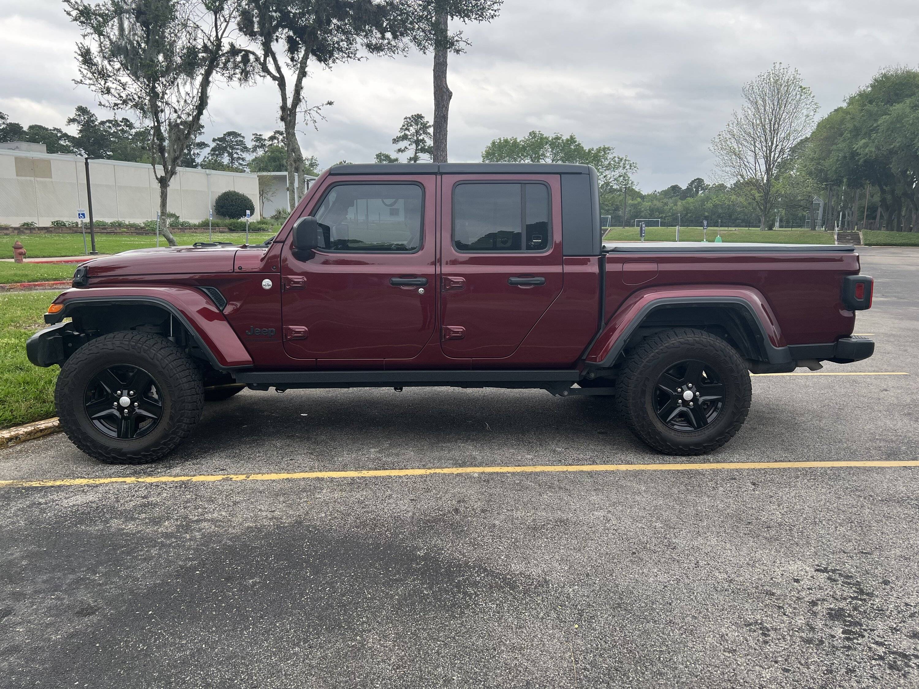

Here is my Sport with the 1.5" Teraflex spacer and stock Rubicon wheels and tires.
I wouldnt personally throw away much money on things to go with spacers. The lower control arms are still nearly parallel with the ground, the springs do not bow, and the stock steering stabilizer is fine. The axle did not move at all, so a track bar isnt necessary.
I do have Mopar LCA's in the closet for it. I guess I will swap them in eventually. Truck is fine to me at 80 MPH on the interstate.
