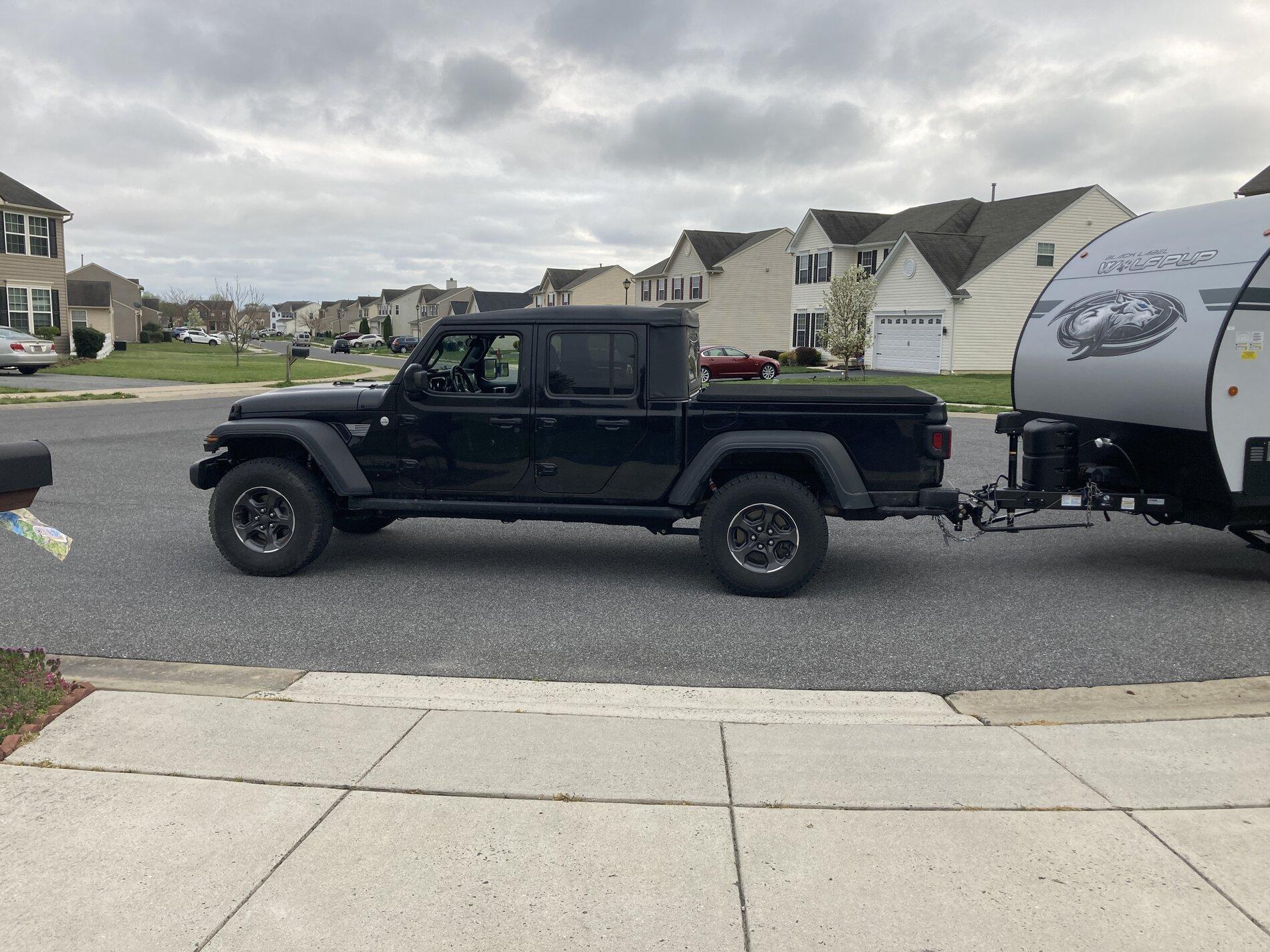

i have the iron rock off road lift on my max tow. Heres a pic with my 4,750lbs trailer. I have a tongue weight of 475lbs and have a WDH on. I am changing my wdh soon but i sit just a little higher in the rear with the trailer on. Which is what i want since ill be loading gear into the trailer for trips soon.

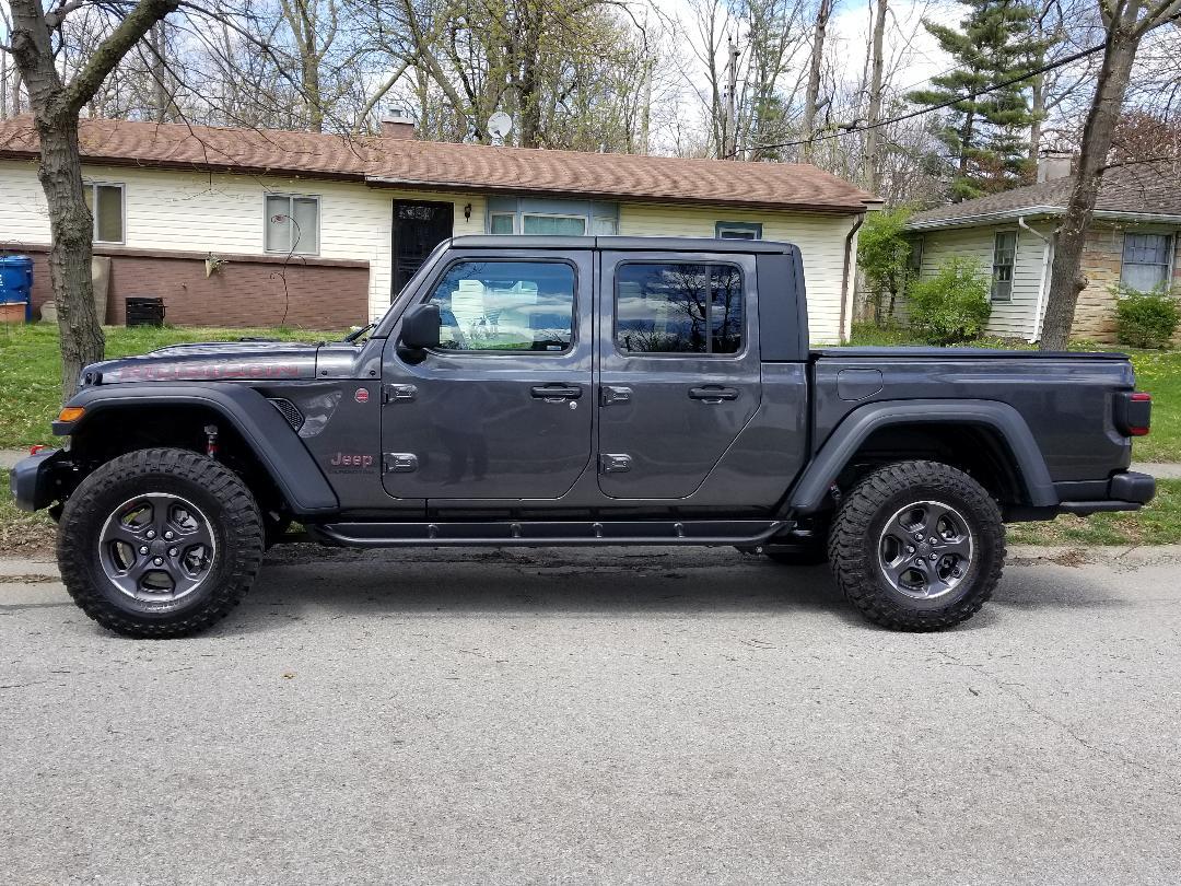

It all boils down to what you want. But I really believe you won't like the look of a 2" lift with 33" tires.
Here is mine with 33" and then 35" with no lift. The look will be close to a Sport with 2" lift and 33" then 35".

Truck looks great!
thats why i went down the middle with 285/75/17, theyre closest to 34’s.
