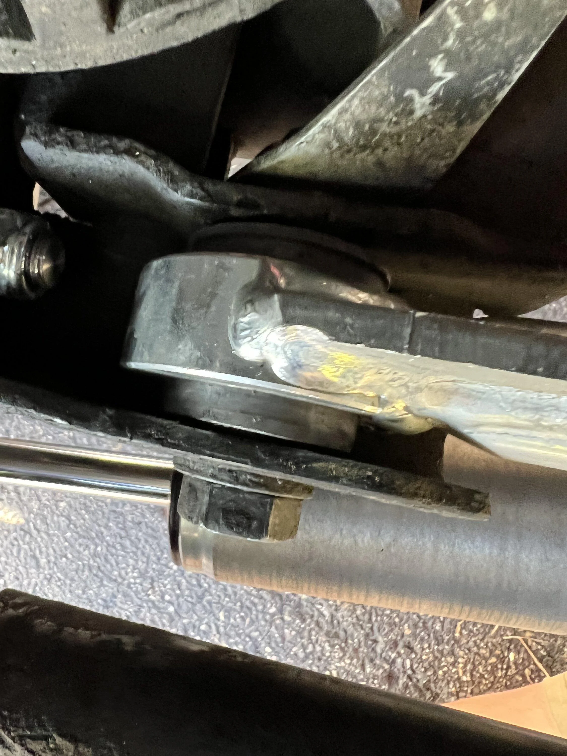

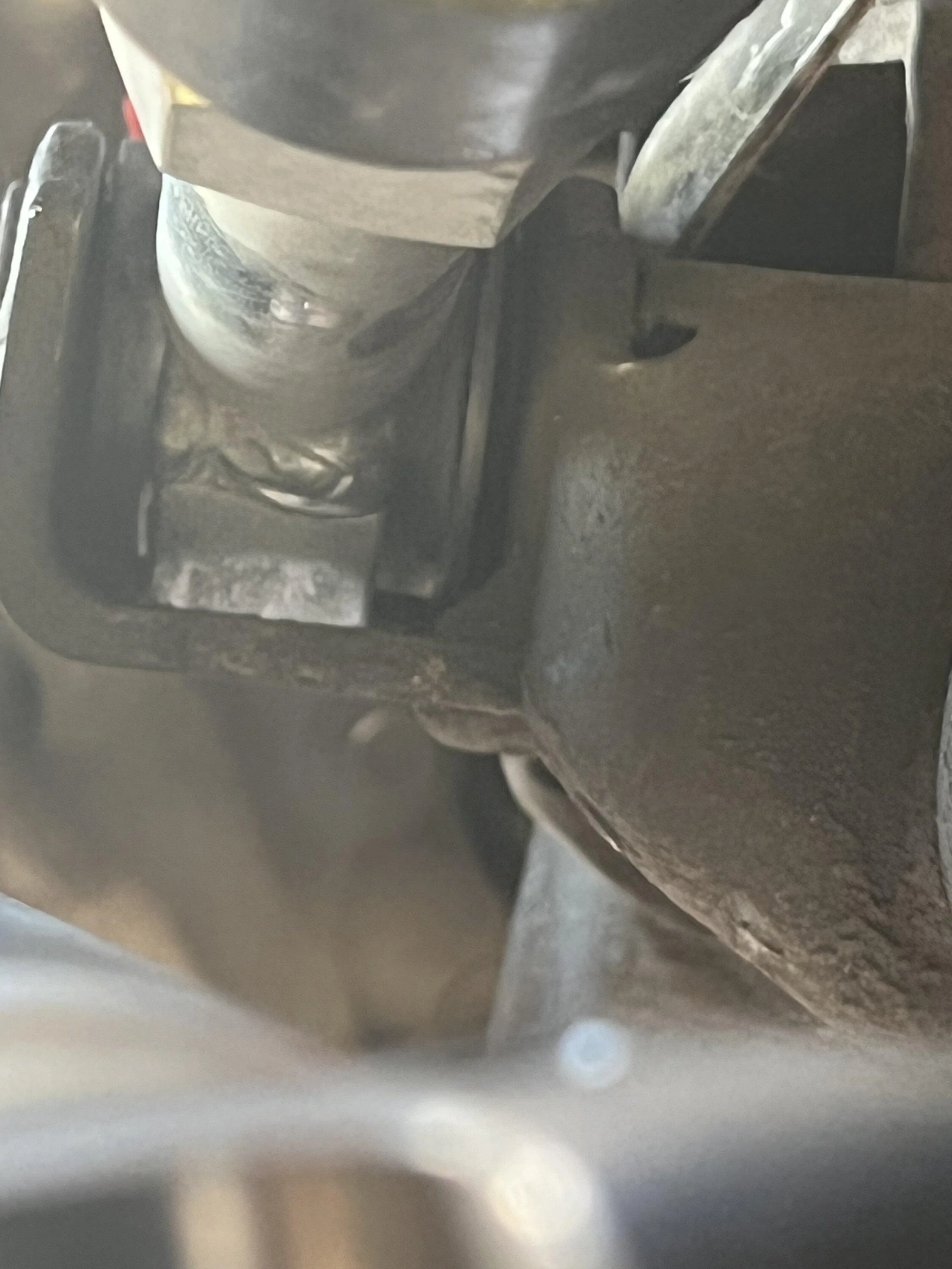

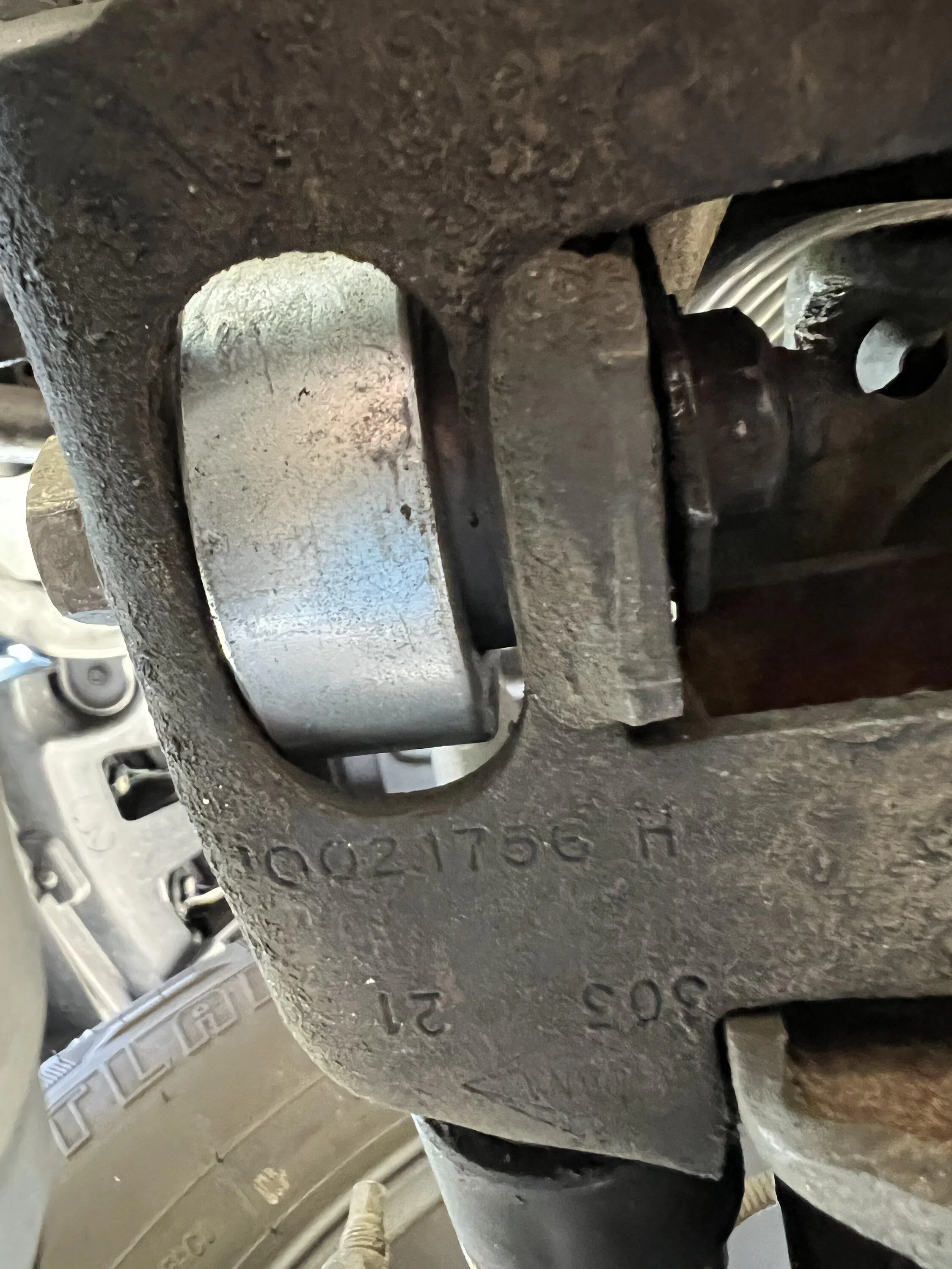

Does the bushing on the front track bar? Look okay?
This is the passenger side (axel side)
I know a loose track bar or bad bushing can cause a host of problems. It’s only a week old but my first at home track bar install and adjustments. No issues so far!
Thanks all!

Can't really even see the bushing in the pics..........
But what teeny bit can be sort of seen doesn't look unusual.
What are you seeing specifically?
Make sure you didn't tighten anything until the truck was fully on the ground, no jack, no stands, then tighten and torque to specs. Never tighten with the vehicle not on the ground.

Yea I’m really happy with the lift and I think I’m now looking for issues lol. Final torque and re torque was in my garage under full weight.
Thanks!
