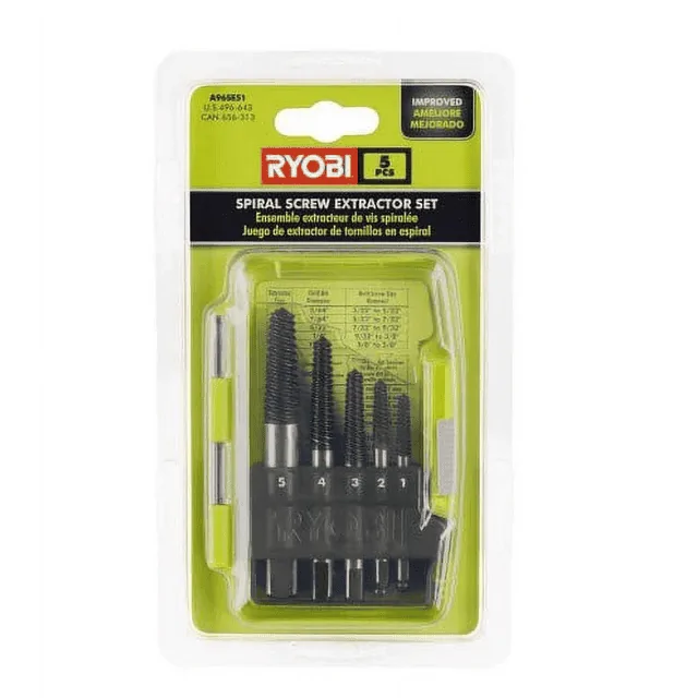

I second the E-Z-out idea. Shouldn't be much of a problem since the bolts are already rounded out. Just get a good set, right size, lightly tap it with a hammer to seat it and work it carefully until it comes out. Penetrating oil wouldn't hurt either as mentioned above. I used the E-Z-out and penetrating oil to get two broken spark plugs out of my 5.9 magnum block last year. Feels oh so good in side after you get it out. Good luck!
EDIT - this is the set I used for the plugs
Jeep Gladiator Door hinge replacement, stripped torx head removal 1712811424199-pm
