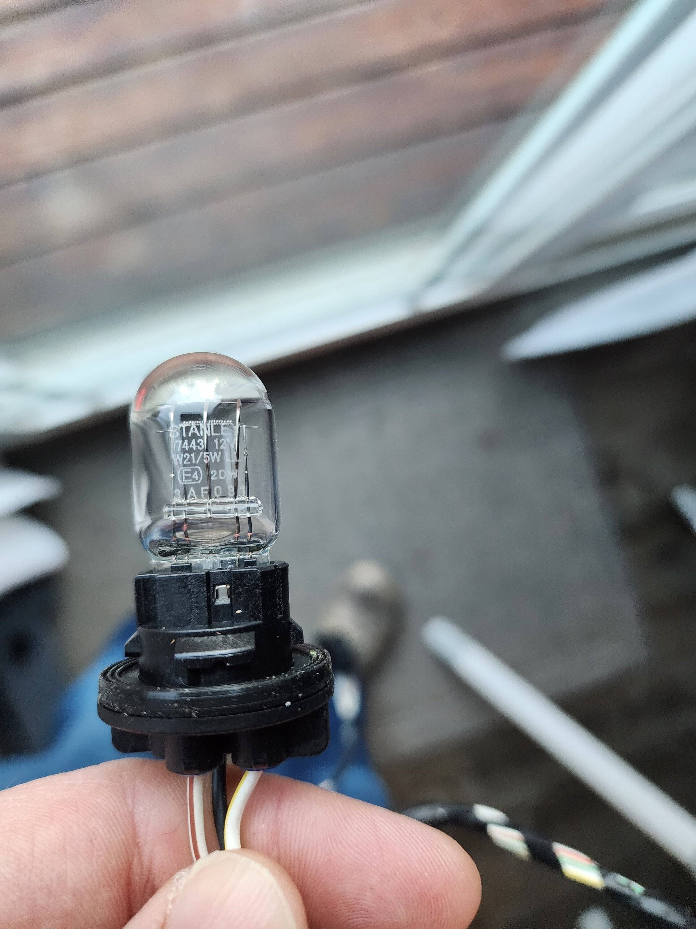

The DRL is a dual filament 7443 bulb. Attached is the bulb and harness I pulled out of mine to replace with the Morimoto sequential drls. You will have to pull back the liner. Kind of a pain but it's fairly thin and you can bend it back enough to squeeze your arm in.
Thank you!!
