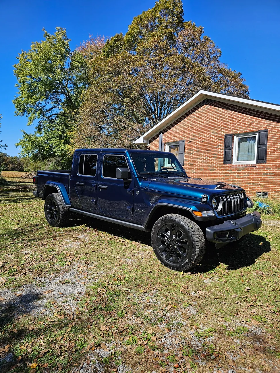

I have had my 2025 Gladiator Nighthawk for 1 month and it has been in the shop twice. I am getting a droning sound between 60-70 mph. Took it back to the dealership. They road force balanced the tires and sound is still there. The explanation I get is that it is my tires. I have the stock 275/55/r20 General Grabbers that came on the Nighthawk. Dealership said they checked everything out and that nothing is wrong with it. (This is my first Jeep, and I freaking love the Gladiator!) I took it back to the dealership today due to tire rub on sharp turns. They trimmed the fender liners and said everything else was good. The proceeded to argue with me that I had put aftermarket tires on there, and that was the reason for them rubbing. We had to get 3 people involved just to convince the service manager that the Nighthawk edition comes stock with General Grabbers 275/55/r20 and that this should be covered under warranty. I had a friend who is a mechanic drive it and he thinks it may be the tires as well. I just want to make sure that something isn't wrong with the drivetrain. Feel like I am getting blown off by the dealership. Anyone else have this issue or advice? I know that Jeeps are louder and I am fine with that, but I just want to make sure that it is normal and not something to be concerned about. Sorry this is a novel. I look forward to hearing from everyone.

Per your Nighthawk picture, the GENERAL Grabber AT tires don't look like they would generate a lot of AT-typical noise. I cannot discern trhe specific model of your Grabbers; there are a number of different types and the noise level from them will vary by their tread pattern, depth and the width of the cannels between the tread-block patterns. Taht said, my quick look at some information indicates the noise level is generally pretty low. You might also be comparing your Gladiator to a more common, street oriented-only, SUV or sedan. Those unibody vehicles tend to have a lot more sound deadening. At least as the price point goes up into the STELLANTIS JEEP Gladiator territory where they have loaded up the body on frame JEEP's with some other cushy ammenties that other SUV's have.
