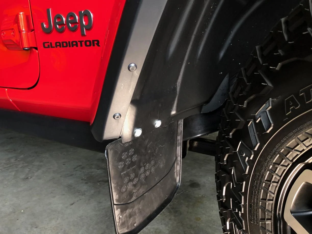

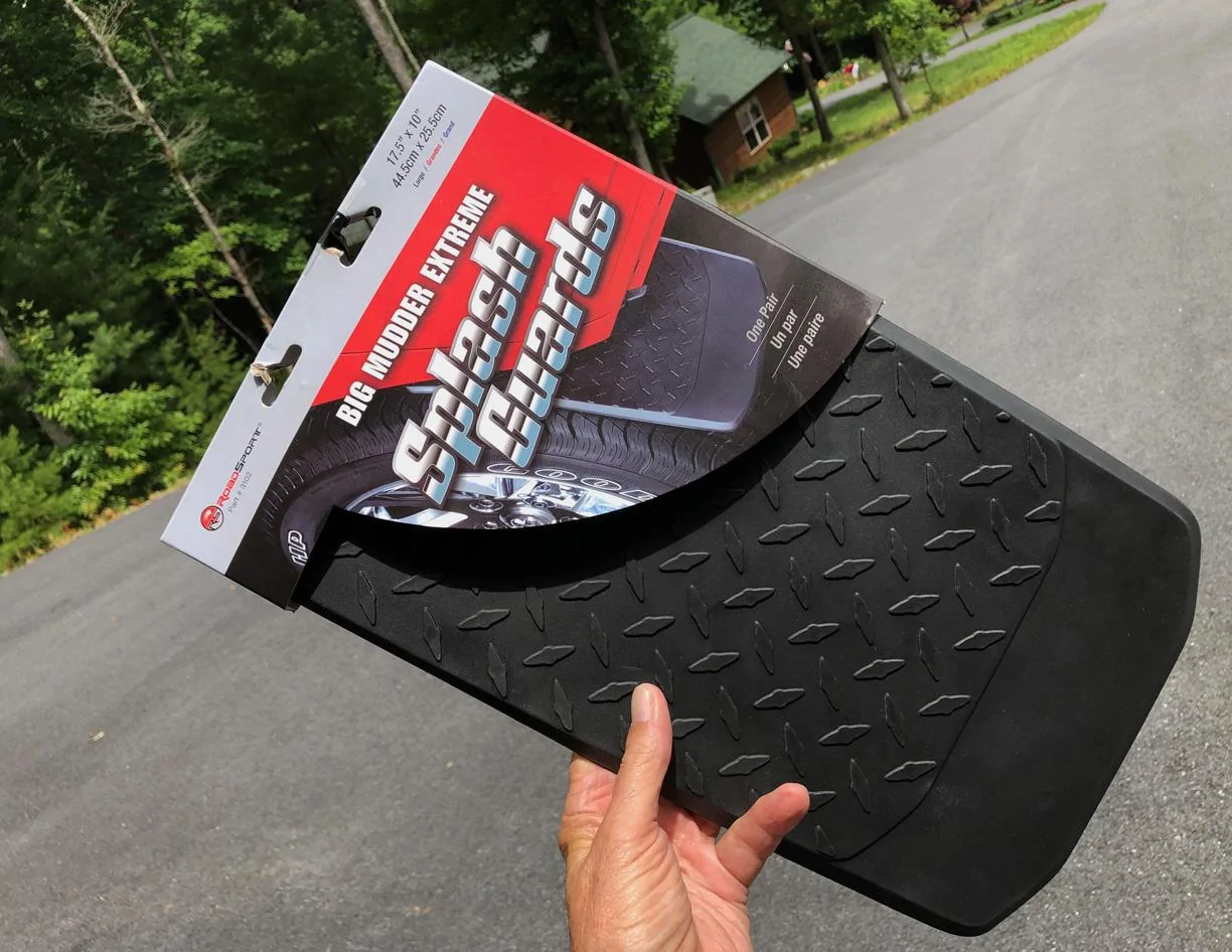

Loving my PU but hating all the crap flying up from the tires sticking to my paint. Anyhow, after spending a few weeks looking for some guards to re-direct some of the road debris, I came to the conclusion the few guards available from vendors, won’t work with the rock guard rail.
Therefore my only option was a set of generic guards from AutoZone, however it took some thought to make them work. First I didn’t like mounting them to the Tonka Toy inner fender since its already so weak it would not support a piece of black tape securely.
Jeep Gladiator Low Cost Mud Guards for your Pickup - Mike Mas f1
Jeep Gladiator Low Cost Mud Guards for your Pickup - Mike Mas f2

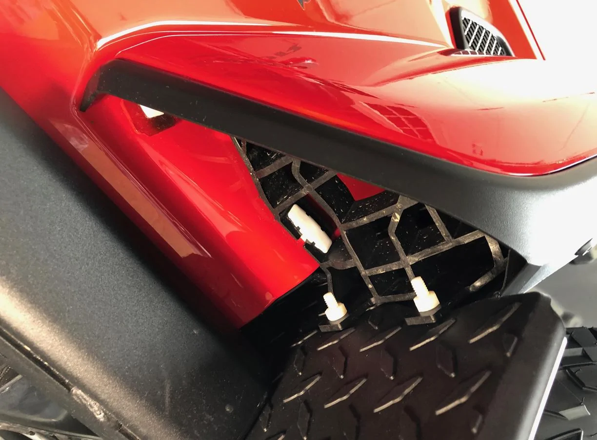

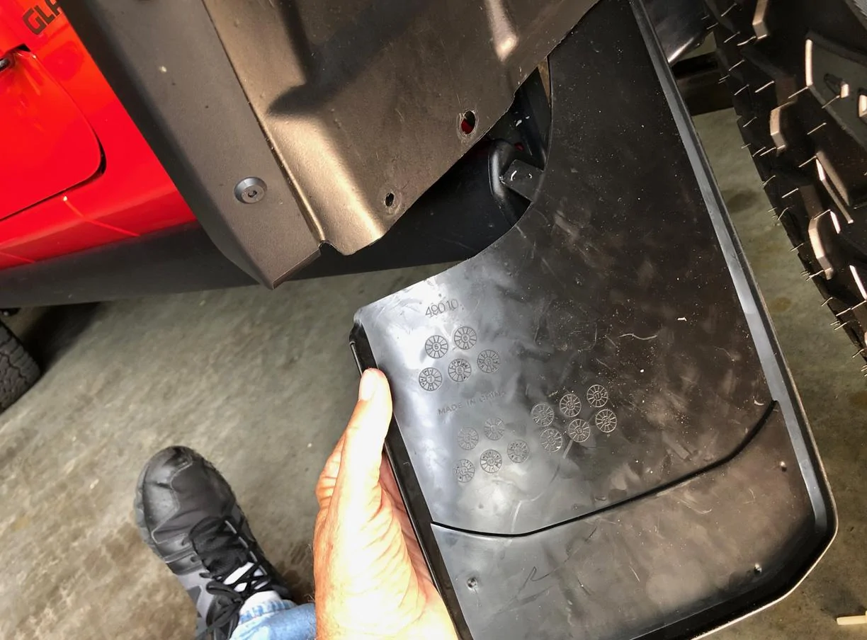

After an hour of planning, my solution was to first mount them backwards from the planned installation. To make the installation clean, I also mounted the guards behind the inner fender so it would there was no trace of them being there and make it easier to clean.
Jeep Gladiator Low Cost Mud Guards for your Pickup - Mike Mas f4

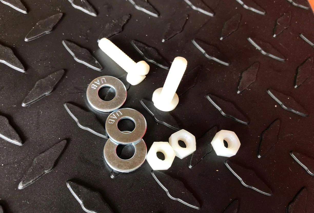

To support the guards I first removed the two flimsy push pins that jeep uses to hold the inner fender. I replaced them with some stronger nylon 1/4x20 bolts, which would secure both the inner fender making it much stronger than it was with the pins, as well as the guards.

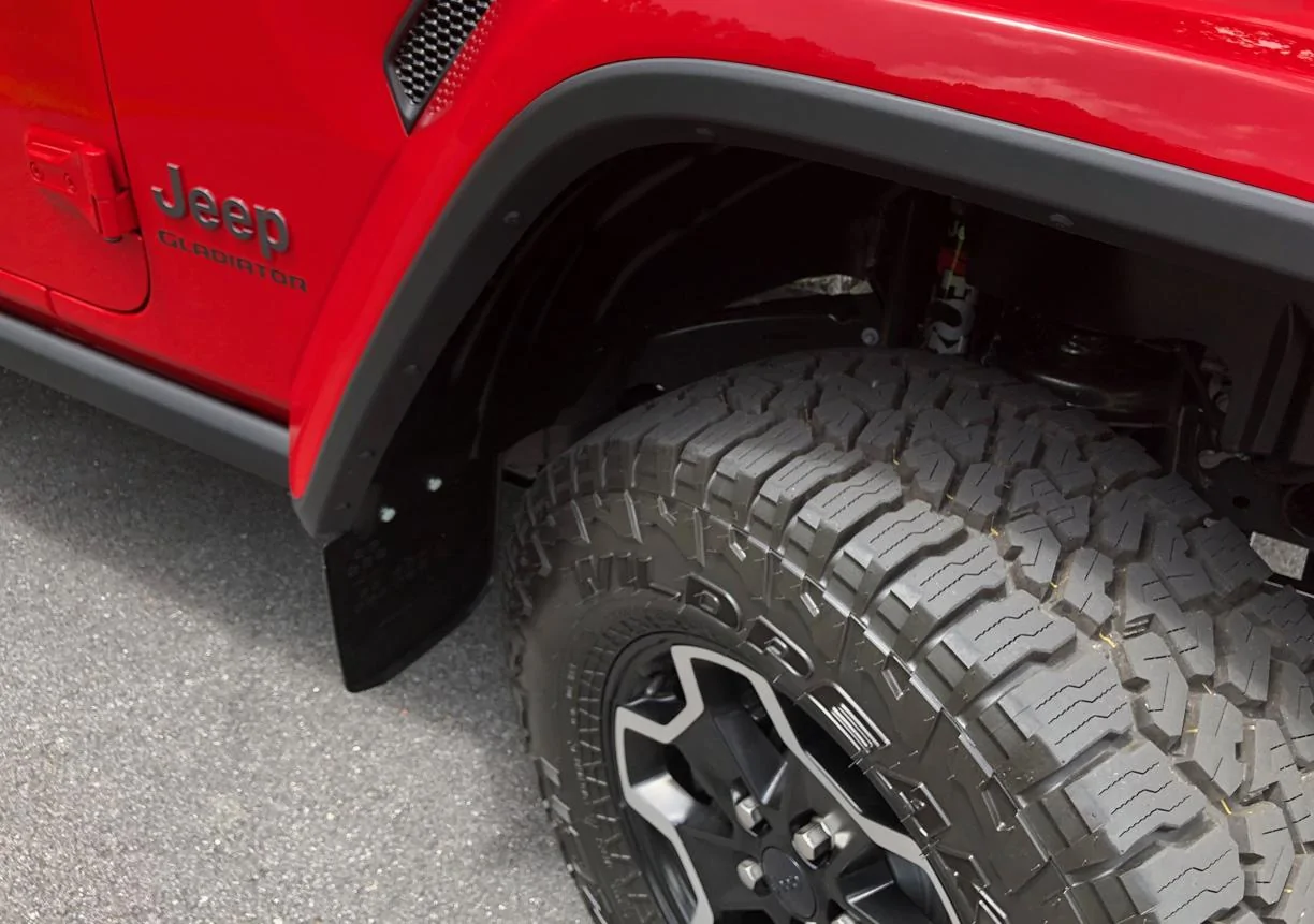

To install them, just hold the guard in place and drill a few holes. Use the nylon bolt to go through the fender liner, guard and into the strong mounting bracket at the bottom of the fender.
Jeep Gladiator Low Cost Mud Guards for your Pickup - Mike Mas f5
Jeep Gladiator Low Cost Mud Guards for your Pickup - Mike Mas f6
I recommend using some blue locktite to keep the nuts from backing off. I'll also spray the hardware black. To make the guards even more secure, I put a dab of silicon rubber between the guard and the front of the rock guard cap for extra strength. The guards are $17.95 and might be the least expensive thing I'll ever buy for my truck!
Enjoy - Mike

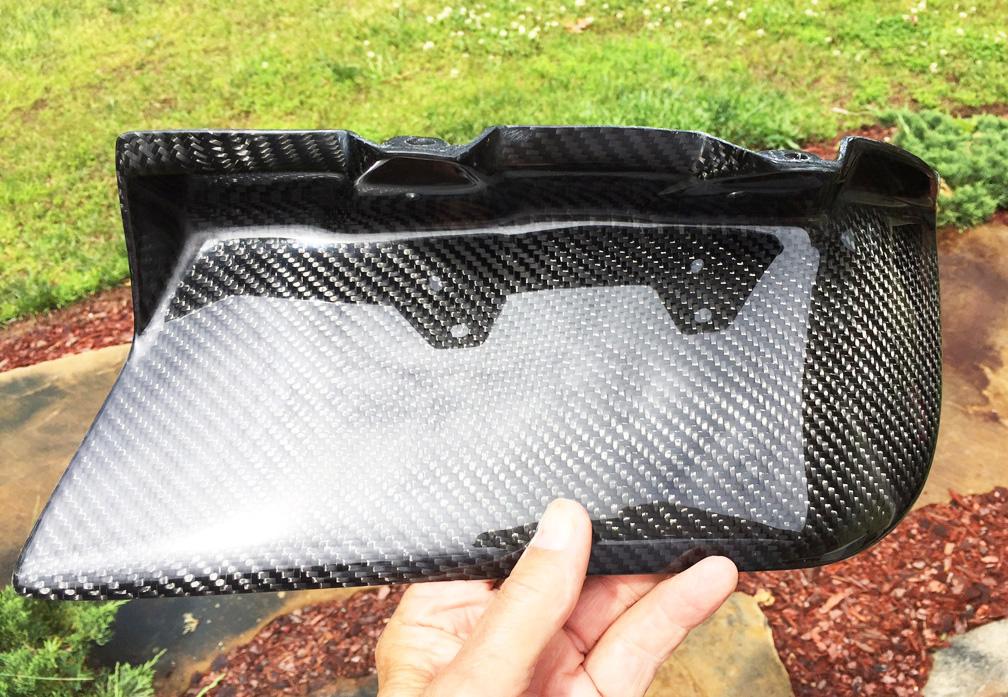

If a company could make some Jeep guards in carbon in black, red silver etc. They cold sell hundreds!

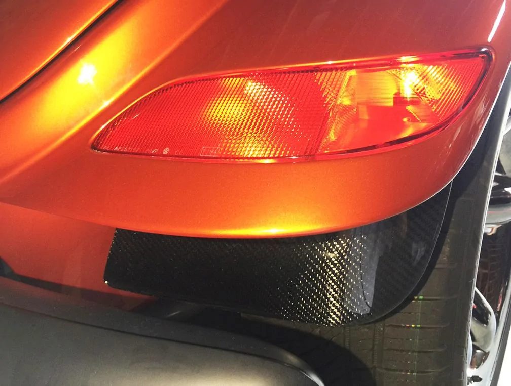

Here's a few shots of some carbon guards I found for my Prowler.
