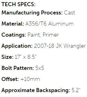

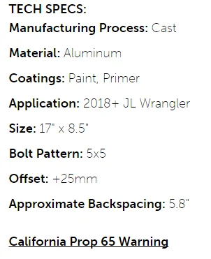

I'm looking at the same thing, it seems like every few years I'm relearning this stuff because it's kinda one and done. LOL
This link is cool. You put in your current setup and it figures out the rest, but also has a graph on the right to show you location of the tire in the wheel well, as well as gives you an idea of distances to vitals around you.
You can also play with offset numbers to get your wheel location dialed to your liking.
IE: I want the new wheel to be at the same location (inner area closest to suspension) as possible.
So, all things equal, moving to 37"x12.5 about 25mm offset is good. Then adjust for increase of wheel width.
There is also a simple chart at the bottom of the page.

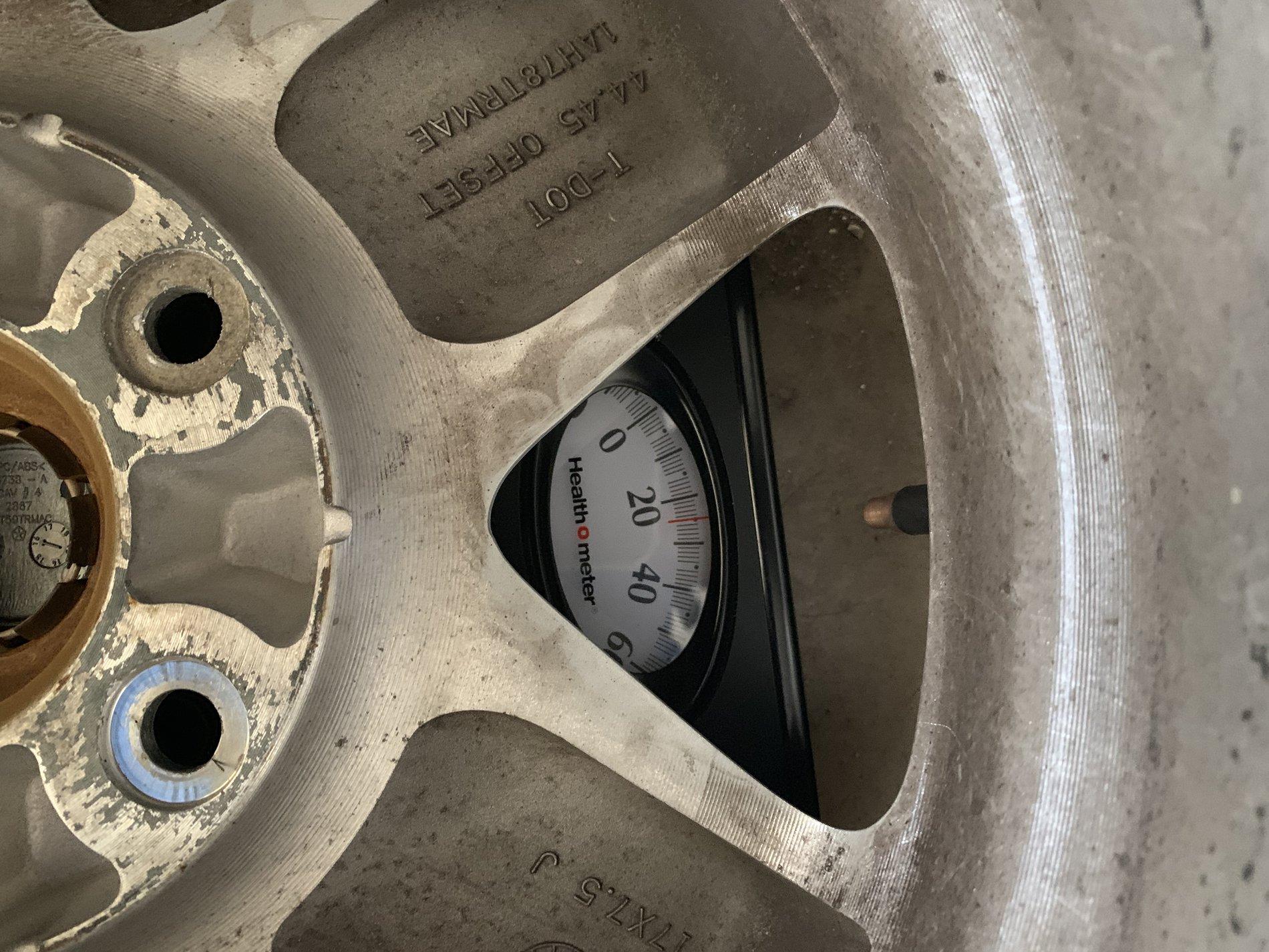

Stock JTR wheel = 7.5w and +44.45 offset.
To keep a stock-ish inner relationship to the suspension;
-An 8w wheel would be +38mm
-An 8.5w wheel would be +32mm
