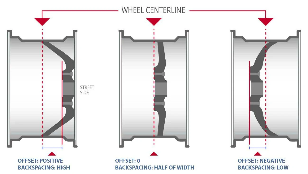

0 offset means the mating surface of the wheel is exactly center of the wheel width. A positive offset will cause the wheel to get sucked into the wheel well of the vehicle, a negative offset will cause the wheel to get pushed out. The number is just how many millimeters the mating surface is moved from center.
Backspacing is how many inches the mating surface of the wheel is from the inner lip. The larger the backspacing the more the wheel gets sucked into the wheel well, the lower the backspacing the more the wheel will get pushed out. If you have a 8in wide wheel, then a 4in backspacing would be center, or a 0 offset equivalent.

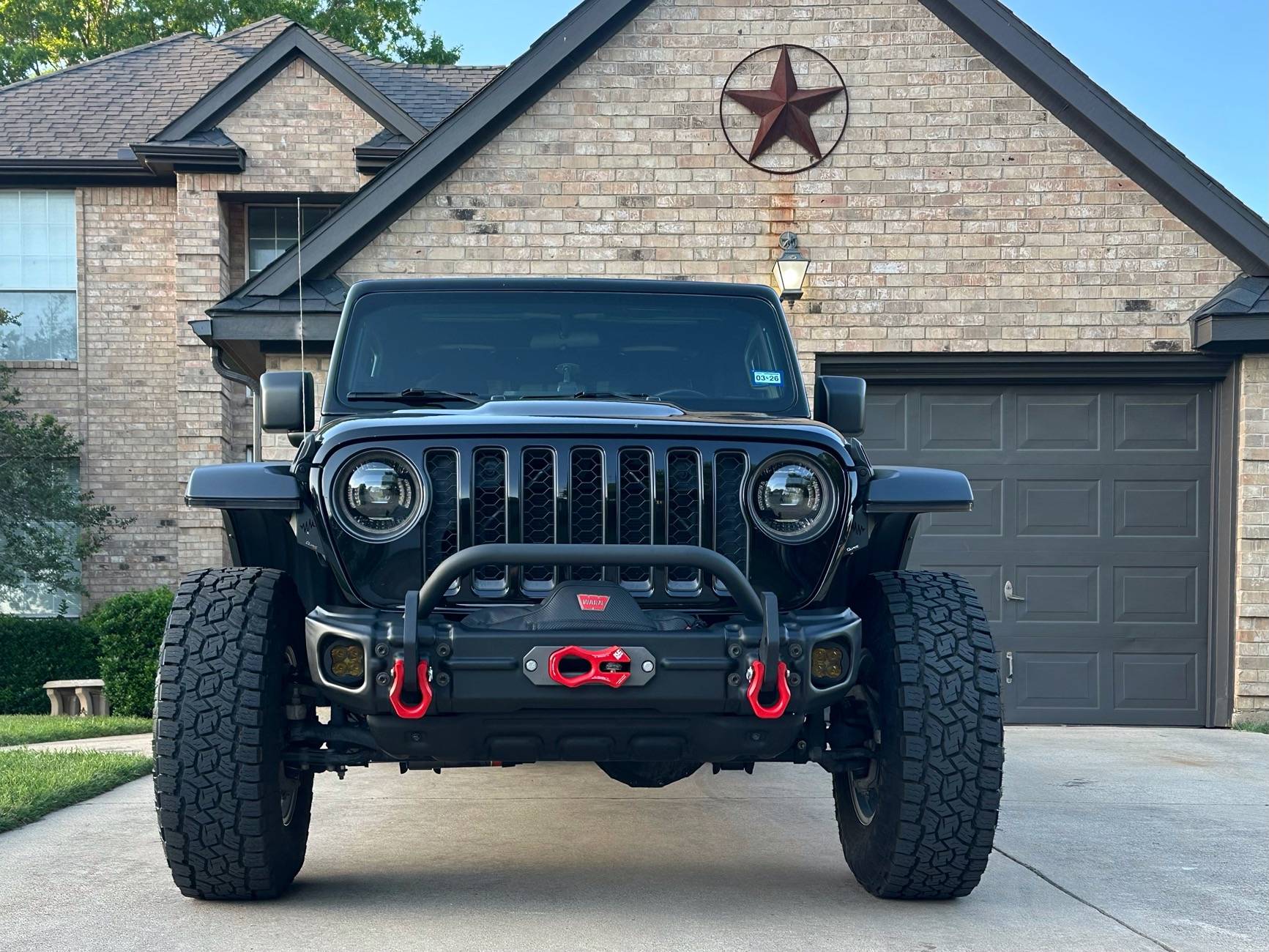

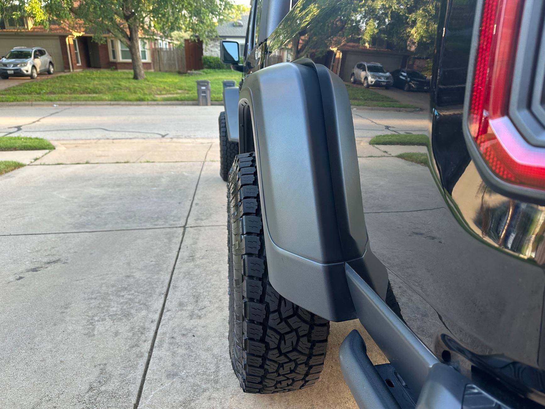

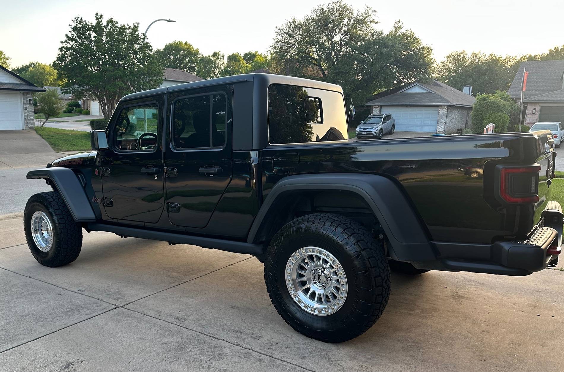

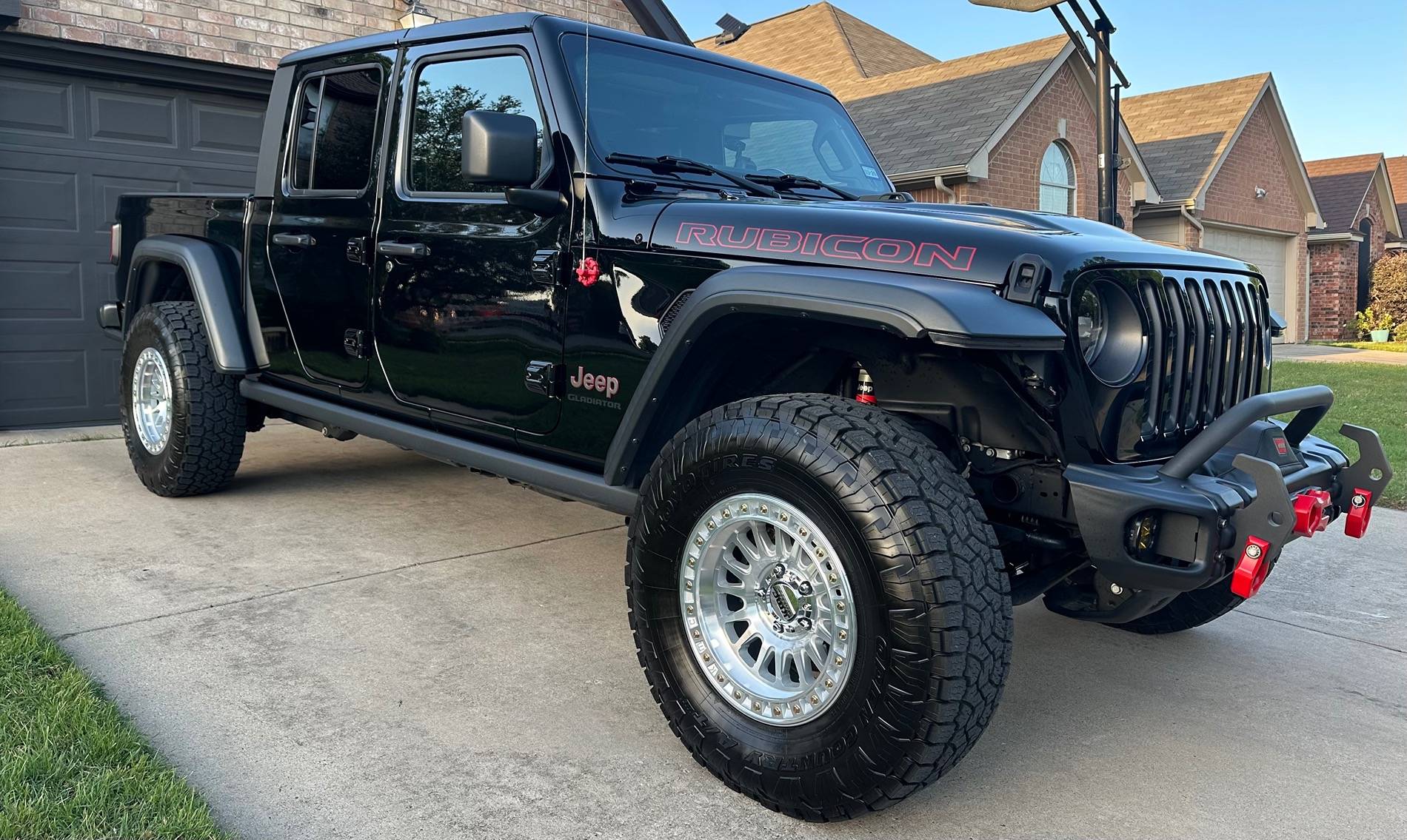

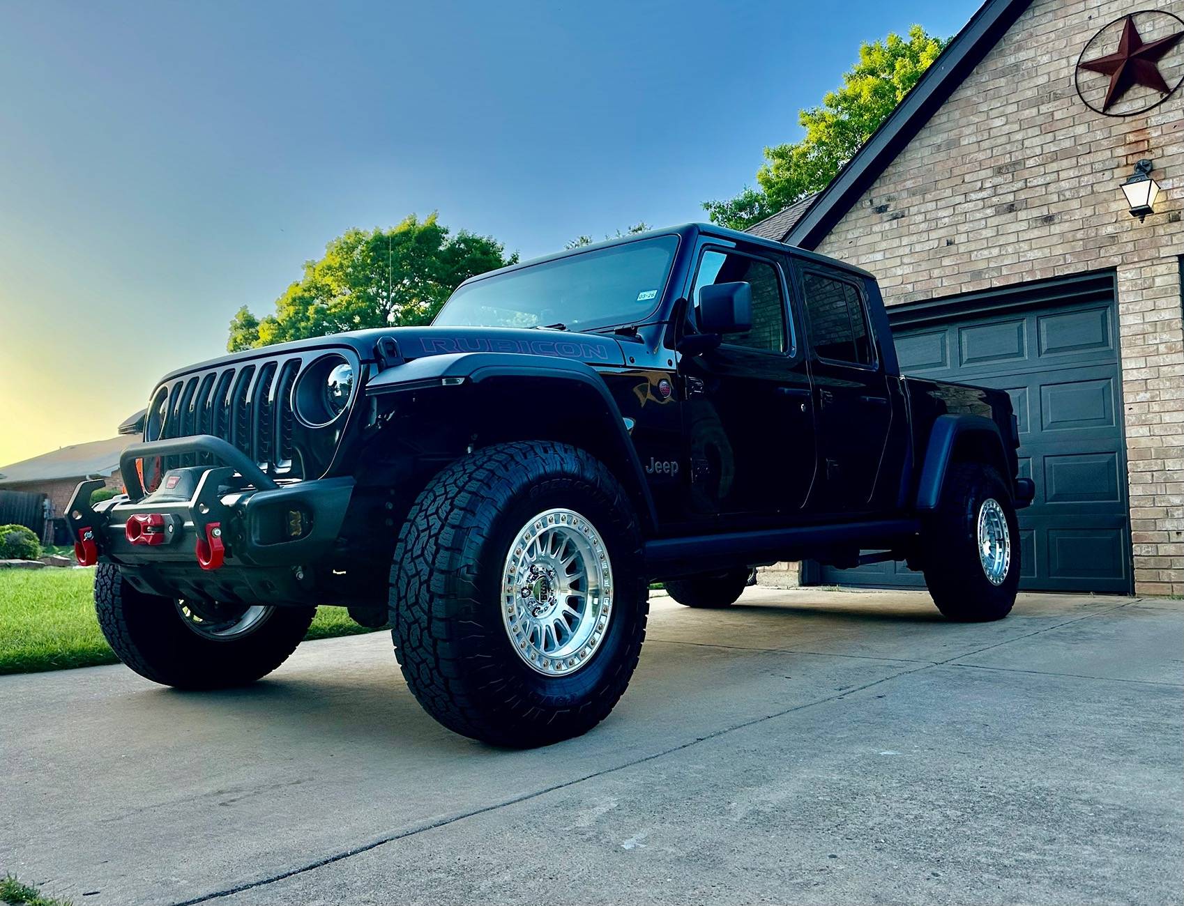

For insight, I added 35/11.5x17 tires to my stock Rubicon wheels on a Teraflex 1.5” leveling kit. It never rubbed anywhere, but I wanted more stance without buying wheels at the time and added 1.75” Teraflex spacers, which is equal to 44mm. The stock Rubicon wheels are 17x7.5 with a +44mm offset. The spacers made them sit as if they were zero offset and I had very slight poke with a lot more inner clearance. I then found the wheels I wanted in stock. KMC IMS 17x8.5 -10 offset. Slightly more poke than the stock wheels on spacers and a great looking stance without going wild IMO. The backspacing on the KMC wheels with -10 offset is 4.36”. (Most aftermarket lifts suggest a minimum around 4.5” of backspacing. Some are even at 3.5” of backspacing for larger shocks or coilovers.) New KMC’s installed pictured for reference.

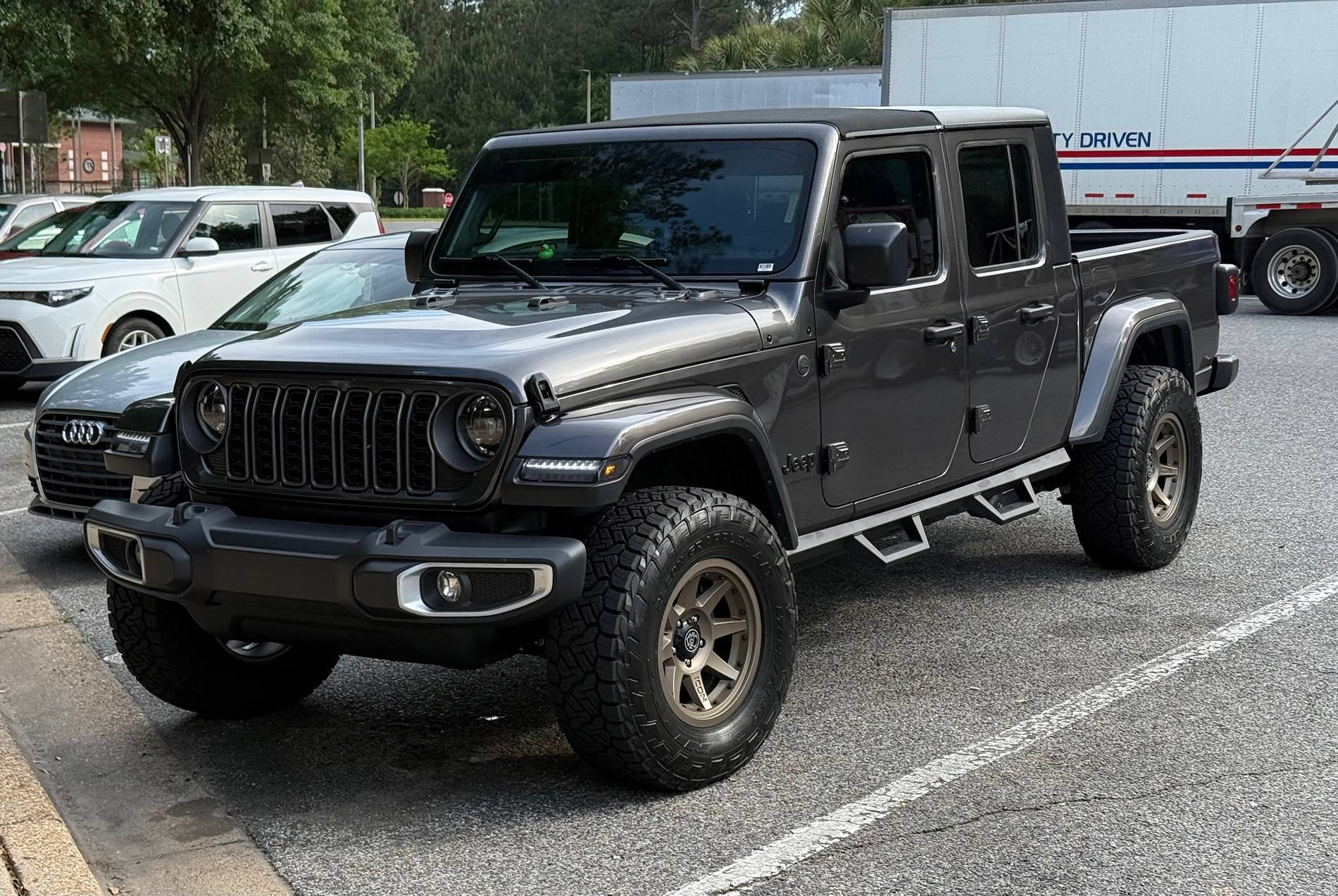

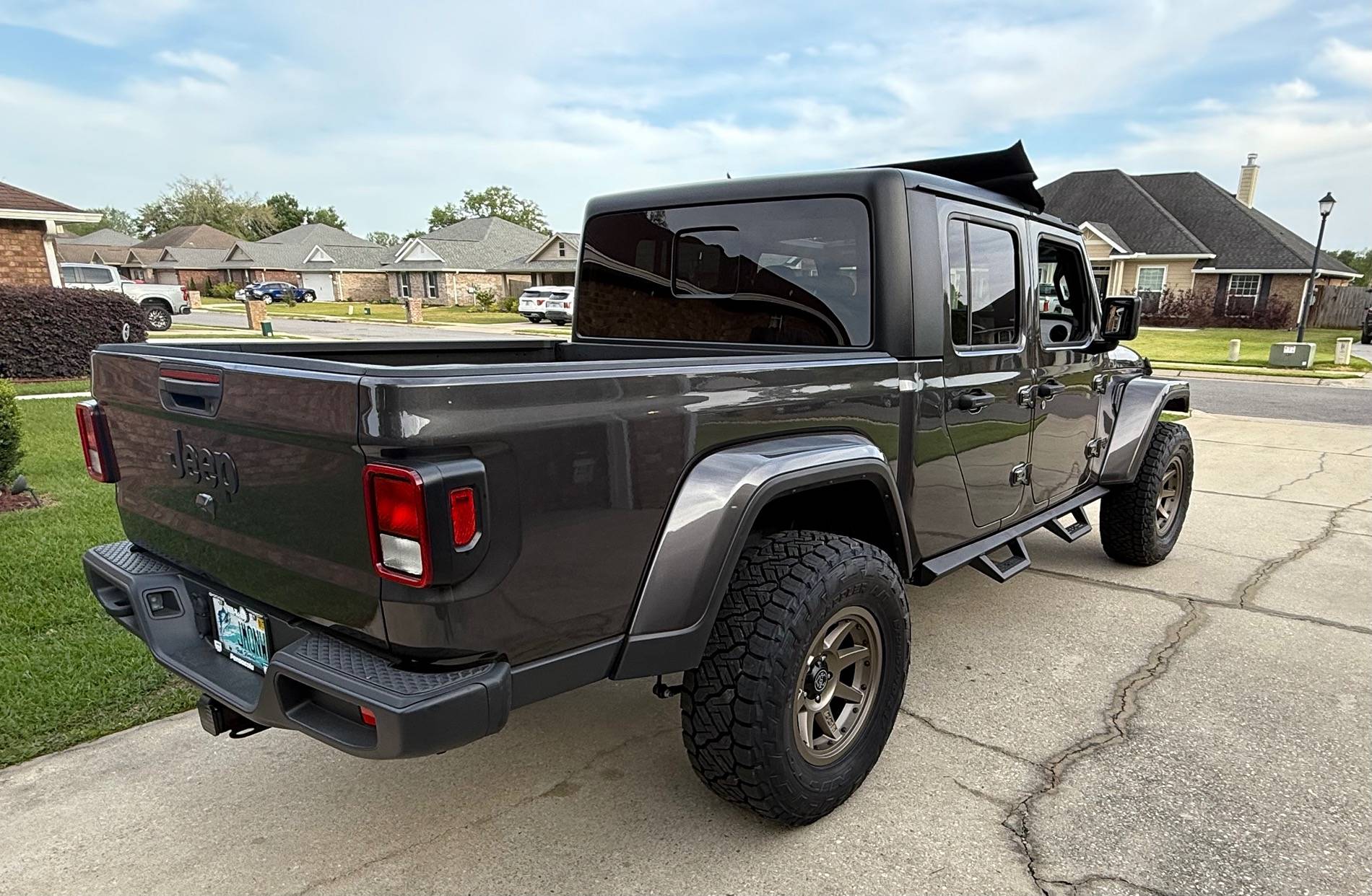

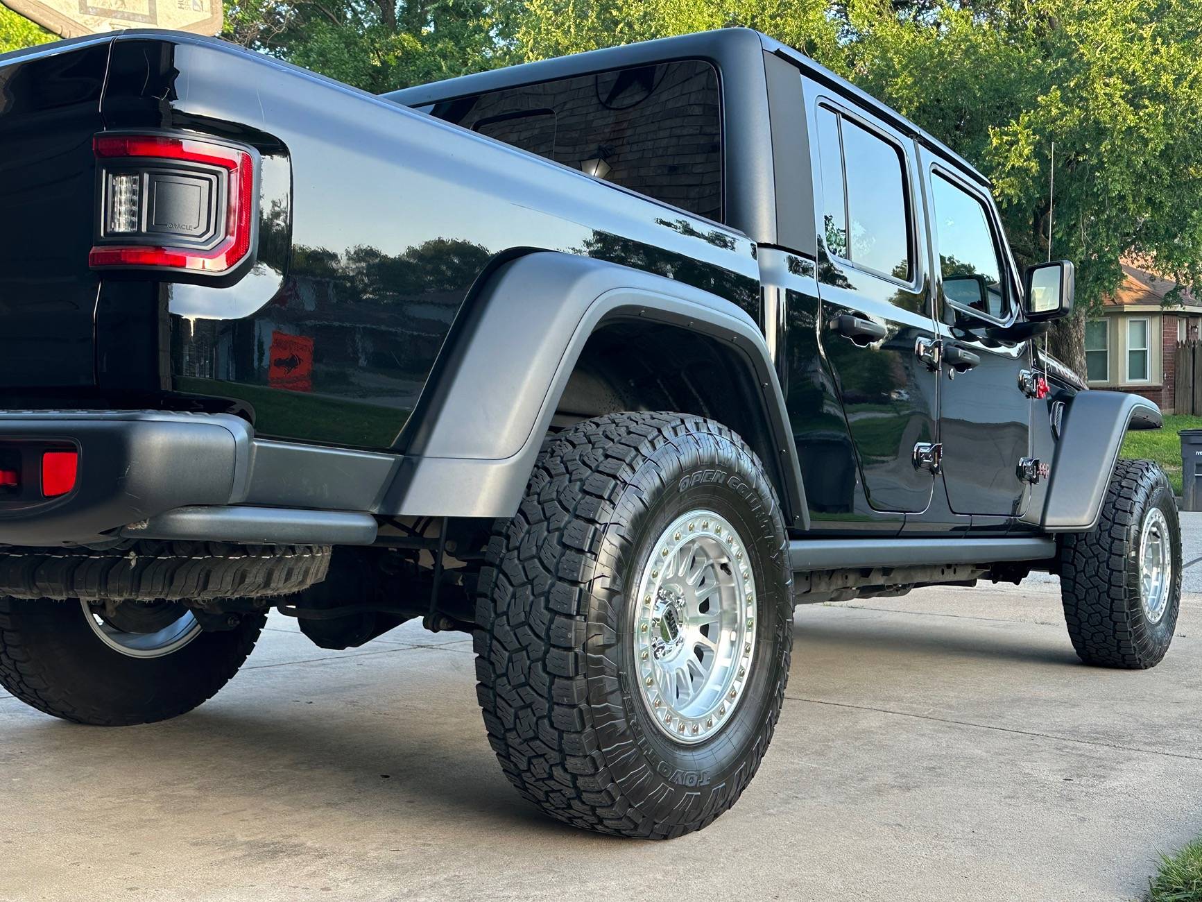

I also got the -12 recommendation from every vendor I spoke with. I ended up with a -6 offset as that was the only offset that Icon offered on the Rebound Pros.​
I would have preferred positive offset, perhaps a +12. -6 is a little on the pokey side, but I really liked the Rebound Pros.​

DFWJTR
Brandon
Apr 13, 2024
42
Fort Worth, TX
Technician
Looks great!
21Mojave24XR
Aug 12, 2024
108
95
Tx
2021 Gladiator Mojave, 2024 Willys XR
Field Diesel Technician
im right there with you on the rebound pros but that -6 is what killed it for me but it does look really good

I think this has been the best explanation I’ve read. Thanks!

Nice explanation.
One minor correction, an 8” wide wheel with 4” backspacing is not 0 offset. The reason is wheel width is measured between the bead mount area and backspacing measures to the outside edge of the wheel. An 8” wide wheel with 4” backspacing will have -12mm offset. An 8” wide wheel with 0 offset has 4.5” backspacing.
