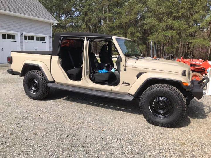

No problems whatsoever. I got the Kenda Klever 35x10.5 tires. Love them. Ride good, no noise, fit perfect. No lift either.
I have taken this setup to Uwharrie here in NC and had no issues with rubbing , etc... I have even towed my travel trailer with this setup with no issues.

Looks good! I started to do this but gave up because I could not find center caps. What did you use?
Center caps from the "stock" black rims .
