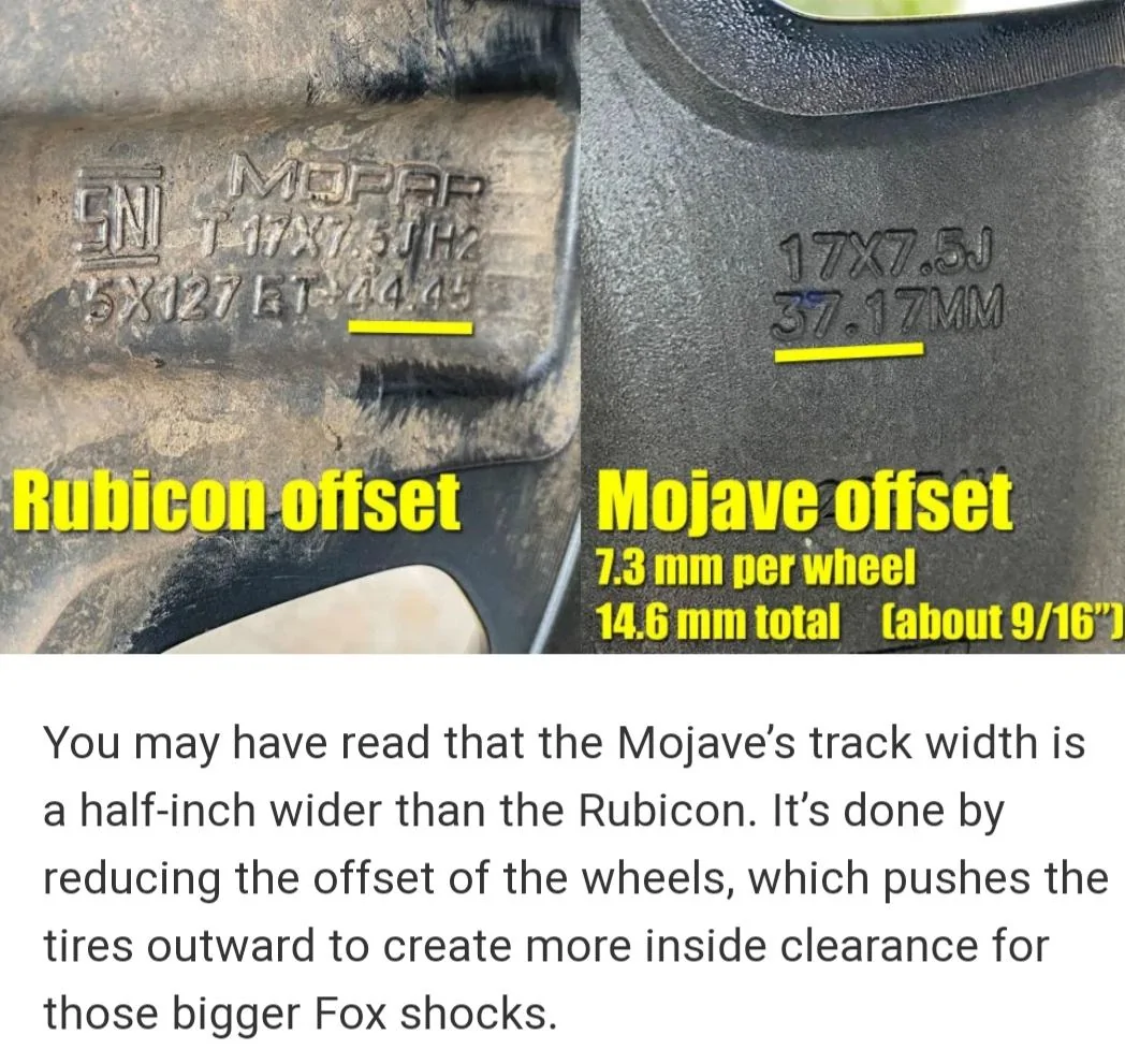

I haven't seen any aftermarket wheels with that high of a positive offset. The closest would be a few in the +25 range, such as AEV wheels.
Also, Mojave factory wheel is 17x7.5 +37.17 offset, not +34.

When you go with a wider wheel, half the difference in width can be added to the offset for comparison purposes. So the 8½" wide wheels have an offset difference of ~13mm compared to the 7½" wide wheels.

A 7.5" wide wheel with an offset of 37 mm will have the same inside spacing as an 8.5" wide wheel with an offset of 24 mm
A 7.5" wide wheel with an offset of 37 mm will have the same inside spacing as a 9" wide wheel with an offset of 18 mm.
A 7.5" wide wheel with an offset of 37 mm will have the same inside spacing as a 10" wide wheel with an offset of 5 mm

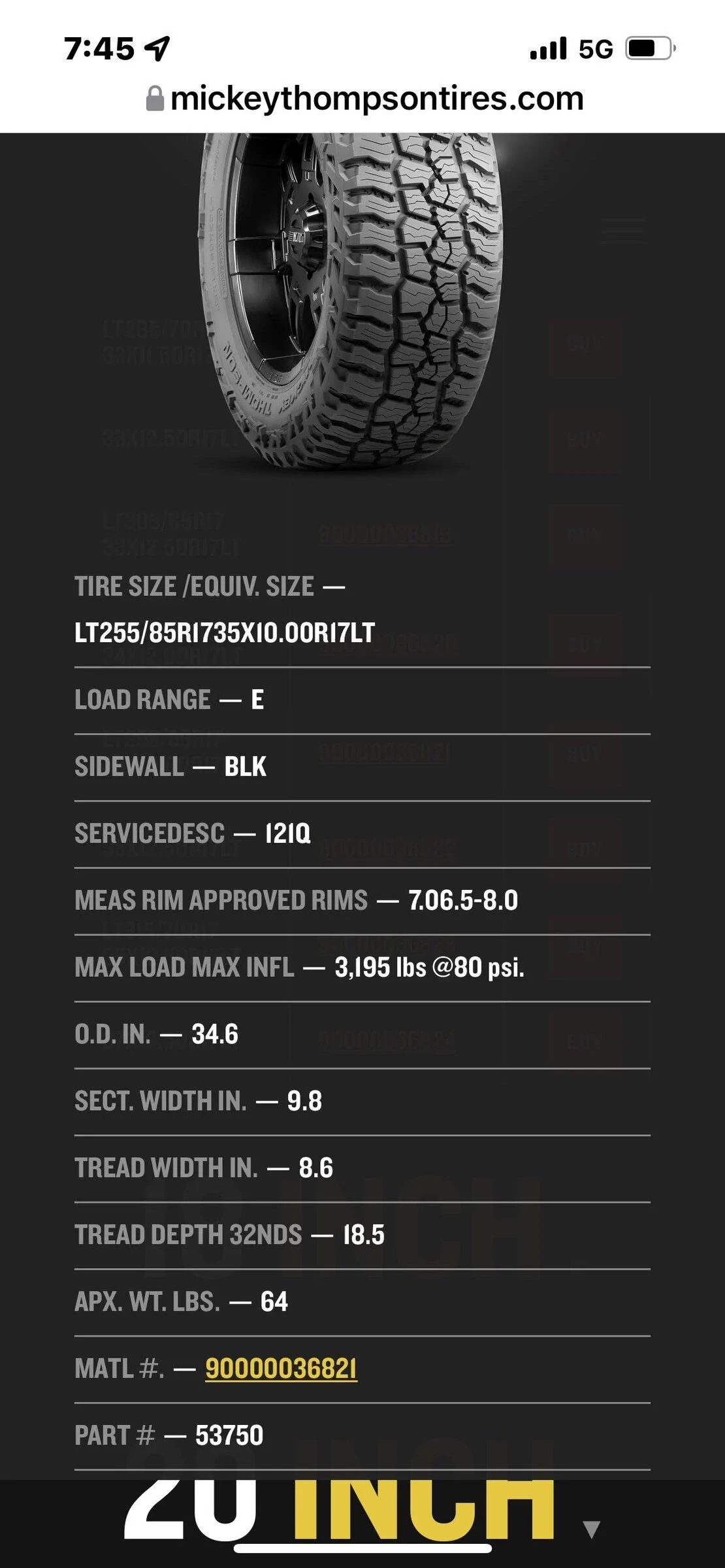

So, I’m absolutely planning on running Mickey Thompson Baja Boss A/T 255/85R17. On the stock Mojave wheels, they’d not have an aggressive look at all, I’m assuming. Not even make it to the edge of the outer most fender line??

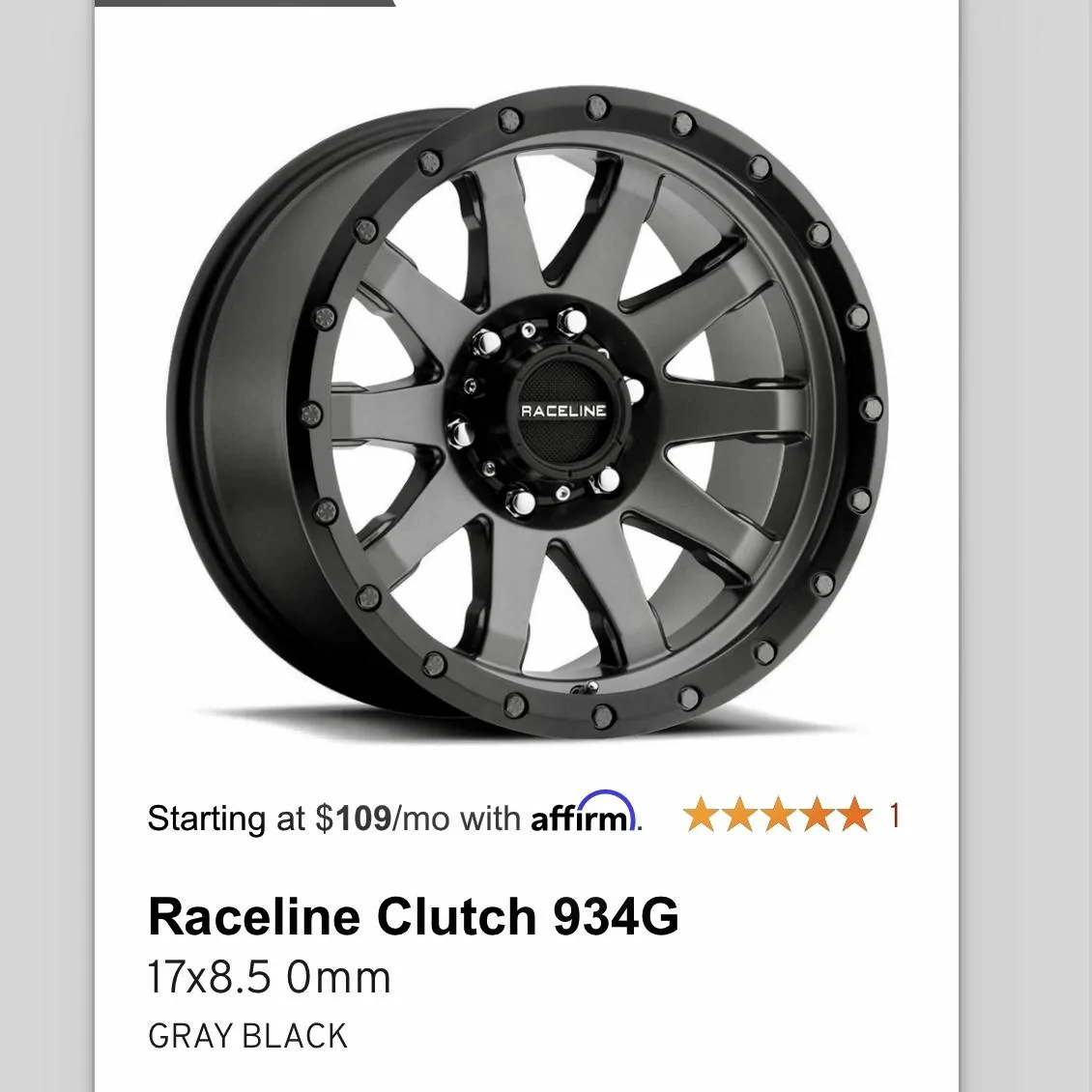

Well, talking with the Jeep specialty shop here (Unlimited OffRoad) and Belle Tire, they both tell me I’m OK to mount said tires on 17x8.5” wheel (& more even). I know that said Mickey Thompson tire’s on-wheel spec range is 6.5-8.0”, but my question is… Raceline Clutch 17x8.5” wheels… is 0 offset going to be enough? Too much?? I don’t really know and of course want to find my perfect set up in one shot, putting the tires just out from underneath the outer most fender line.
Thought(s)? Advice??
