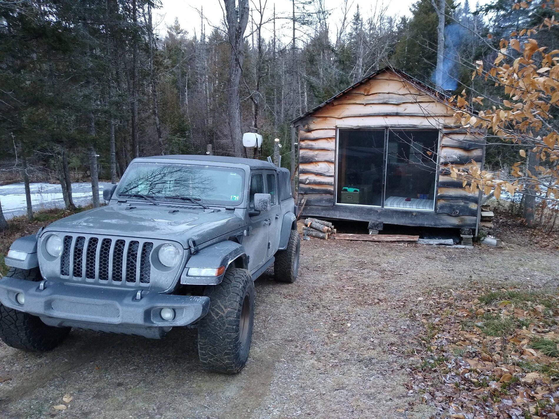

I am running a 17x10 wheel w/ -18mm offset, and the tire tread sticks out about 2" past my Max Tow fenders.
Jeep Gladiator Suggestions on wheel brand and offset? IMG_20201226_155559507

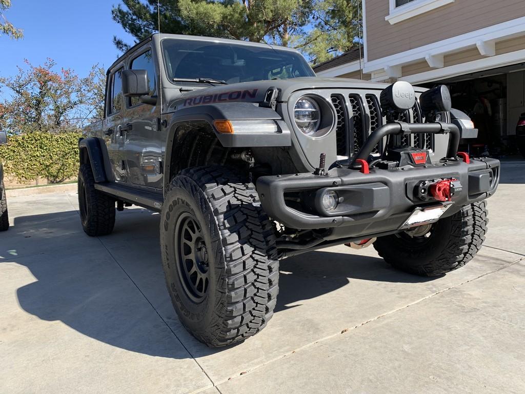

I am running the Method 703 with "Bead Grip" technology in zero offset, 17x8.5. This makes the 37" Goodyear MTRs stick out "one lug" past the fenders. No clearance or rubbing issues with my Clayton lift kit. They are light, and allow you to air down much more than normal wheels. They balanced up nicely, and so far, they have been great.

Black Method 703 in zero offset

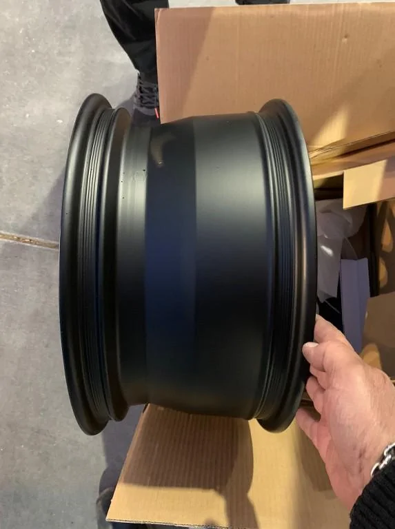

Dont go by offset! Same offset on an 8.5" tire is going to be different than on a 10".
All that matters is backspacing. Width and offset together will be the inputs to arrive at backspacing.

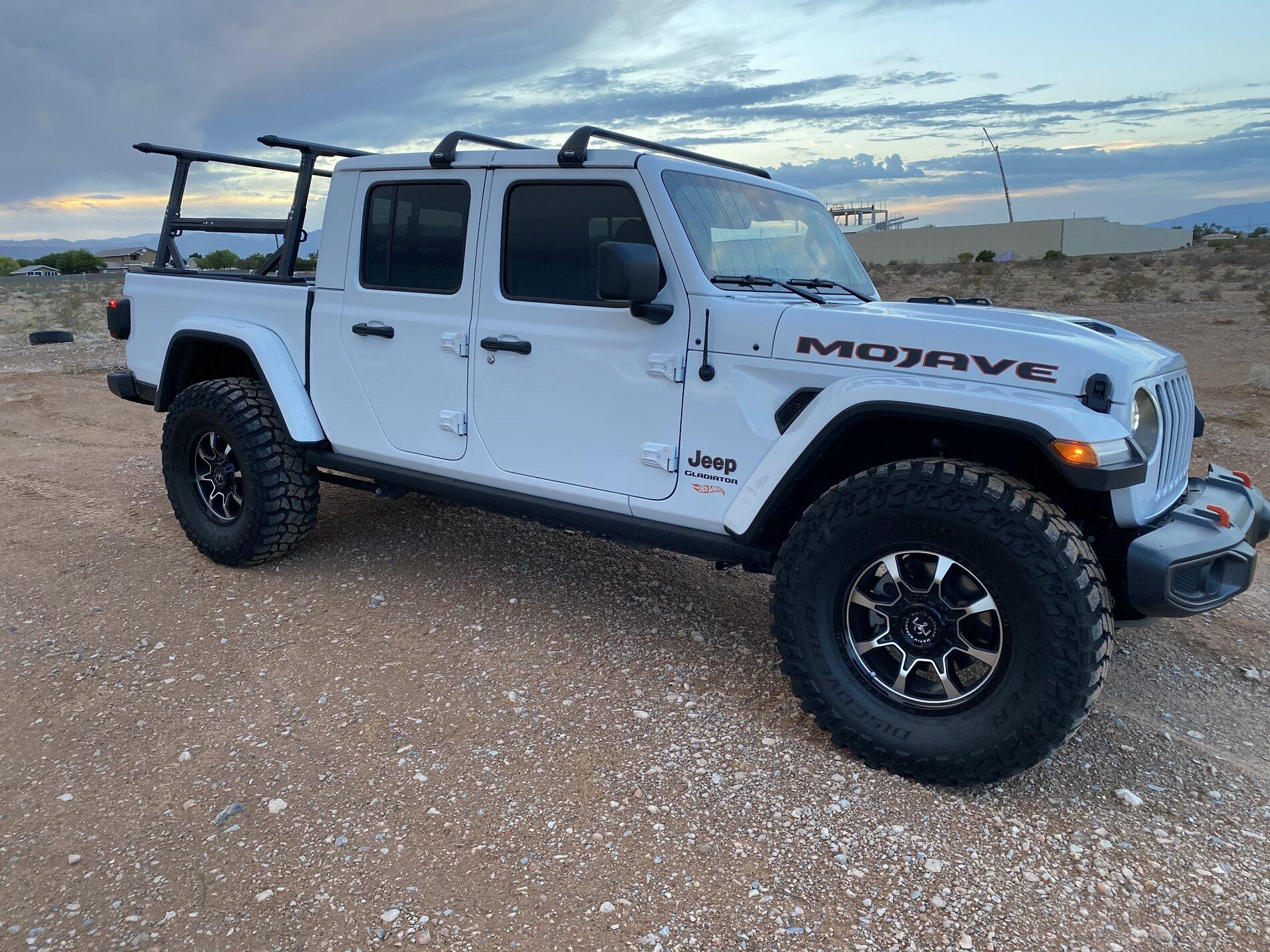

A + 24mm offset, using a 12.5” wide tire, is as tuck in the fender as you can get. I have Motiv Glock wheels with +18 mm offset and
37/13.5/18 tires, no lift.
Jeep Gladiator Suggestions on wheel brand and offset? 17DBD1B7-298A-4C08-A20F-309E5D0E3B8F
