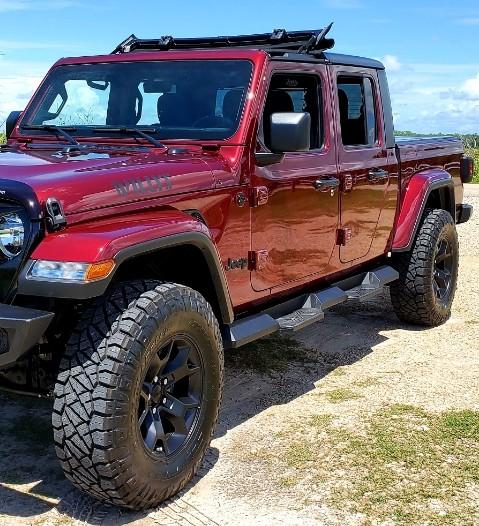

Hello , I am new to the forum and need some help. I just had the factory 2 inch lift installed on my 2020 Gladiator. I love the lift and my new tires and wheels look great. One little problem though. I believe the backspace and or offset is not correct. My tires stick out about 2.5 - 3 inches beyond the fenders. My wheels are Fuel Ammo # 701 size 17x9 4.53 bs with - 12 offset and the tires are Nitto Terra Grapplers 35x12.5. My Gladiator is a 2020 Sport, ( no max tow package. ) . I would really like any input about the proper wheels offset and bs. I would like the tires to be under the fenders , I don't really like the tire sticking out look. Does anyone know if I could run one of the OEM wheels without having problems rubbing , I do like a few of the OEM after market options. Please help !
