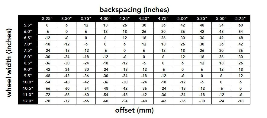

i have the 2020 Gladiator Mojave and have ordered the readylyft 4" lift that allows me to utilize my factory suspension. It calls for a wheel with a 0mm offset, does anyone know if that is a recommendation or do you have to have that offset or everything will break and you will look stupid?

If I remember correctly they recommend 4.55 to 4.75. The 2nd best way to verify is to look at their website, otherwise…give them a call to be sure.

How wide of rim? A 8.5" wide rim will have different backspacing from a 9" wide rim with 0 offset.
Jeep Gladiator Wheel and Tire offset EDU_wheel-offset-backspacing-conversion-chart
Oh nice! Thanks for uploading the chart!
