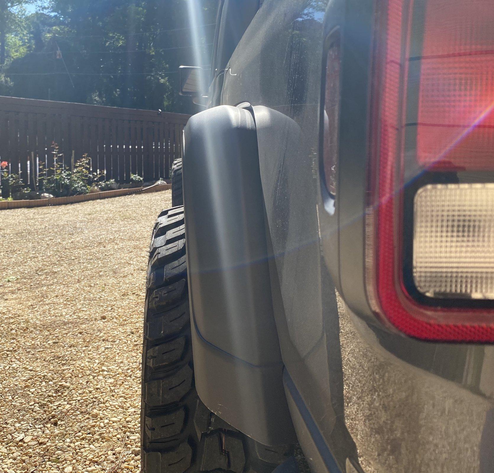

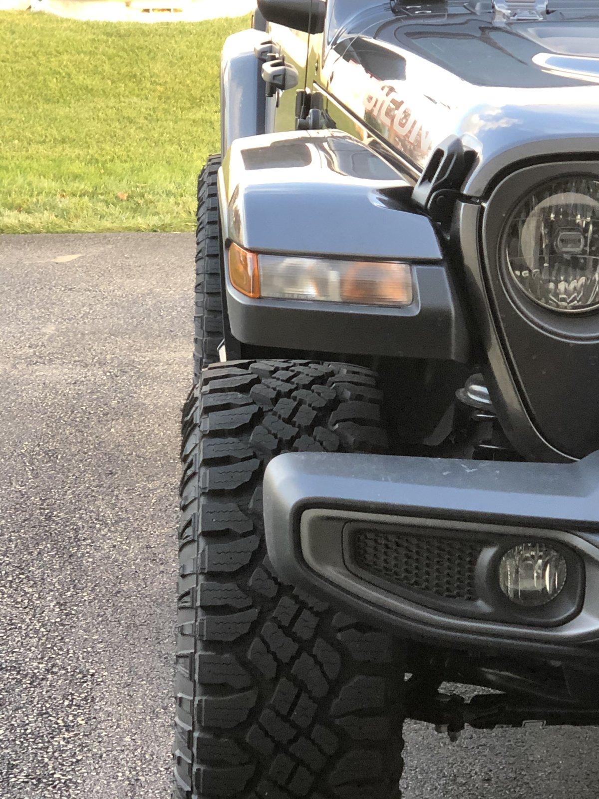

CP4
Dec 6, 2018
41
29
17015
2010 Camaro RS, 2020 Sting Gray Gladiator
315/70R17 Duratracs on Hardrock rims - 17x8.5 with 5.2in Backspace (+10 offset)
Do you have any issues passing inspection in PA with how far out the tires are from the fender?

Only had it inspected once, but no issues at that time. I had them come out and look at it before I left to make sure they were okay with it. If they had a problem with it I would have just thrown the originals on for inspection and then switched them back when I got home! Never been pulled over either.

Thanks for the info! I am new to the Jeep world and how all the tires/wheels and offsets work. I have a max tow sport s ordered and your tires and wheels match up exactly with what I was hoping to do but I was concerned it wouldn't be "legal" in PA. I guess I could always do the same with the stock tires and rims if it were an issue.
Mar 5, 2020
1,954
2,422
Lake Martin, Alabama
Rubicon (same axle width as yours), 37x13.50r20 Kumho KL71 on 20x10 4.56” BS & -24mm Offset...
