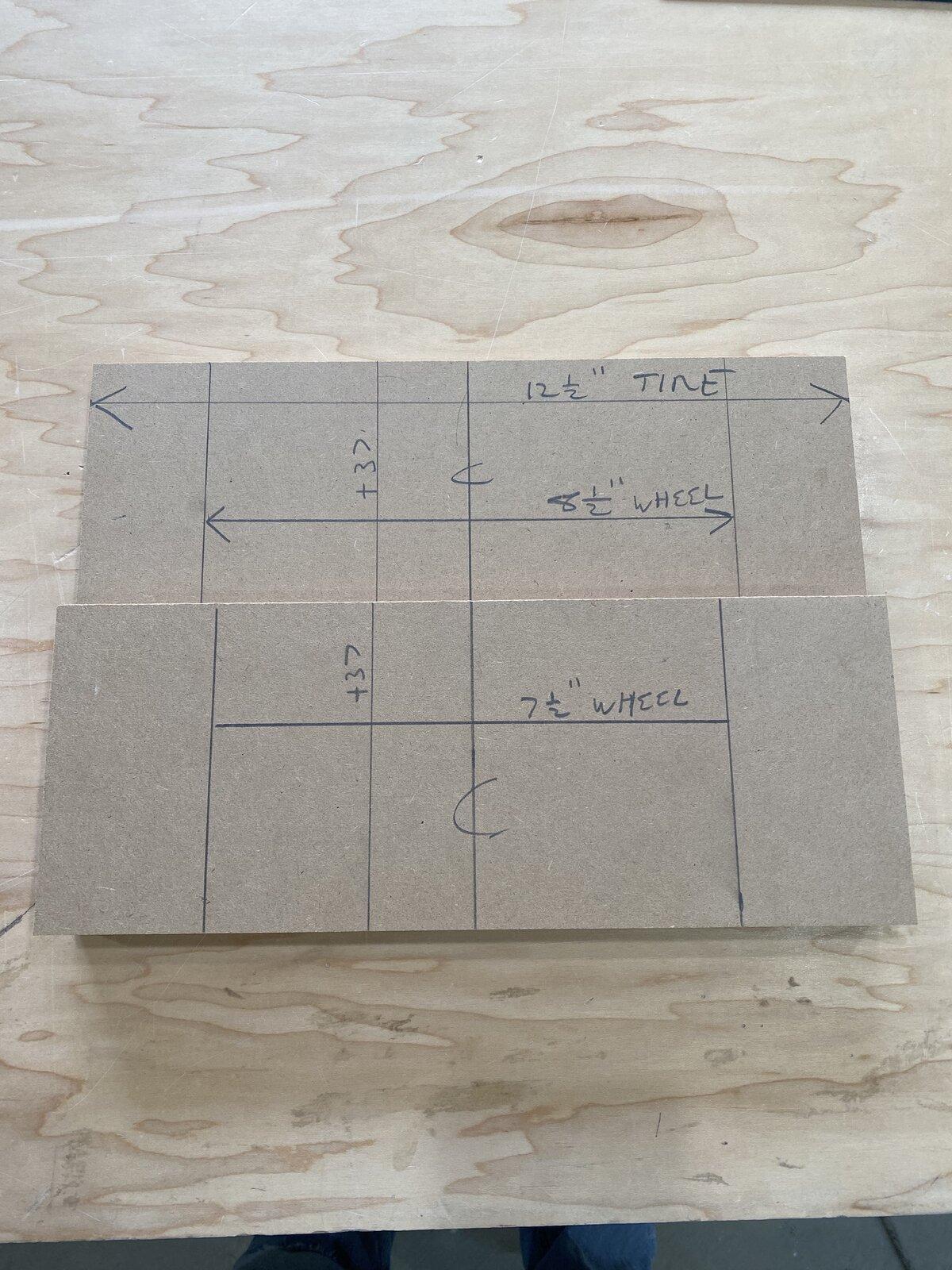

So tell me why, given 2 tires @ 12.5 inches wide, on 2 wheels with the same +37mm offset,
one wheel @ 7.5" wide and the other wheel @ 8.5" wide, the dimension of the tire to the inside of the Gladiator does not change? See attached pic and tell me what is wrong.
The only change is the backspacing, not the clearance of the tire to the control arms or shocks.
I would never tell you that... because it wouldn't be true.
If you increase your backspacing your tire will inevitably be closer to your control arms and shocks. Sure... it will be absolutely negligible and it will be the sidewall that's closer not the inside lugs (you will still have bulge in the sidewall with a 12.5" tire on an 8.5" rim)... but closing that gap is closing that gap. I'm telling you man... you're overthinking this. We're not slamming our Hondas and stretching tires to create clearance on our fenders. There's nothing wrong with that, to each their own, BUT... it's a completely different thought process when you're talking about lifted Jeeps that SHOULD be taken off pavement.
