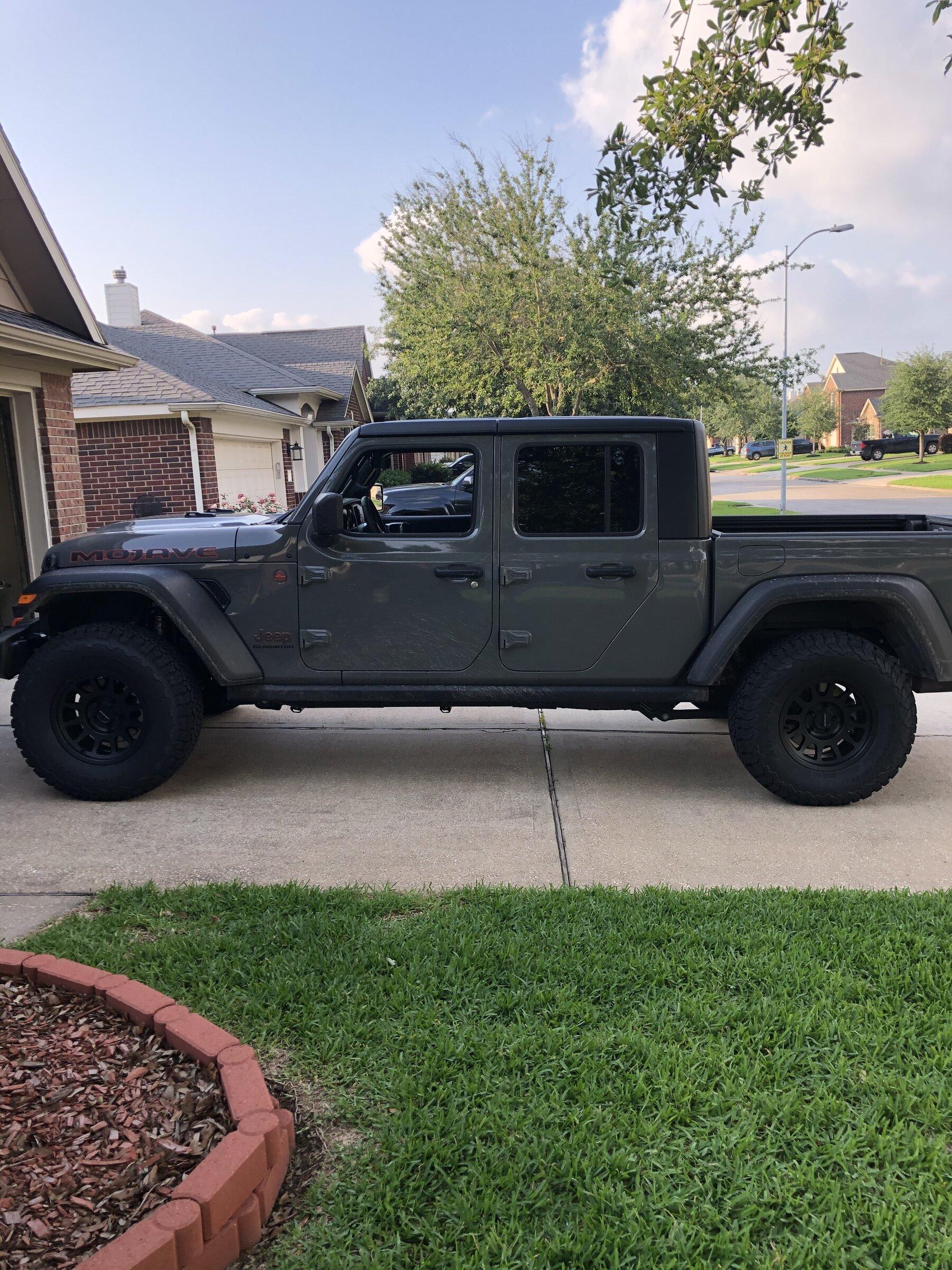

Yea my thread got a bit hi-jacked, but shit happens. I got one picture out of it. Maybe i can take all the money i'm saving by getting steel rims and drop it on some of those austrailian built fender flare extensions that fit mojaves and rubicons.

It’s a thought. I may get those even though it’s not required by law here. Picking up Mopar recon beadlock rims this weekend for my Mojave and gonna mount some 37” MT’s on them for DD and 35” AT’s on steel wheels for road trips

I know your looking for +6, but here is a zero offset 703 with 35x12.50 on a stock height Mojave, just for reference. Not too much poke.
I'd call that tasteful poke, but still file under the "looks great but not for me" file. Maybe it's time to bite the bullet on the Doubleblack Offroad flare extensions, cause the world of 0 offset wheels is much wider than +25s and it looks like they would cover 0 offset perfectly.
