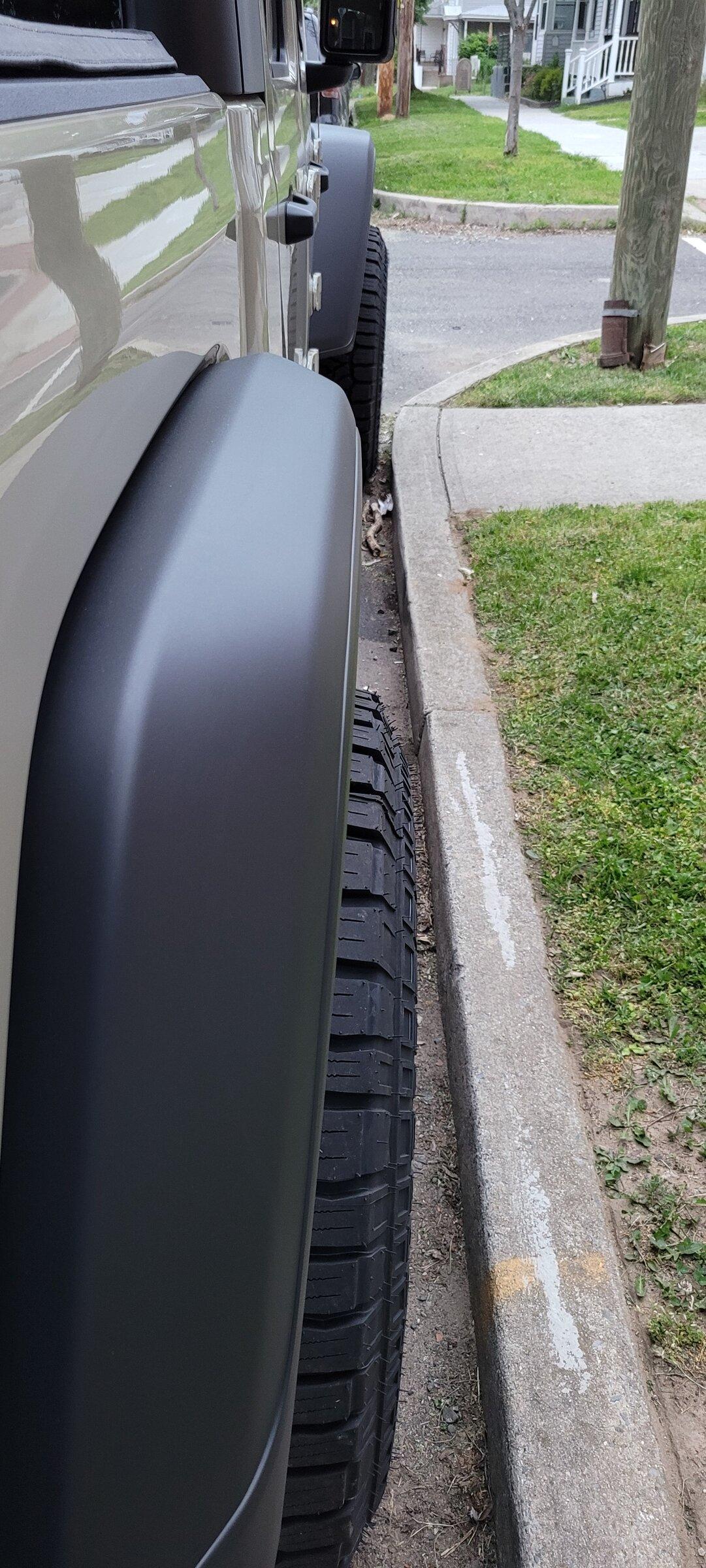

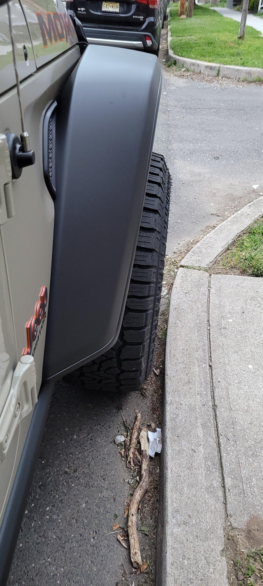

So I know I asked the question, but I hate when people who ask the question find out the answer elsewhere then slink away into the night without sharing for people who might find the thread later with the same question.
Jeep Gladiator Pics request: +6 offset with 12.50 tires on Mojave (no spacers) 20220526_200434
Jeep Gladiator Pics request: +6 offset with 12.50 tires on Mojave (no spacers) 20220526_200442
It's more poke than I'd prefer but it's definitely within my acceptable range. For wheels I paid $71 a piece for its hard to complain. If I was in the market for $300 rims I'd still get +25 offset

Looks pretty good to me, maybe slightly too much poke. Coming from a ‘17 Silverado with 33’s and a 2 inch spacer, I can say that I won’t be making the same mistake again whenever I get to pick up my Mojave.

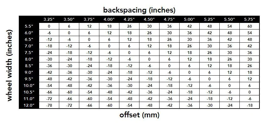

8", 8.5", 9" , 10" wide rims will have a different offsets to maintain the same backspacing. Wish people would say the rim width to when posting.
Here's a chart on offsets and backspacing.
I don't know why this confuses me so much. LOL
looks good and highly tolerable
so is this +6 wheel with 12.5 wide
