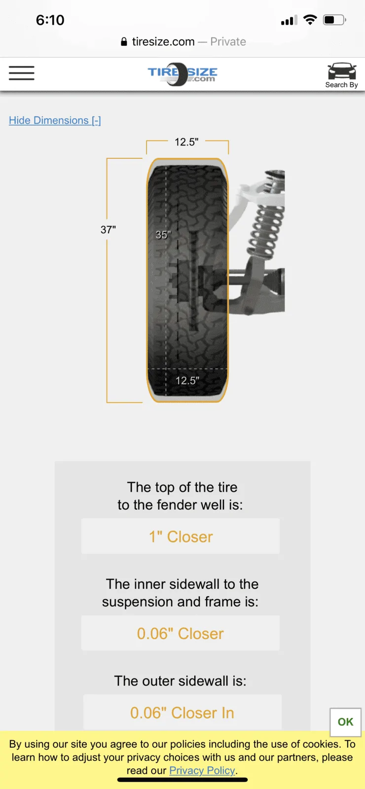

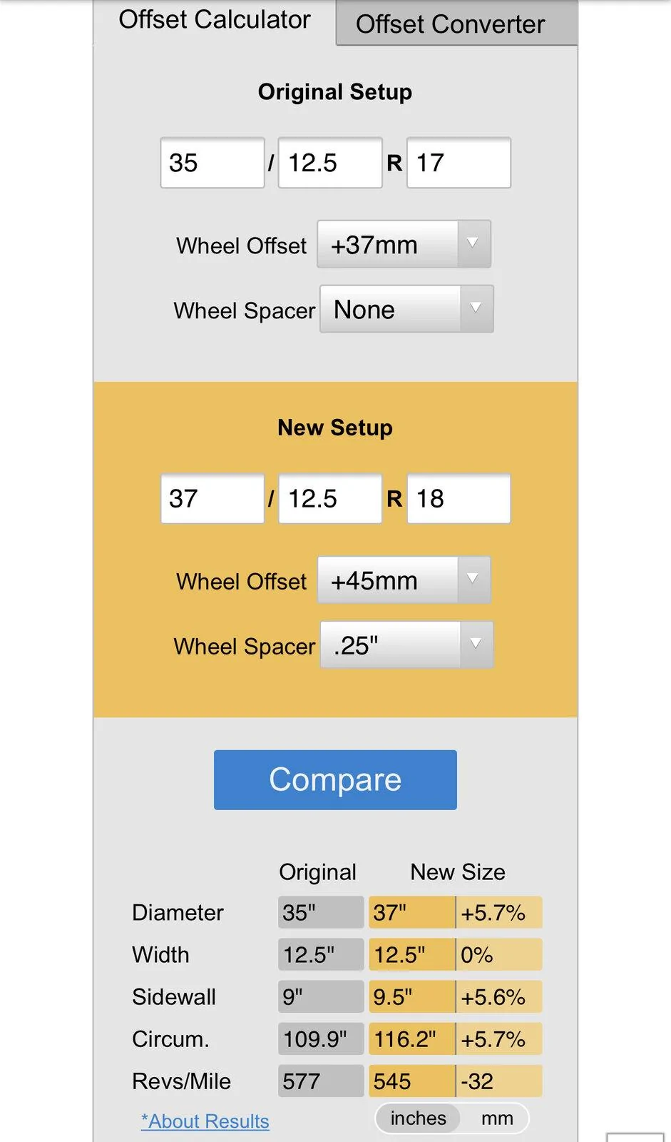

So this is what these calculators are telling me. I used a 37” diameter tire in the new wheel set up, for visual purposes only. Let me know what you think.

The 8.5 inch wheel you are looking at will be fine on your setup, the 37 might rub the LCA at full lock, but that’s an easy fix

Yes, that appears accurate. I just don’t like those style spacers in most cases.

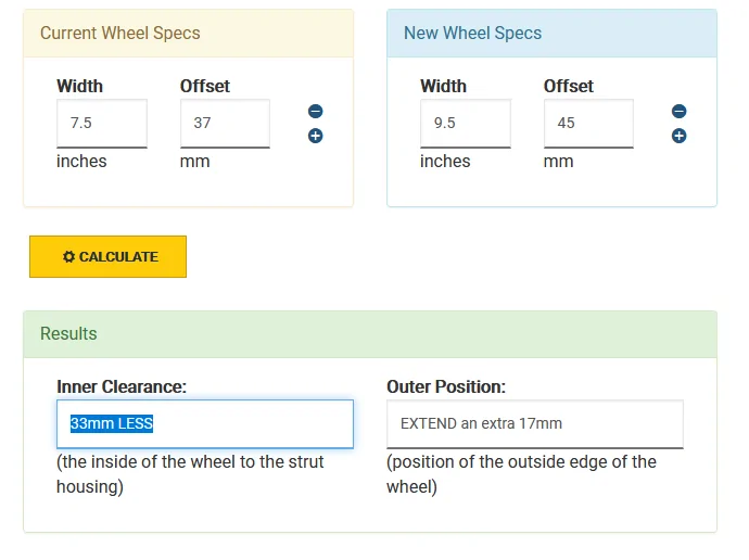

That calculator does not take wheel width into consideration. The 9.5" wheel is 1.25" closer to your lower shock mount and swaybar links. It will rub. The 8.5" wheel is good to go.

But how much closer is the tire. As the tire is always centered over the wheel, given the same tire width, the same offset, different wheel width would not change tire distance to suspension parts.
Tire section width will increase some with wheel width. About 1/4” on each side for every inch of overall wheel width increase.

Yes it does. Thats the piece with offset that the calculator you used doesn't take into consideration.
Offset is a measurement that doesn't take width into consideration. a 0 offset on a 7" wheel is a 3.5" backspace. a 0 offset on a 10" wheel is a 5" backspace.

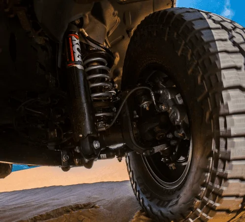

You can run a 35x12.50 r17 stock on a Rubicon. A Mojave is fine on a 35x12.50 on stock wheels because of the lesser backspace. A 37 will probably rub on the lower control arm. To fix that issue, you need to move the inside edge of the tire and wheel outboard. The shock body on the Mojave is what prompted the wheel change to it. A Stock 7.5 +44 got too close
