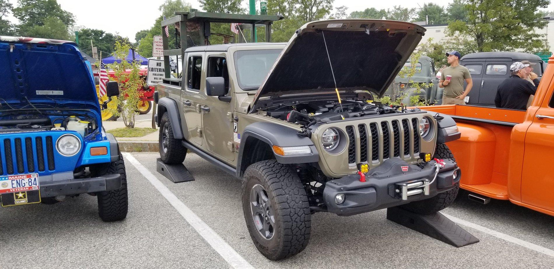

Fun local show at the NAPA

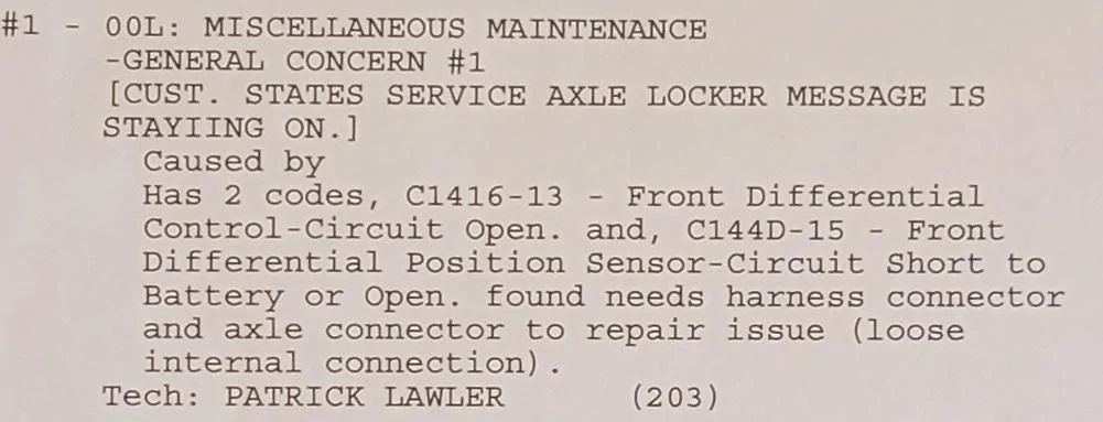

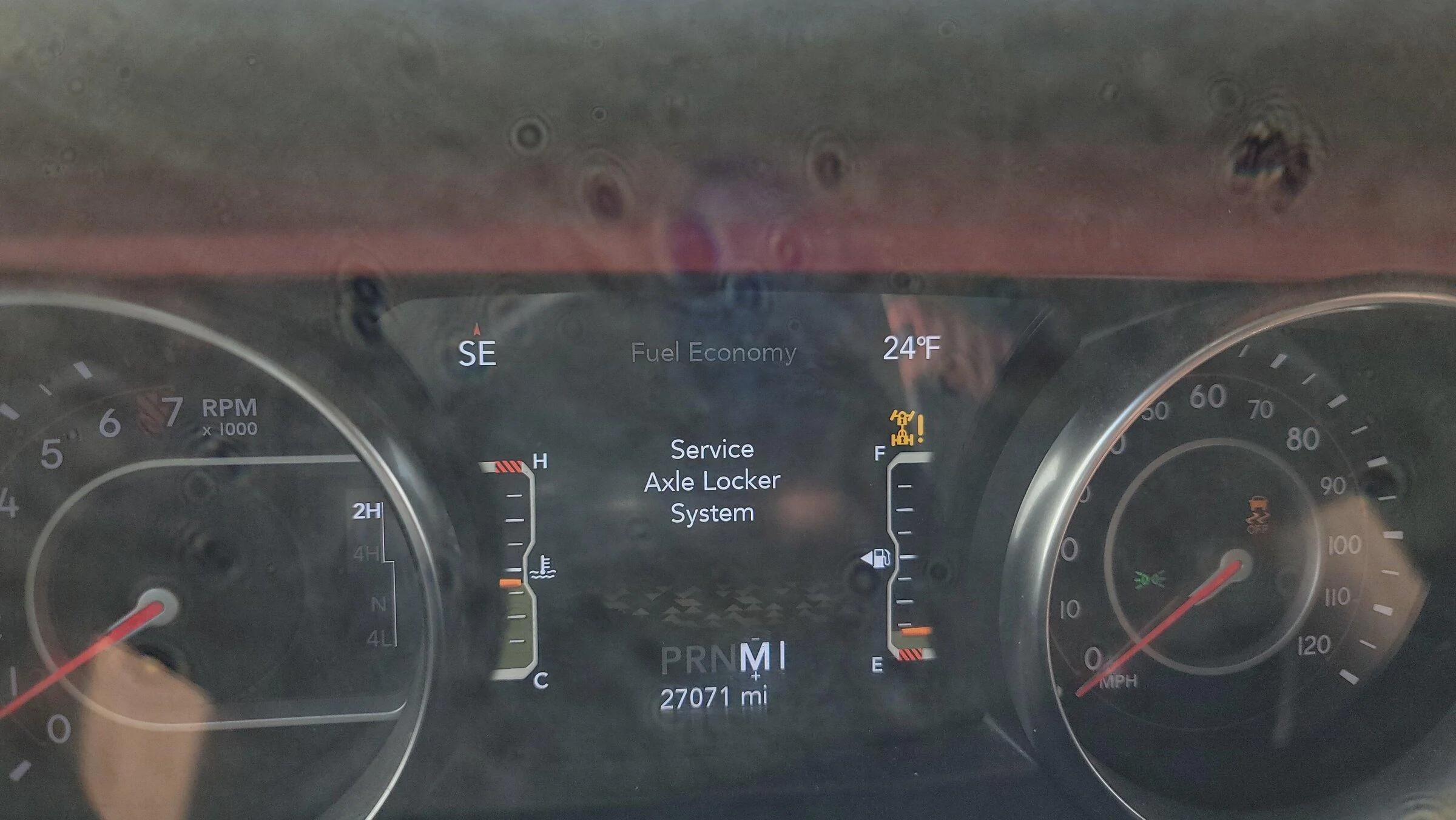

I've been getting the "Service Axle Locker" message occasionally. In the past week the message pops up every couple of minutes.
Jeep Gladiator EgulAye's mild hunting build (is it an overland build?) 20220329_105244
I brought the Jeep in to the dealership today and they report the following:
Jeep Gladiator EgulAye's mild hunting build (is it an overland build?) 20220329_112809cr
This sounds a lot like the issue referenced by this other thread, one of my codes is the same, the other obviously related:
https://www.jeepgladiatorforum.com/...ssue-repair-kit-fix-released-for-jt-jl.55502/
My dealership didn't tell me which two wiring harnesses they planned to replace, but I was told it would take a week or so for the parts to arrive.

Update of the "service axle locker system" error message:
I brought the jeep back to the dealership to have the repairs completed. The two codes they recorded were:
  • C1416-13 - Front Differential Control-Circuit Open
  • C144D-15 - Front Differential Position Sensor-Circuit Short to Battery or Open
  • "found needs harness connector and axle connector to repair issue (loose internal connection)."
Today they installed two parts:
  • 68400411AA :ACTUATOR: NONE - 684 - QTY 1
  • 68500924AA :WIRING: 4 WAY - 685 - QTY 1
I also expressed my concern about the transmission shifting issues: high rev's, delayed shifting, not shifting to a higher gear at cruising speed...
There are no trouble codes for this issue, but the service tech advised me that there was an updated flash for the transmission controller. I agreed to have the update flashed to the module (my truck doesn't exhibit the symptom described in the TSB, but having the newest flash seemed like a good first step):

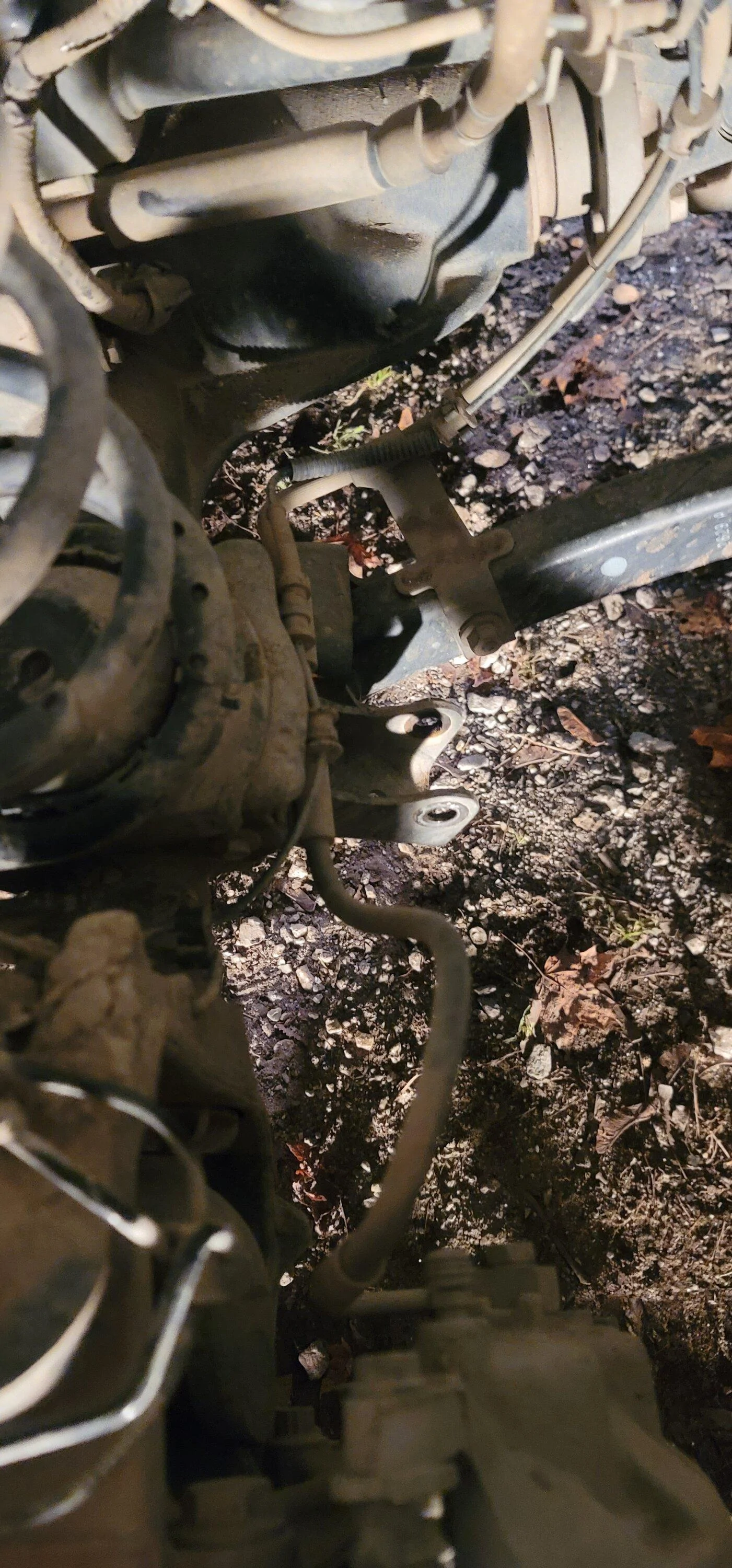

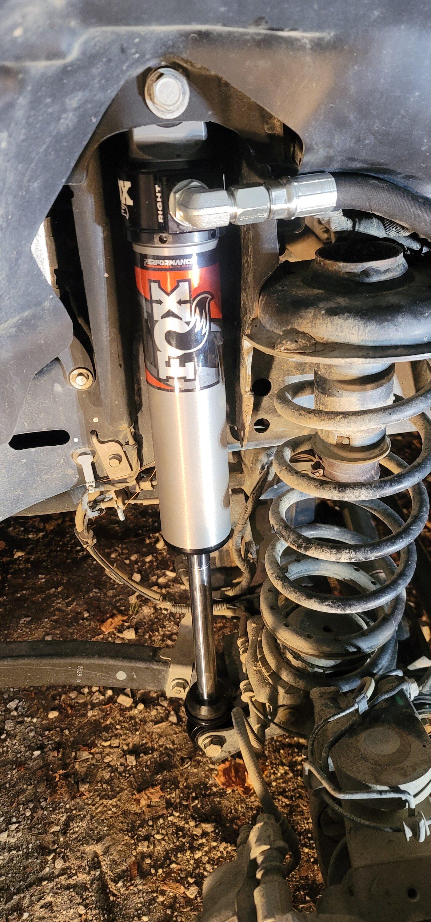

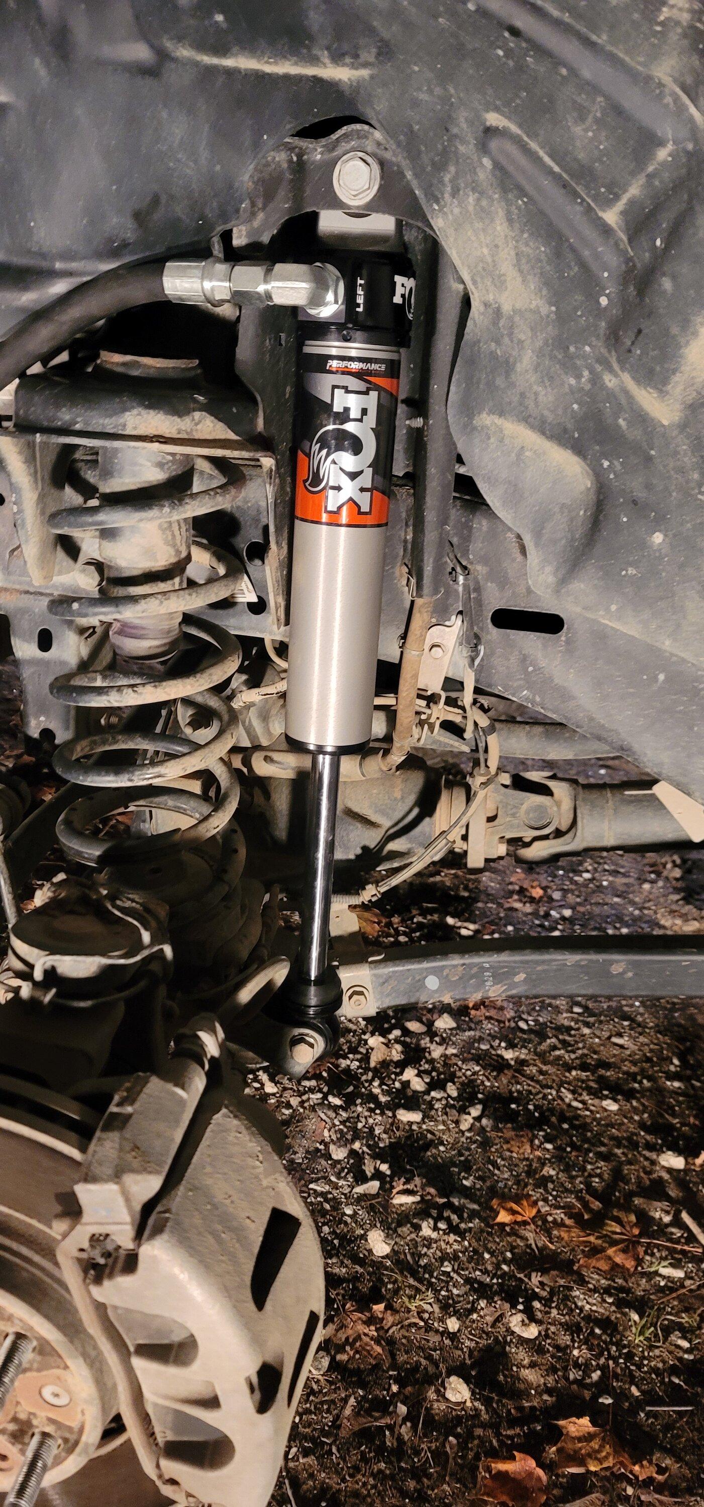

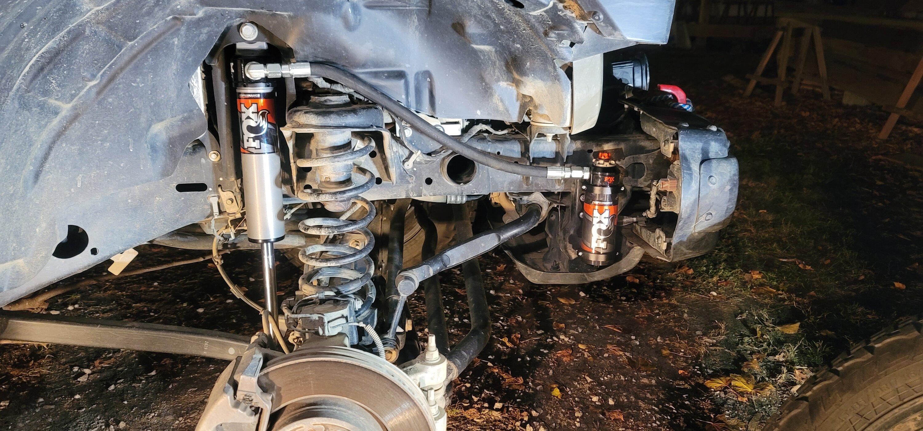

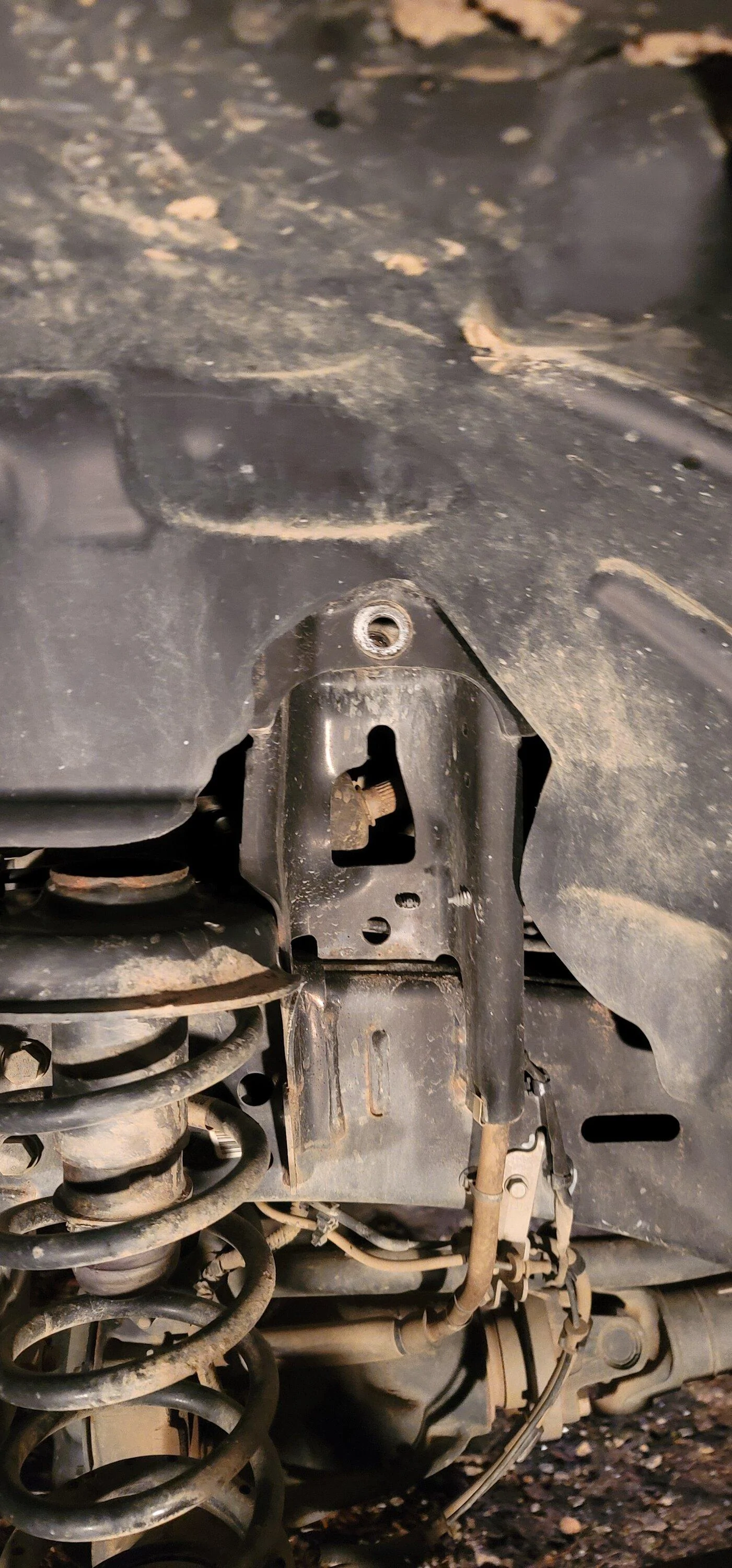

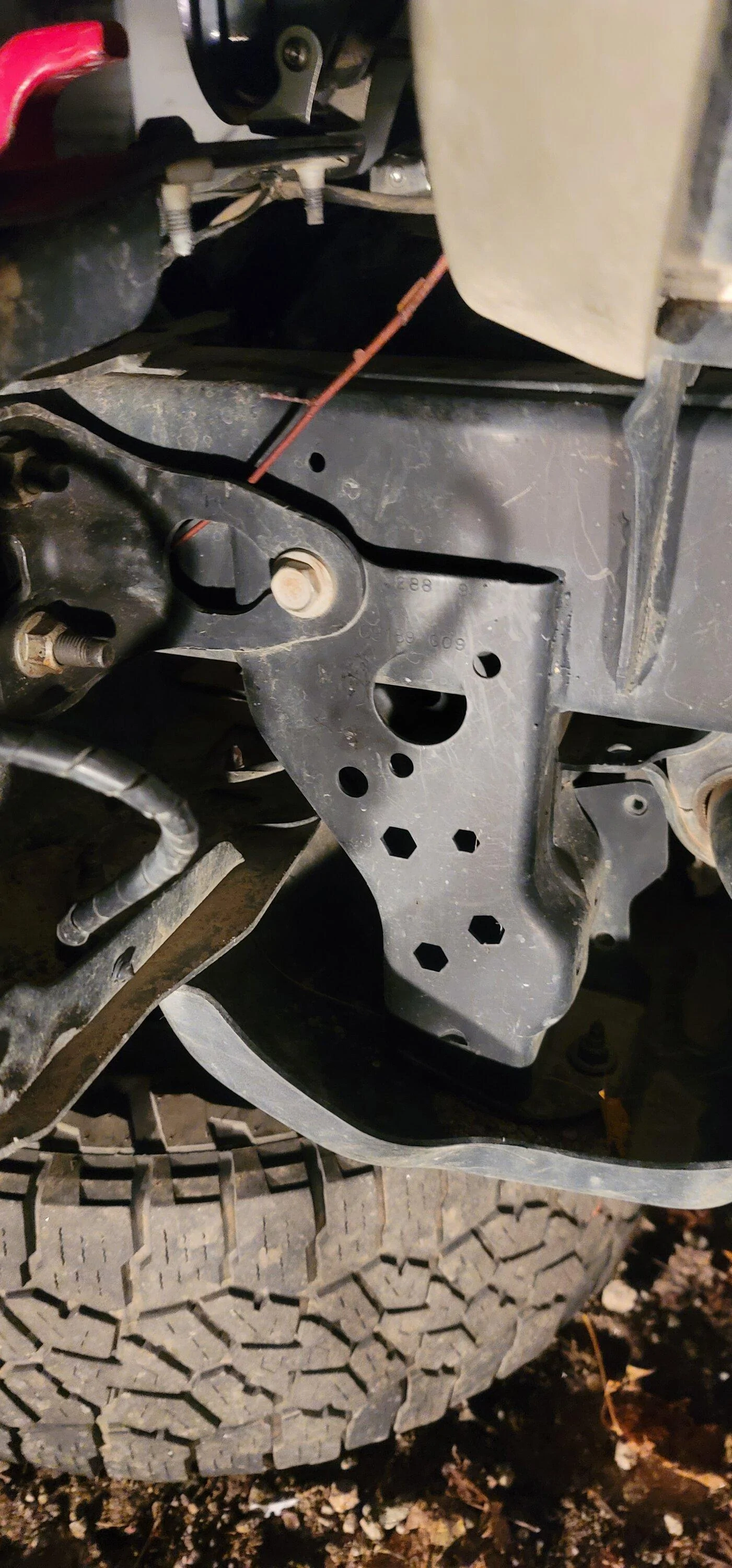

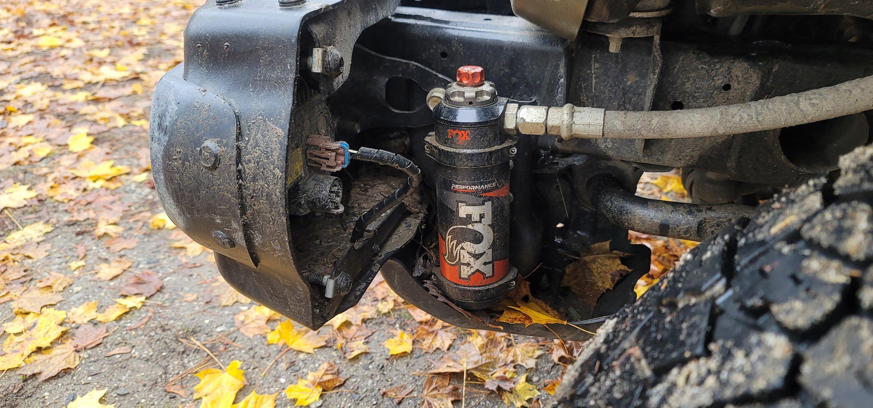

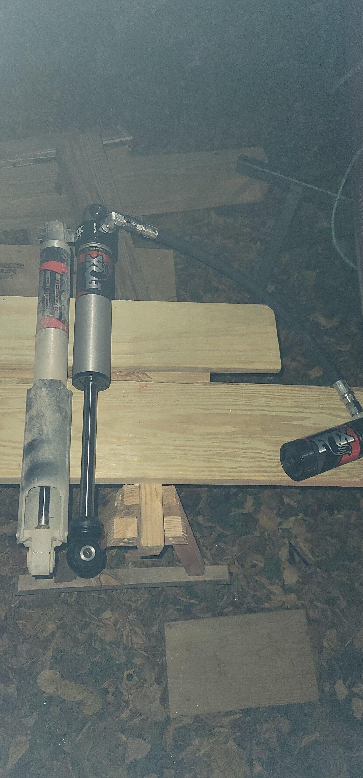

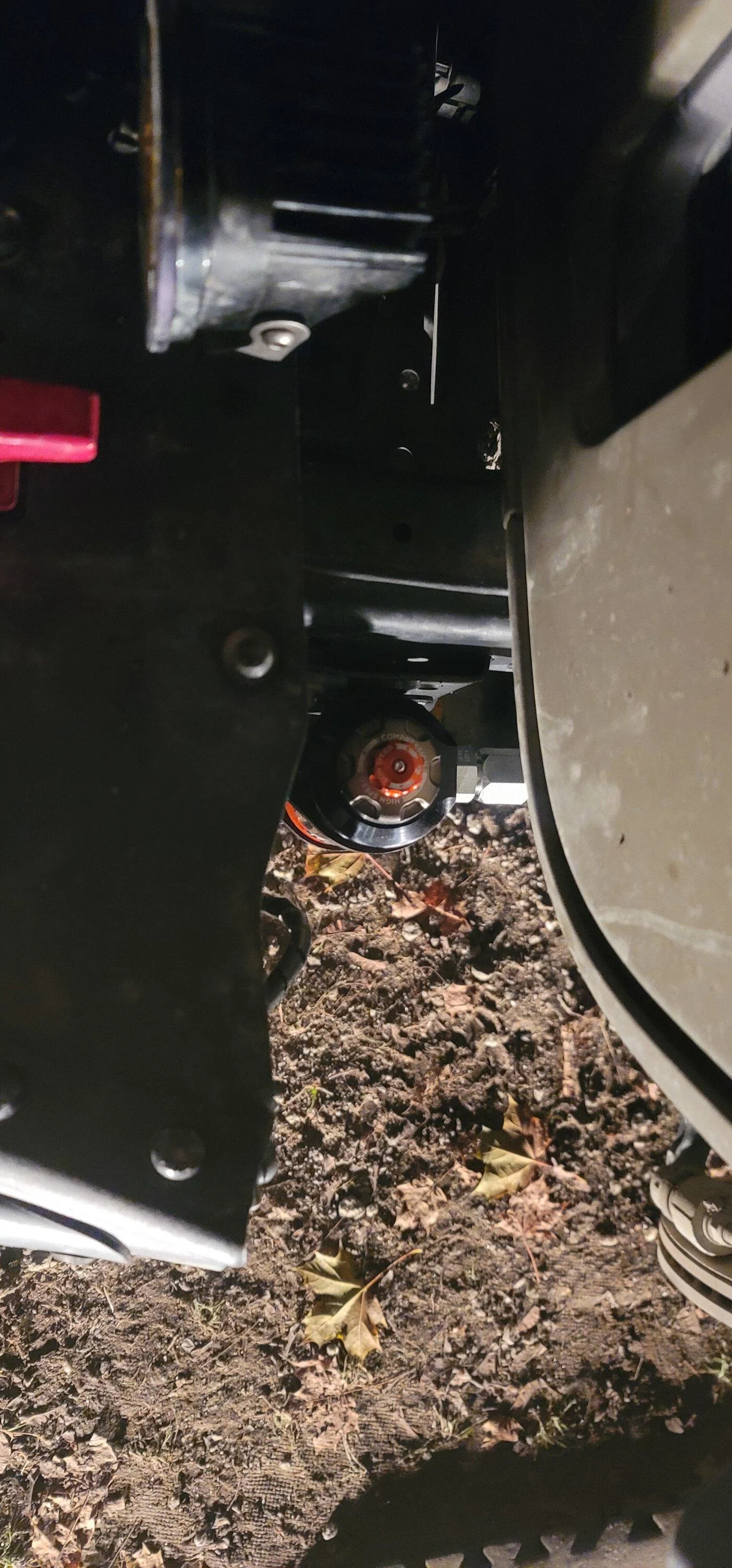

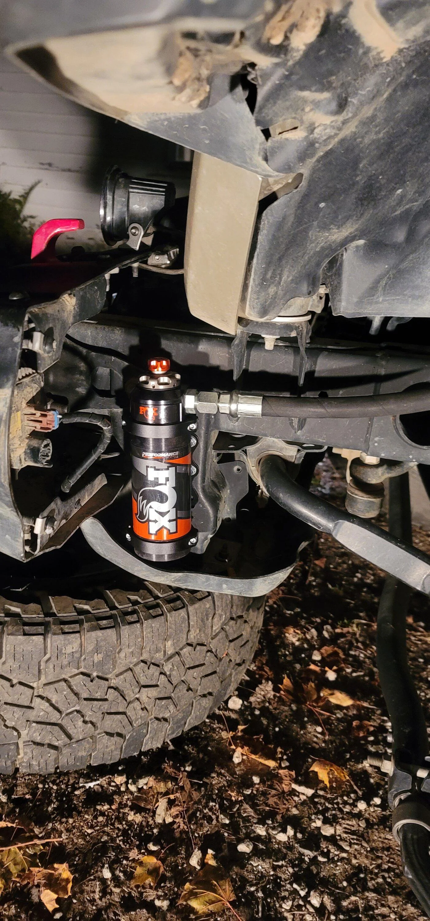

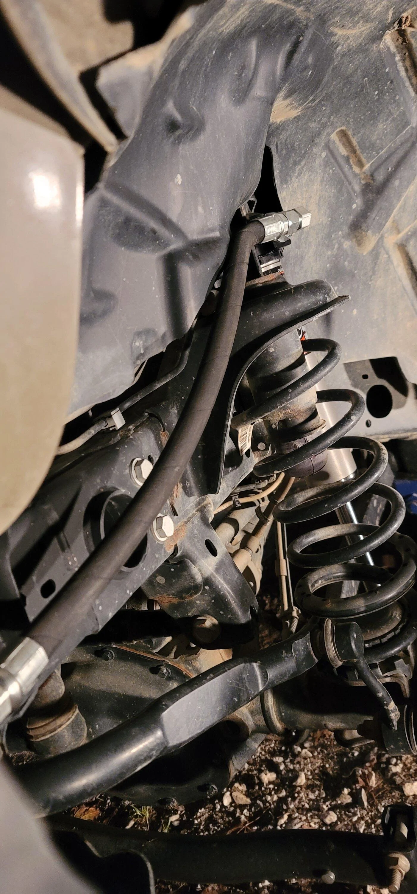

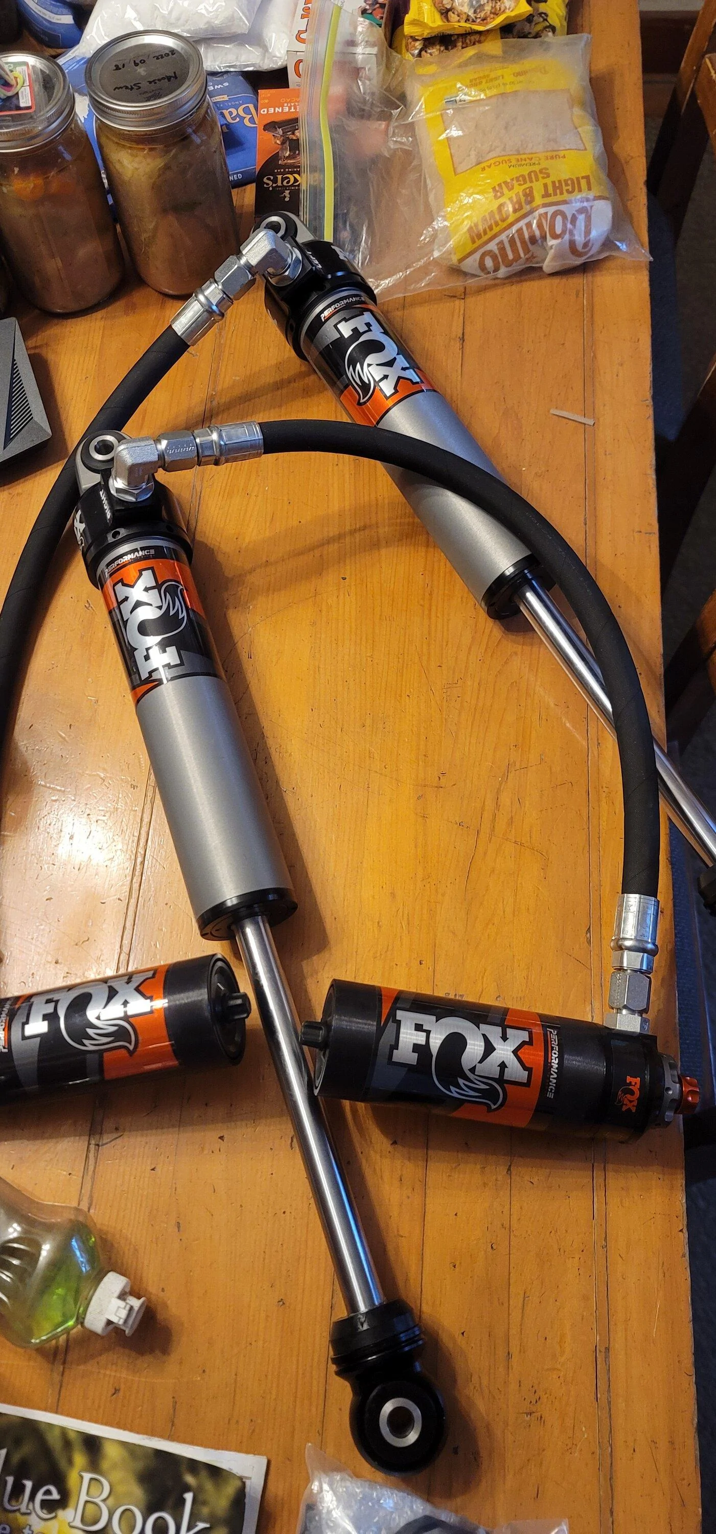

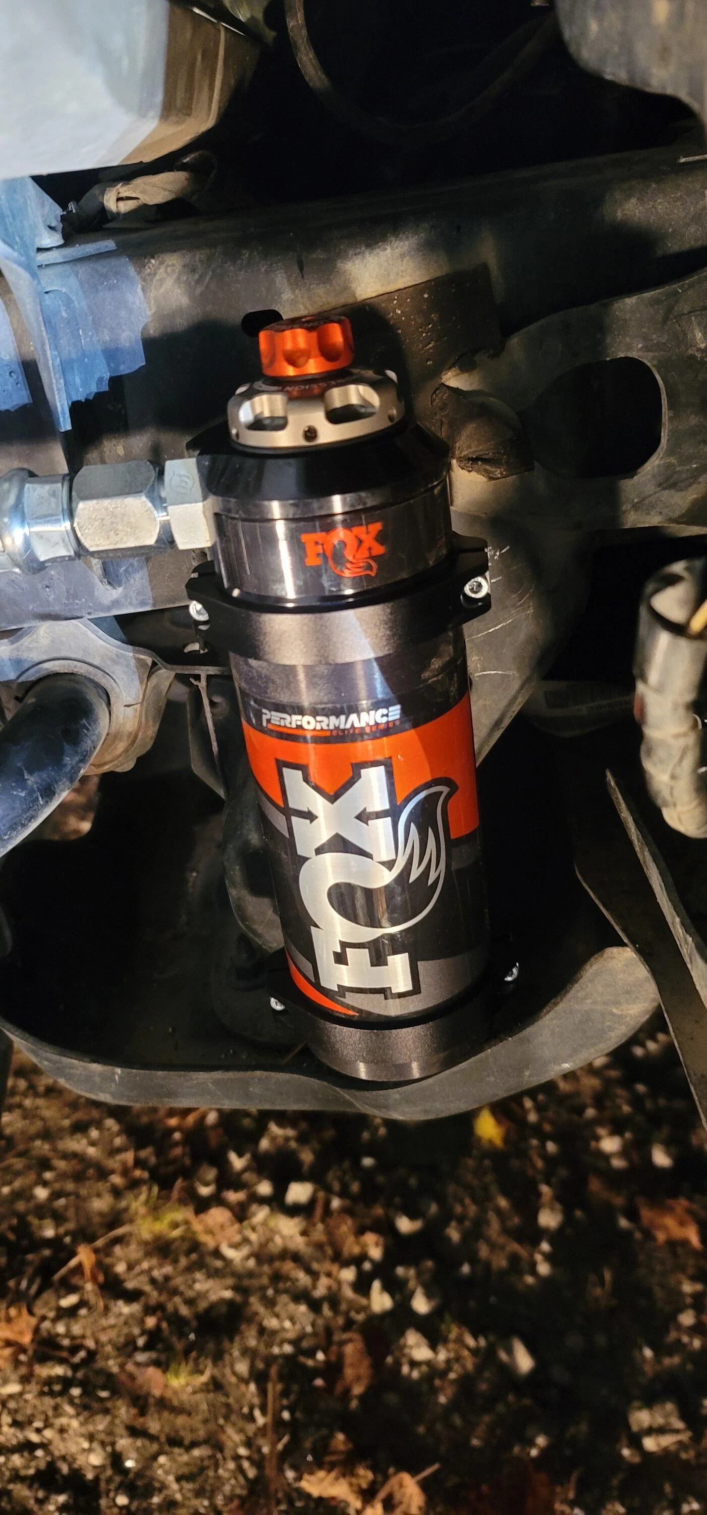

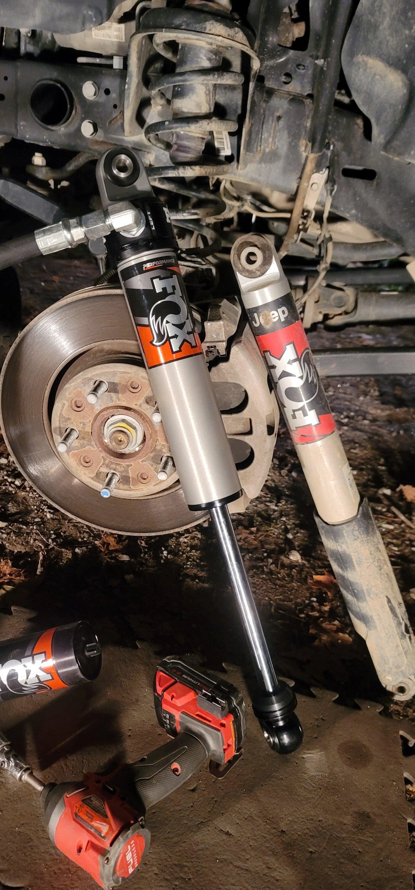

Replaced the front shocks with Fox Racing Shox version 2.5 w/ the 0-1,5" lift version. The install was super easy, reusing the mounting hardware from the factory shocks. Top and bottom used an 18mm socket & wrench. The top bolt has a retained nut on the back side, so you don't have to get a wrench back there. The bottom needs a wrench on the back side to hold the nut. I was able to use my small impact driver for most of the work. The remote reservoir was easy to mount.
I'll get the Jeep out in some rough terrain next weekend and we'll see what difference it makes.
The new shocks are much larger than the originals, these are noticeably heftier/beefier.

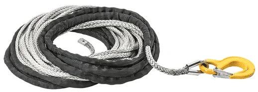

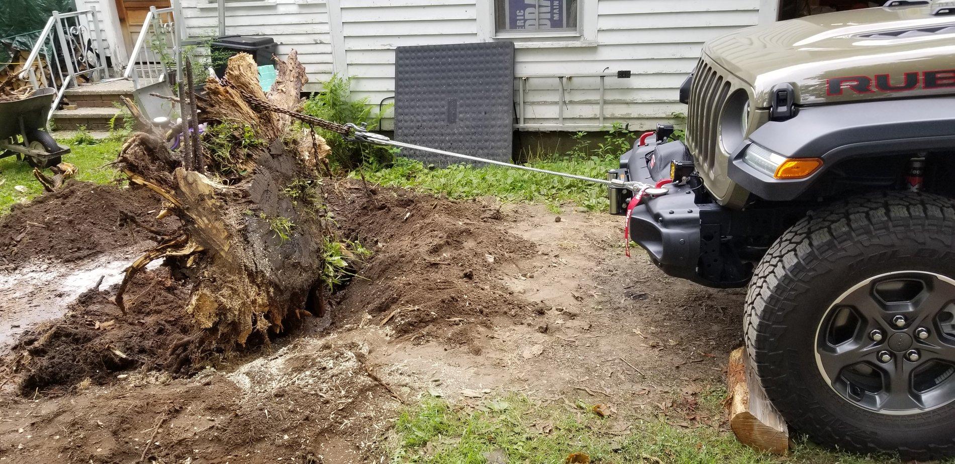

I also replaced the steel winch rope with a synthetic line. I got a Q-Series Dyneema Line from Quadratec. I don't have any photos of the install but the included hook was the first modification I made, cutting it off.

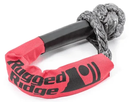

I also picked up a Warn fairlead and a new Rugged Ridge soft shackle.

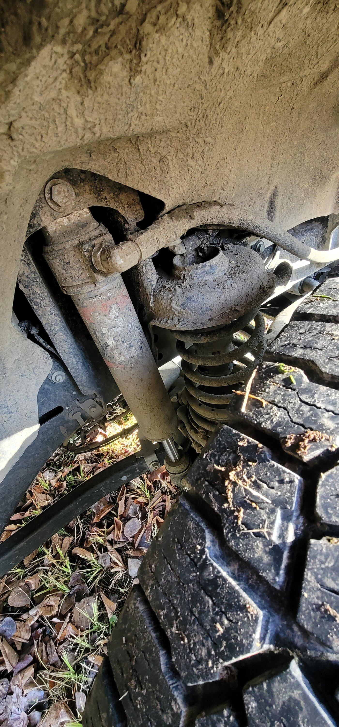

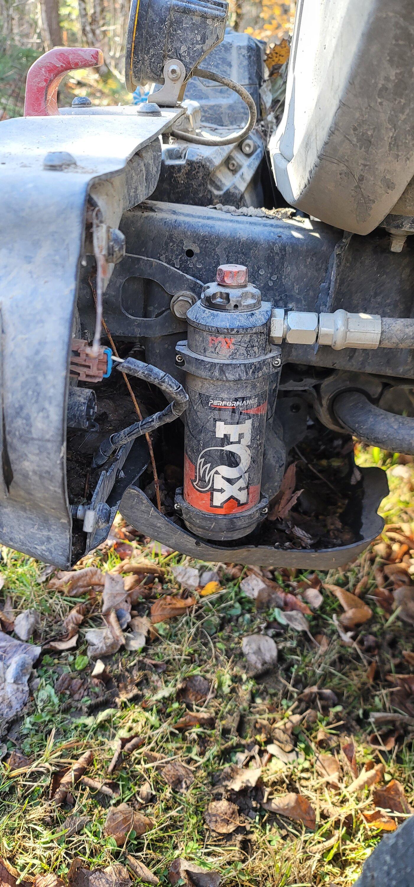

The Fox Racing Shox performed amazingly well. For the type of driving and off-roading that I do these performed exactly as I had hoped. No harsh rebounds or suspension bottoming out, comfortable ride at all speeds, and the on-road and highway handling is as good as original.

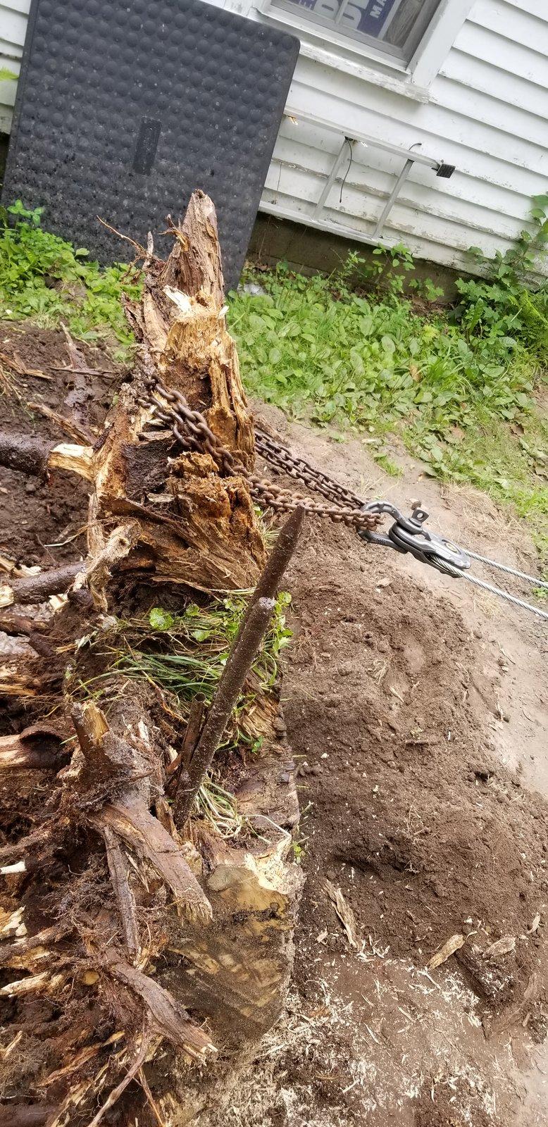

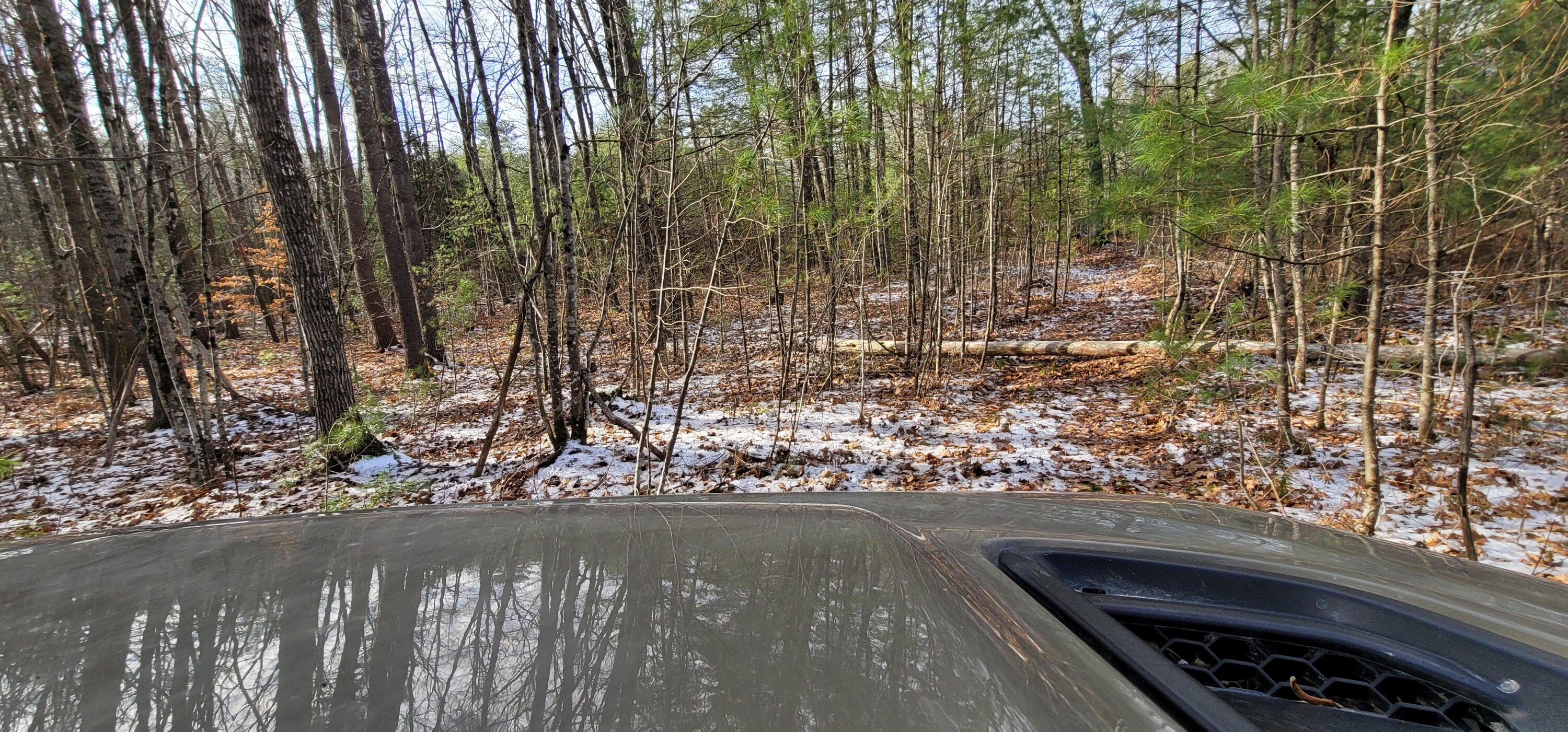

I had a chance to use the new winch line today. There was a dead tree across a trail I like to ride on occasion. The new winch line worked very well and was easier to handle than the old steel line. Moving a rotted tree isn't like pulling a heavy truck out of the muck but the motions are the same.
