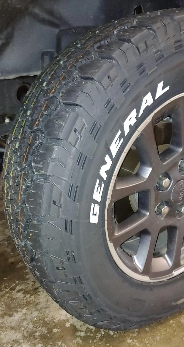

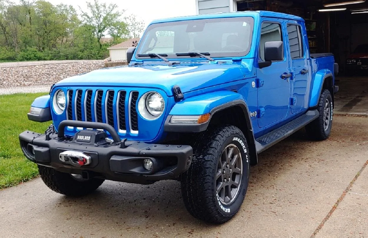

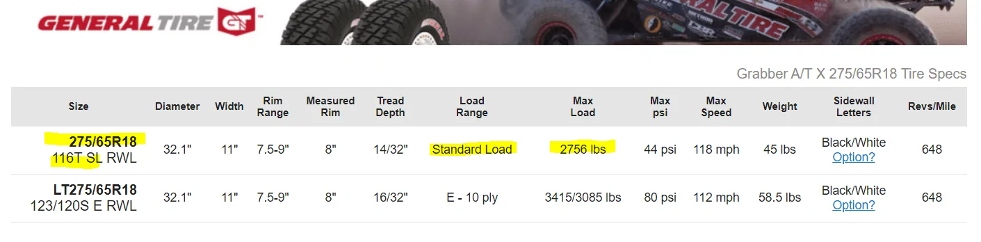

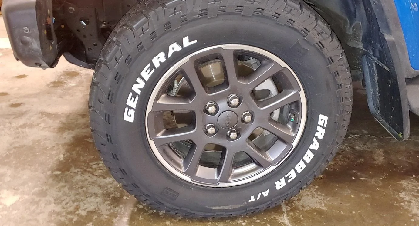

After reading hours worth of reviews and watching videos,
I went with General Grabber A/TX in 275/65R18 size.
More aggressive tread, the size is wider than the stock Overland tires, but not quite as wide as the Rubicon Falken tires.
The Rubicon Falken "take-offs" are 32.7 diameter and about 11.2" wide.
Stock Overland Bridgestone Dueler tires are 32.1" in diameter and 10.2"
The size General Grabber I went with is 32.1 diameter and 10.8" wide (or 11" wide by some tire sites, measurements vary depending on where you look!)
So they are the same size diameter as the Overland stock tires and .8" wider.
They also have a rim protector lip on the sidewall - the rim sits recessed into the sidewall a bit.
