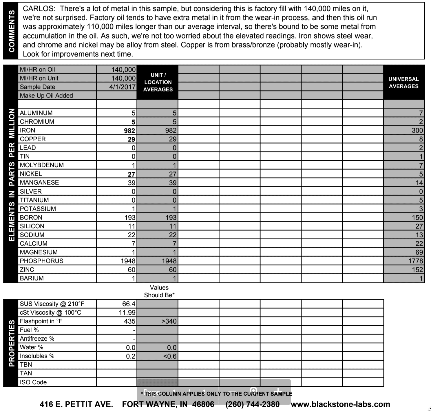

A couple years ago, I found out that my neighbor had NO IDEA that you should change diff oil at all, ever. He had just over 140k on his truck at that time, bought new. Never changed the oil. No issues, no noise. I suggested we send the oil in for analysis both for fun, and to learn about potential upcoming issues with it. The result is kind of shockingly "bad but not a big deal."
