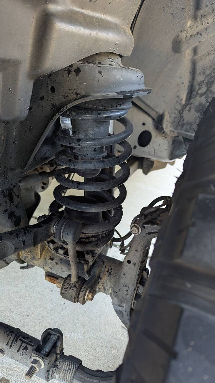

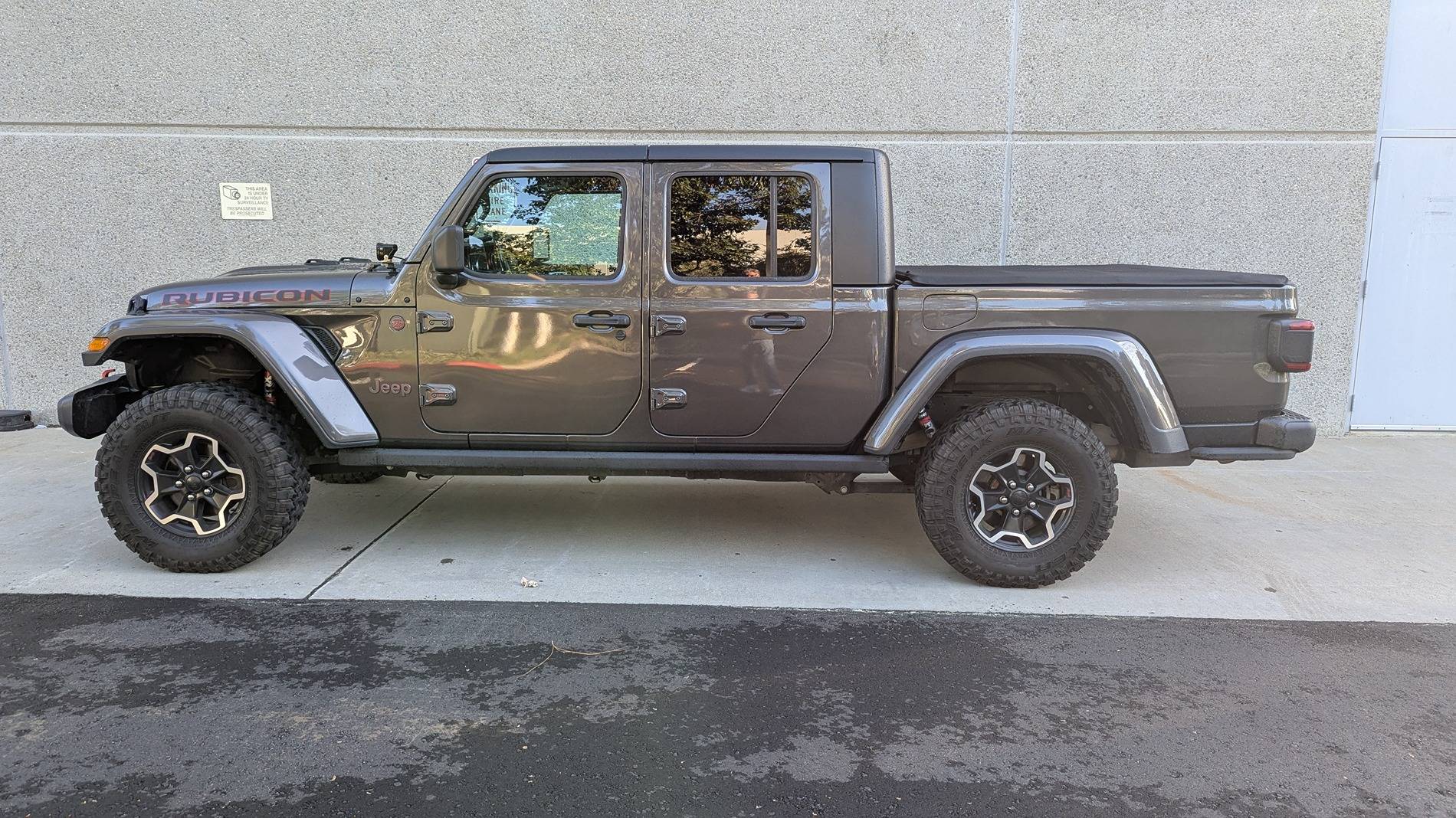

I realize the fenders are probably not level with each other but the front fender was 41.5" high and the rear was 41.25" high. I didn't verify the air pressure of the tires. Here is a couple of pictures.
Jeep Gladiator EVO-3152EXT 2.5" lift questions PXL_20250306_152908282
Jeep Gladiator EVO-3152EXT 2.5" lift questions PXL_20250306_152857505

You have coil spacers in the front as @Sikjeep2 said.
You could use those coil spacers again if you install a lift and you think the front ends up being too low.
